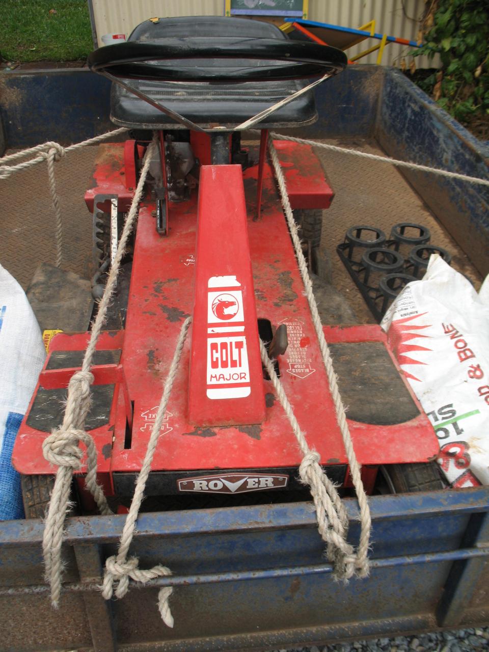

OOHHH look what I found.... grin

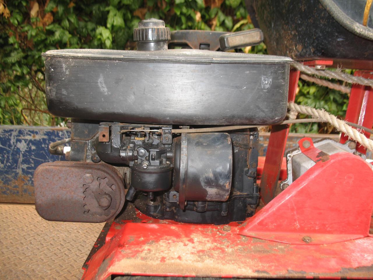

It has no spark and an oil leak. I think the coil is U/S as the points seemed to be like new...to investigate further and will post on another forum thread like engines? Mods please advise...I will chase up parts etc. from there as well I think. Eng# TVM140 70370K SER 12660
[img:gal:39374fcc3b9349773]https://www.outdoorking-forum.com.au/forum/uploads/usergals/2012/06/full-3937-6725-
img_0001.jpg[/img]
I was hoping it had a briggs on it, frown but no such luck...the mice had nested under the air cowling too. Pumped the tyres up and wheeled her out of a shearing shed....Might use it to keep the new clay target area clear of grass for easy pick up of rubbish.. smile

party It lives!!!! Swapped over a coil, then a condenser, then still no spark!!! finally swapped the lot and put the points in a old Kirby 2 stroke phelon unit and wahla it lives! No blue smoke, and left wheelie marks on the concrete! but the carb needs a kit as it left a stain of fuel on the shed floor overnight. It should be a good rebuild prospect! woot
