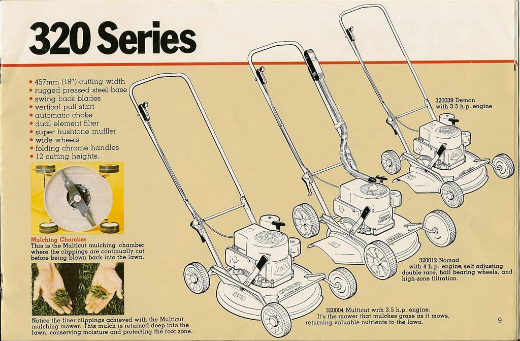

Hi Dave, the colours for the SB 320 Demon, B&S 3.5HP and is model number 320039, is the same colour for all the 1978 model line-up which is the same hammertone olive green colour that, unfortunately, the formula no longer exists. cry
However, quite a few members have been using White Knight "Alpine Green" hammertone finish which is lighter in colour, but is available from Bunnings etc. in a spray can and apparently works well....(see some of the latest SB45 restorations.) Here is the 320, top right in the drawing.

Hi again Dave, have a look you will see the SB decal on the front of the Briggs in the centre.
The wheels are all the same size. wink
Here's a pic in colour, see the decal? Yours is 3rd from the left front. grin

Hey Dave your right, my mistake, yours is in the middle, with no snorkel...and small wheels, different hubcaps.
Need to get mt eyes checked! lol

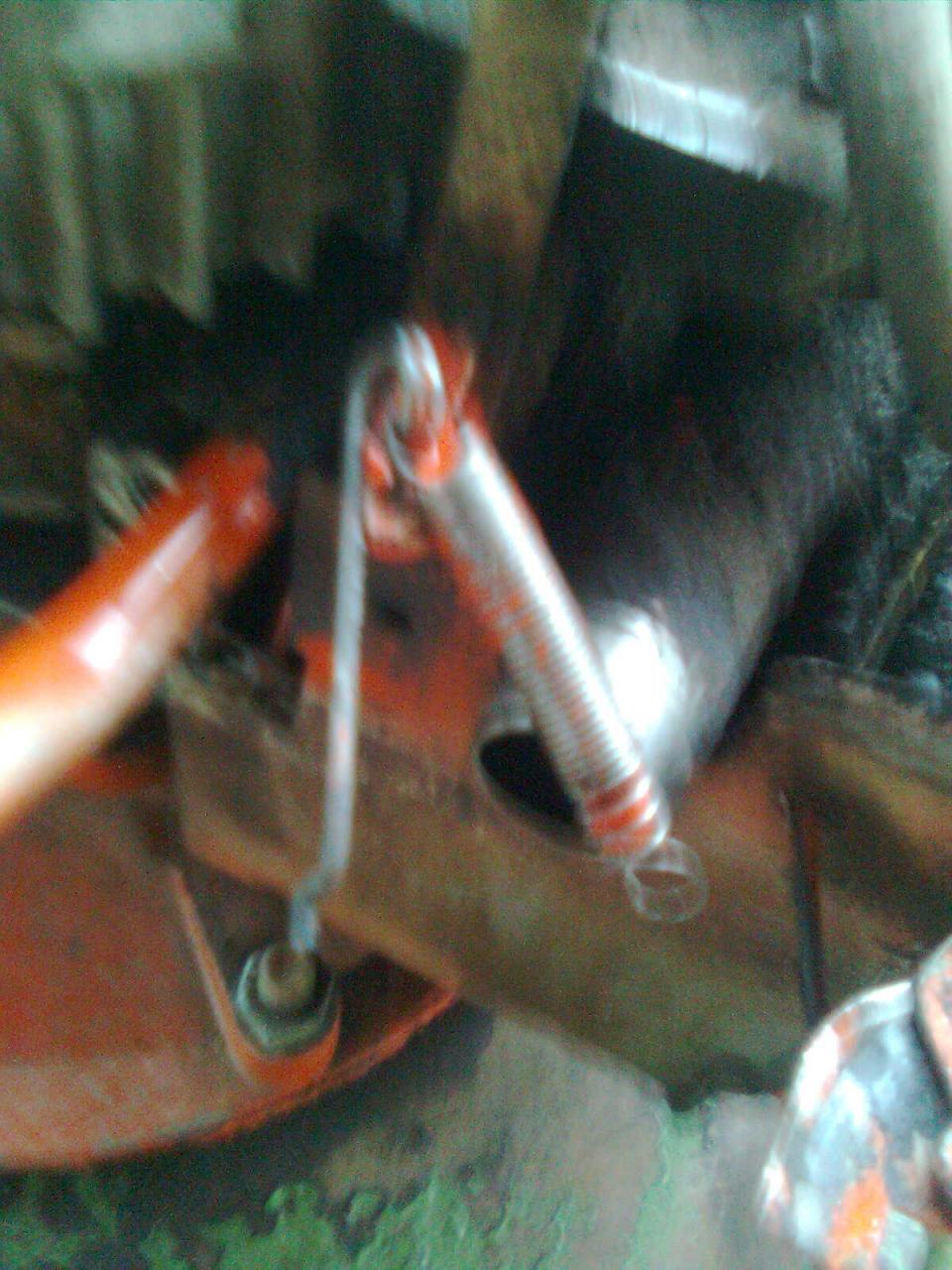

As I have never actually seen one, I can't comment on the washer/spacer etc.....Can you see it in the pic?
no you cant see it in the pics , its on the deck under engine looks like a factory spacer welded to the base now ive stripped it i can see better !! found the last 2 cans of alpine green in s.a i think but its a tad light , sort of like an old victa consul light green looks good though

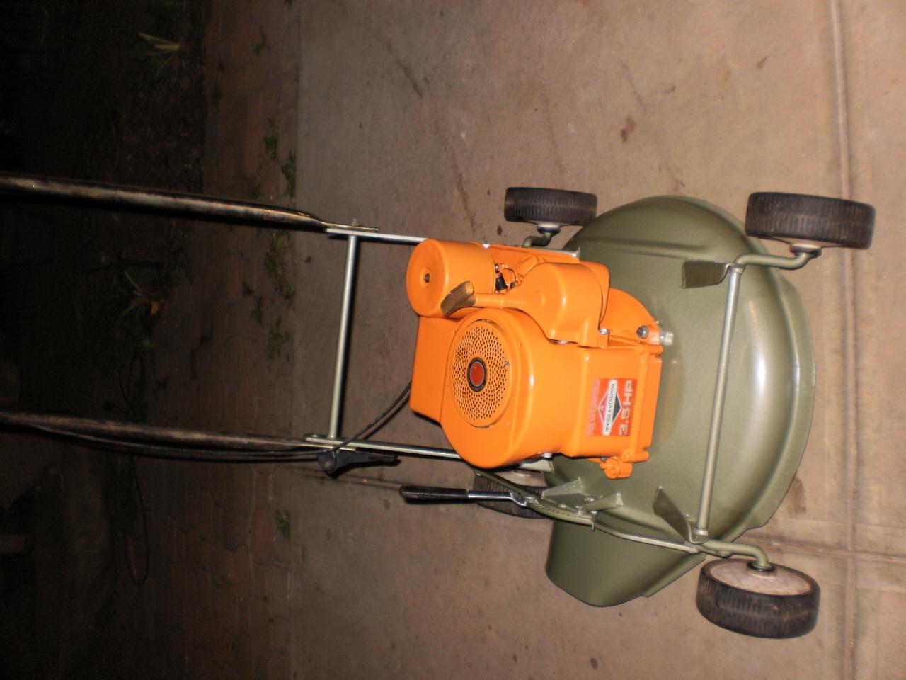

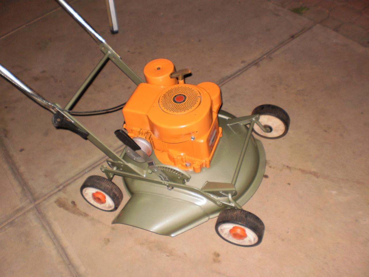

i hope ! heres a few pic's , sorry its already stripped down some painted so you can see the match on the piant , a tad too light but its ok lol [Linked Image]
Hi Dave, thanks for posting the 'before' pics mate, this will be good for the SB rotary archives. wink

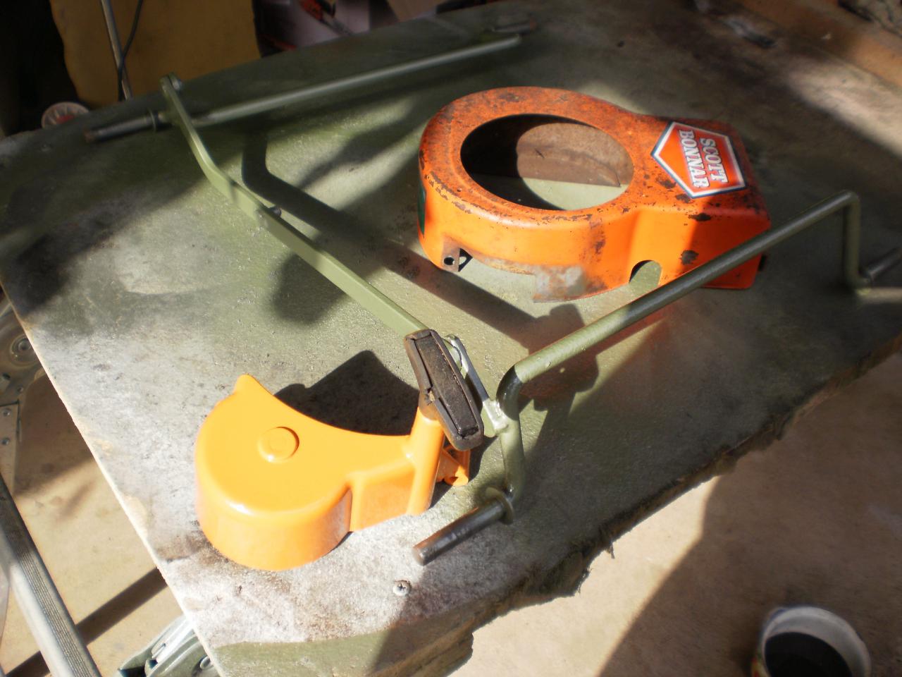

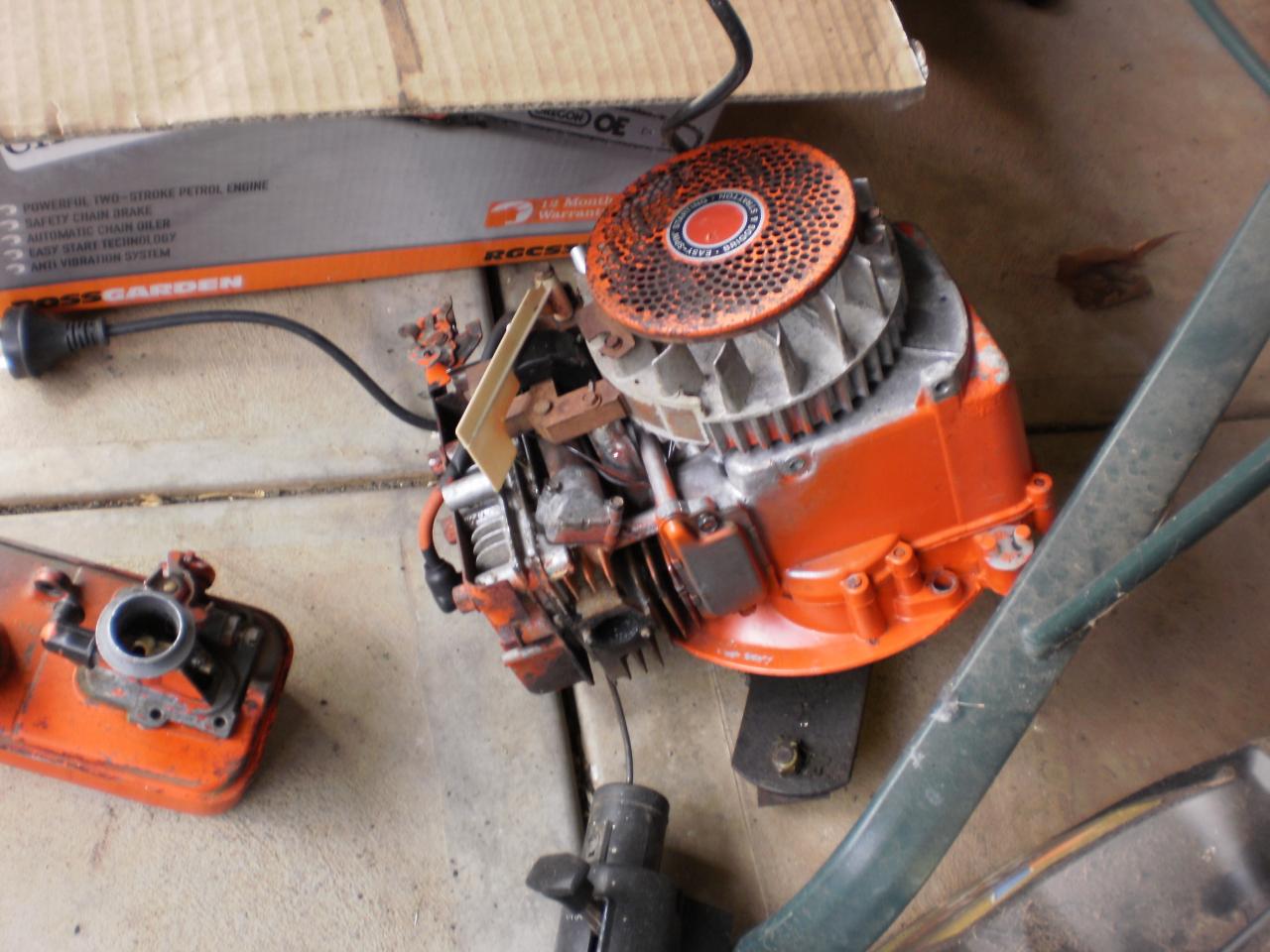

i do have some before pic's but there in my fone . and i cant get them on here banghead i havto ask one of the kids to help haha see if they can do it ...... ok here we go again ! [Linked Image]
might end up with a round muffler as the bolts snapped of flush ! and i think they look better on older machines ? but maybe thats just me rolleyes as i dont have any way to remove busted studs as yet

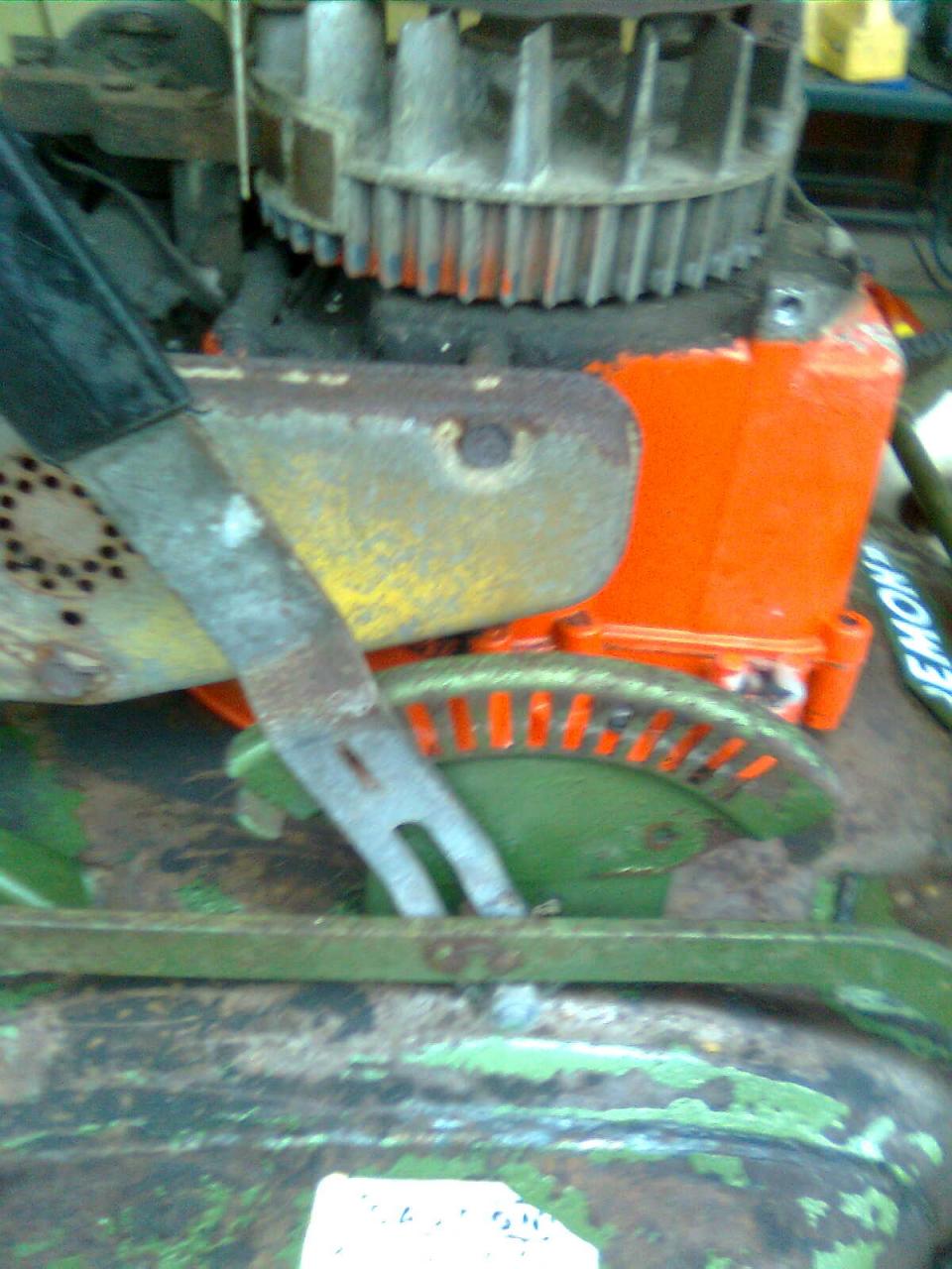

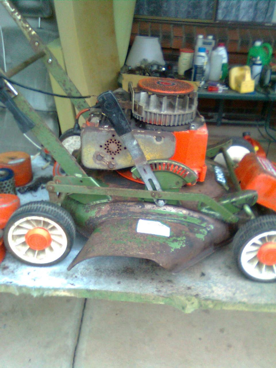

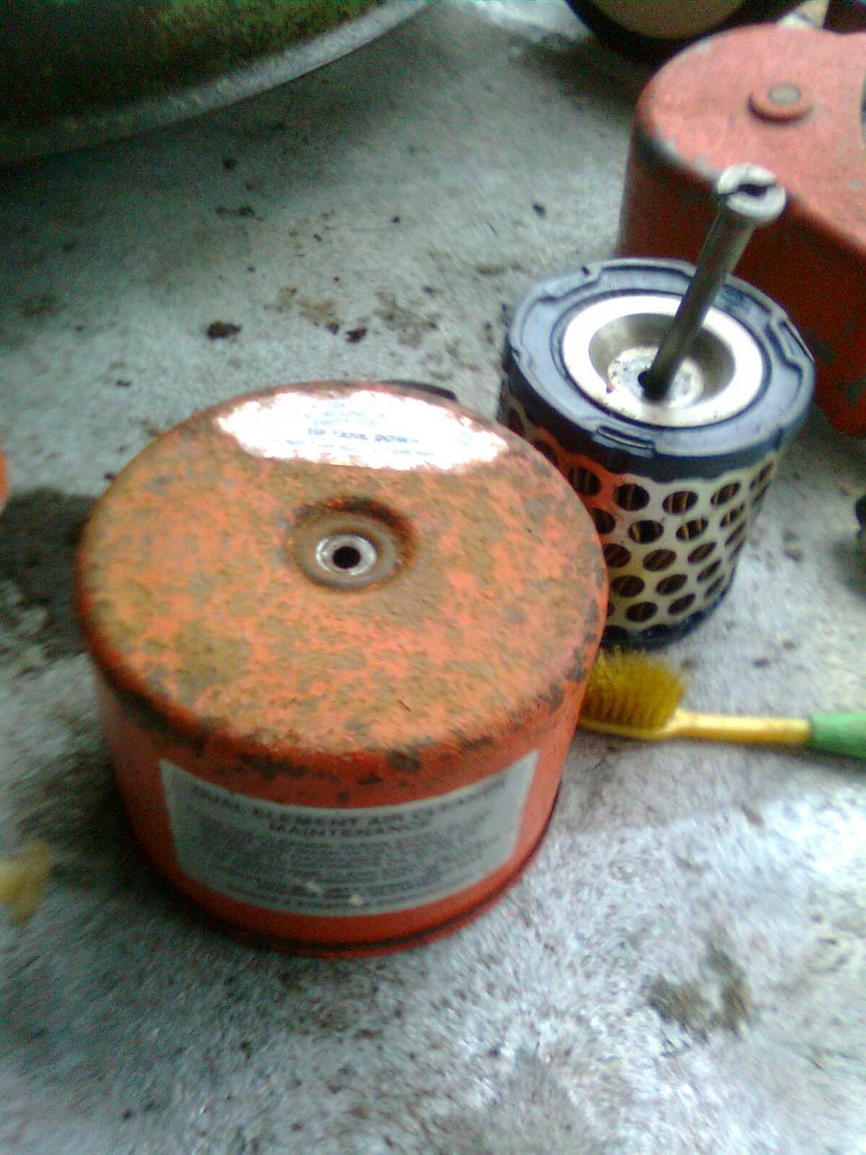

heres a few more on this jigger , i know the colours arent correct but its the best i could find blush .. needs a few more things , wheel clips stickers and work out how to get out the broken muffler studs ! but allgood [Linked Image]
just need to get new a handle for it ? badly rusted , so pitted i dont think it can be rechromed .
Dave
Looking good Dave, congrats thus far.... I can't help with advice on the handle...you may care to speak to someone at an electroplaters...there may be a repair schedule that you could use before they re-chrome... there may be a way they can fix it for you....other than fabricating a new one...I can't see any other options. cry

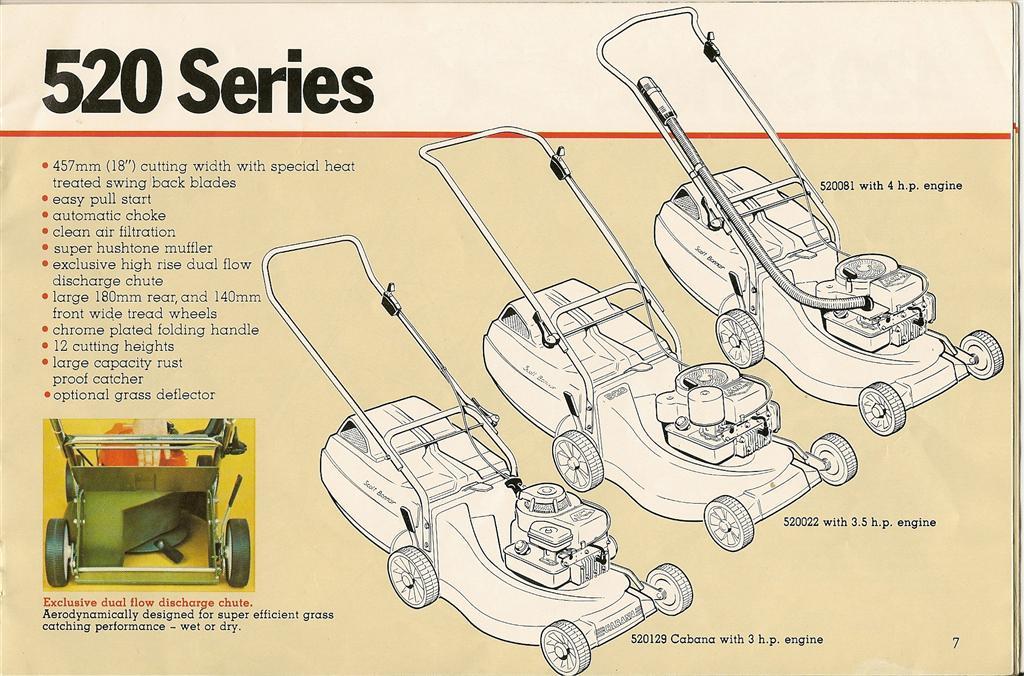

sorry to bring up an ooold one but the pic of the rotary's deejay put up ? the one in the back right , black engine . anyone know what that is ? and could it have had a white brigs on it .. have one that says its a craftsman ! same top handles is all i can tell from this . more numbers when its light out ! Dave
Hi Dave, that machine is a Scott Bonnar 520 Series; Model number 520129; "Cabana" with a 3HP Briggs and Stratton....It's the baby of the 520 Series....Here's some more info for you... wink [Linked Image]
Hi again Dave, I forgot to ask have you got the decals made and fitted to your machine? Can you please post some photos of it completed. This would be great for the archives. wink

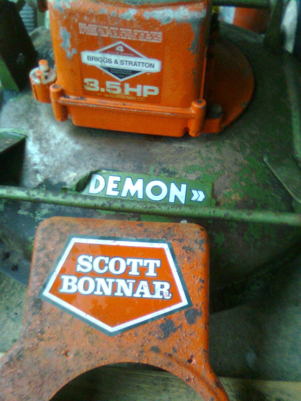

Just for the record, you machine is a Scott Bonnar 320 Series; Model number 320039; "Demon" with a 3.5HP Briggs and Stratton engine.
sorry havnt had time to go there yet but collecting stuff and see if they can help / make more decals , seem keen on getting more things to copy ! i need to take pic's pf some i have here and mesurements of them . talk about colours too , im sure the sb ones are meant to be clear ( mine are ) and the paint is the background colour ?? maybe you might know more about this though . thanks for the help again too . cheers Dave
