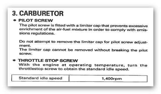

Just paid $US15 to download the Service Manual for the GXV390 to get this information
[Linked Image from img.photobucket.com]
At least I know what does what now

Note that the pilot screw is actually the idle mixture adjustment, and it has only a small effect anyway. If you have idle problems, it may be worth investigating, but it has nothing to do with cold starting problems.

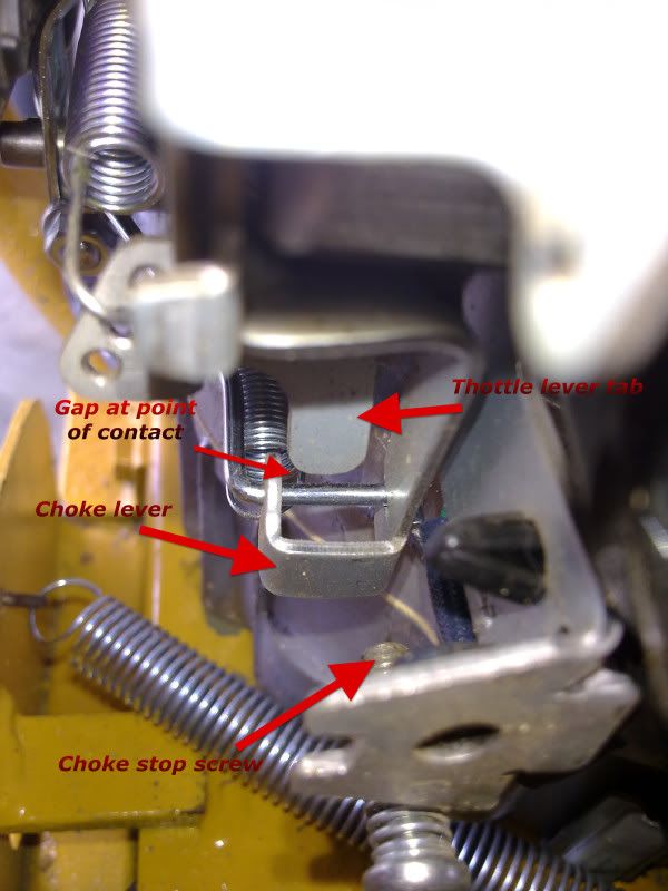

OK it was the old 3rd bolt completely covered by the fuel tap lever when in the open position trick.
Still couldn't get it right off due to the mower handle being in the way but enough to see the choke and it is not even working. When I push the lever into the choke position the throttle linkage is supposed to pick up the choke linkage and take it with it but it is too short to reach swings right past it and I'm blowed if I can see any way to close the gap - the engagement tab needs to be longer by about 2mm - it's as though there is something missing but the manual doesn't show it.
If I hold the choke against the stop with a screw driver it starts first kick from dead cold - like it should. Email sent to Honda
If that is a new engine, it must have a warranty from Honda. If so, you need to contact them and get this sorted out. I can't tell from the picture what is happening, but if you are pushing the speed control all the way forward, across the strong detent so it clicks into the choke position, and the choke isn't closing, then something is wrong. The linkage should snap right forward and touch the choke stop screw. Modifying a brand new engine to make it work is a dumb idea: it needs to be made to work the way Honda intended.

Hmmm.......the "known good one" is exactly the same. Did learn there is another tab further up that the throttle picks up to operate the choke but the throttle only hits it about 1mm from the end of its travel and doesn't move the choke anywhere near enough to close it.

SORTED - Spoke with the mechanic at the local dealership as we looked at the example on their shelf. Turns out the choke return sping is way stiff and you virtually can't pull against it with finger pressure on the throttle lever. Mechanic said he nearly always replaces the spring with one with less tension - also I need to hook the choke cable onto the lower of the two holes on the throttle lever to give that little extra travel.
So, you were not managing to get the speed control lever to snap across to the choke position? With the small Honda push-mower engines there are sometimes problems with people doing that: if they are not shown how to do it, they may not feel comfortable pushing that hard on a plastic lever. The problem may be worse with a larger engine.
I doubt it is necessary to change Honda's design by using a lighter torsion spring under the choke bellcrank, and I would not do so myself, but of course this is your engine. The first time you set up the speed control lever on a Honda, and get the choke at one end of the travel, and the kill switch at the other end, working precisely as you want, is a learning process. So far I have found them comfortable to use once I have set them up and then used them a couple of times - in fact I prefer them to the Briggs controls which have no detents so you are never quite sure where the choking and killing are going to happen.
