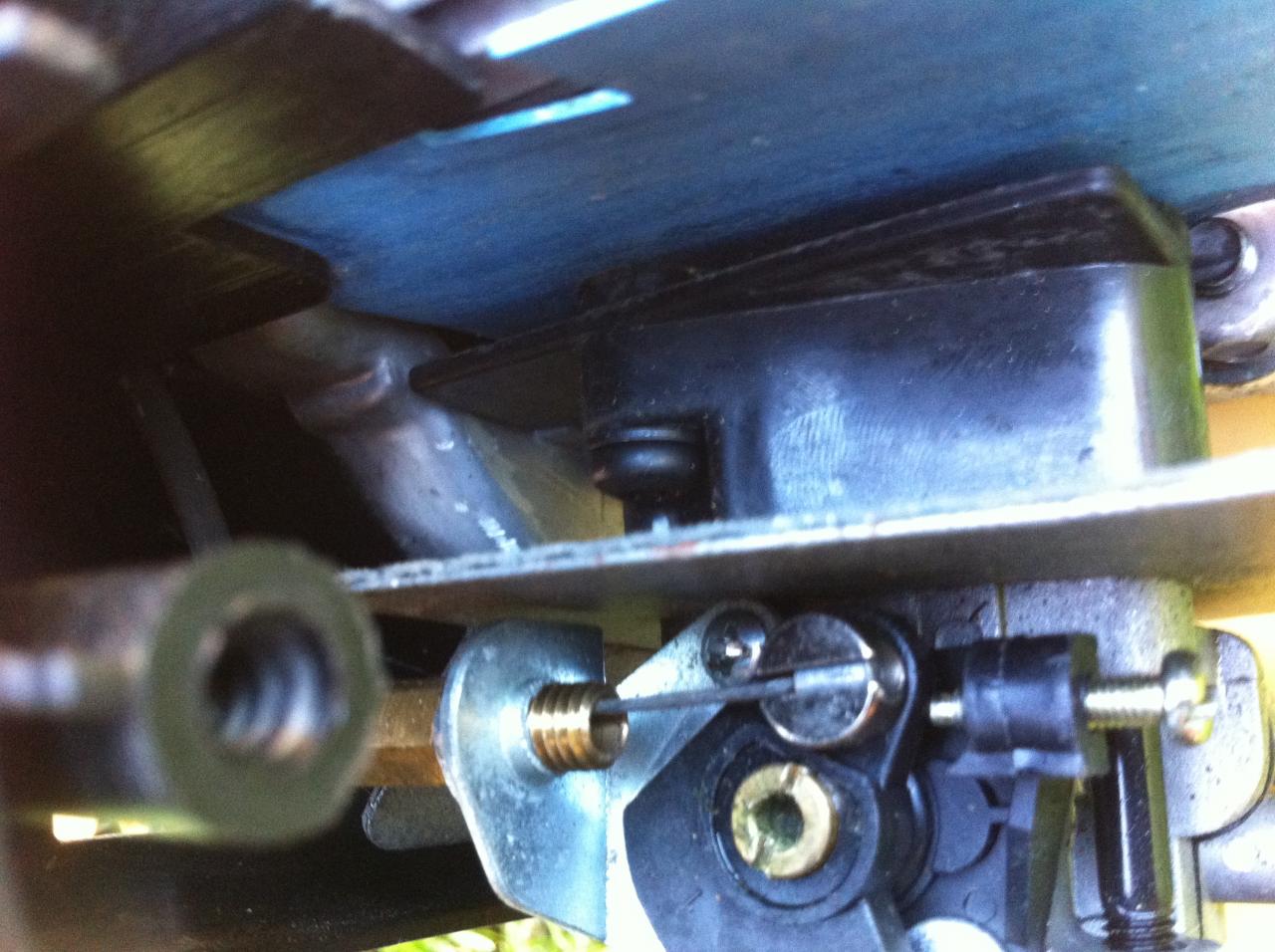

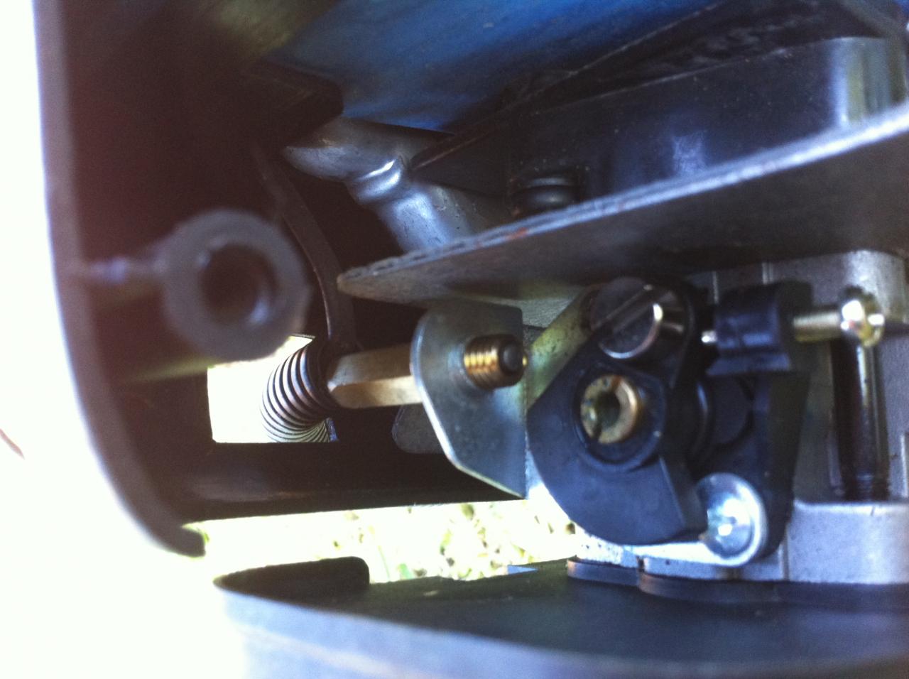

thanks guys. that looks like the problem. the inner cable was detached at the carburetor end. i have tried to fix it on to a screw as shown in attached pic. I believe this is the place it should go in. can you please confirm?

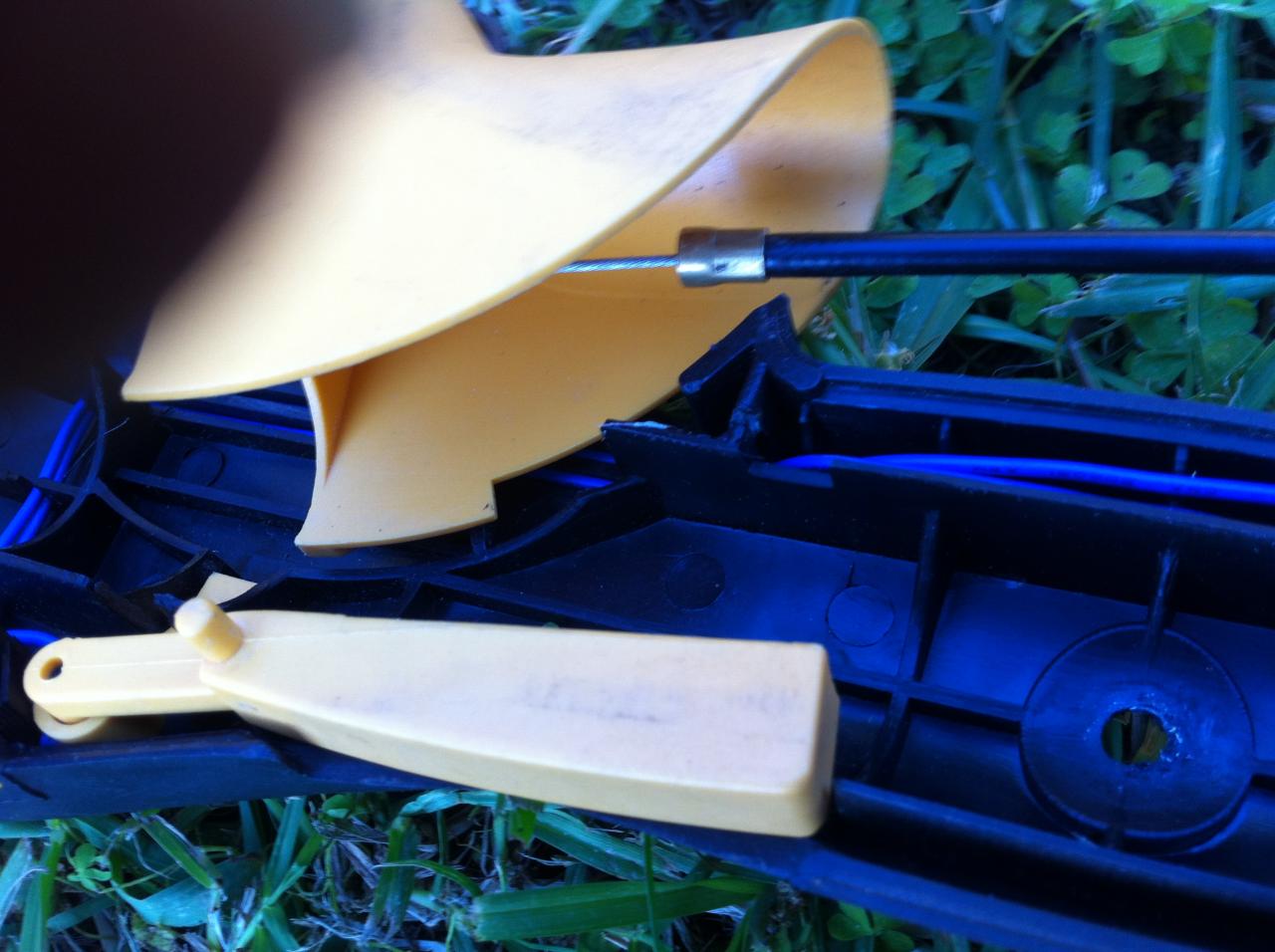

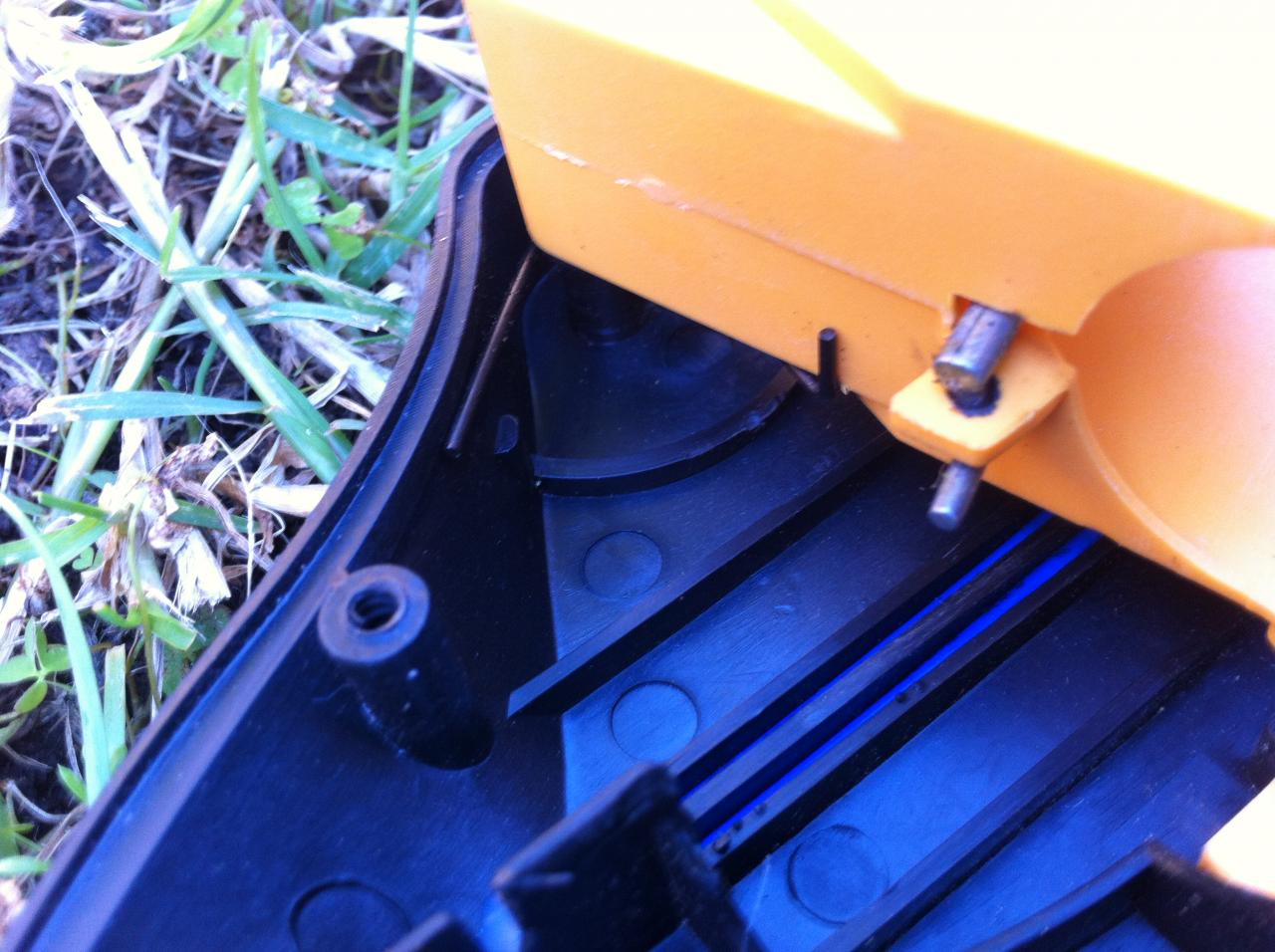

also while doing this I had to remove the throttle lever so stretch the cable enough. i seem to be having problem getting the throttle lever back with the right tension for the inner cable so that it stays on and would actually accelerate. pics attached. i couldn't take the pics just before removing the throttle since it just popped out after unscrewing the cover. I am not sure if i got the throttle spring etc assembly correctly fitted.

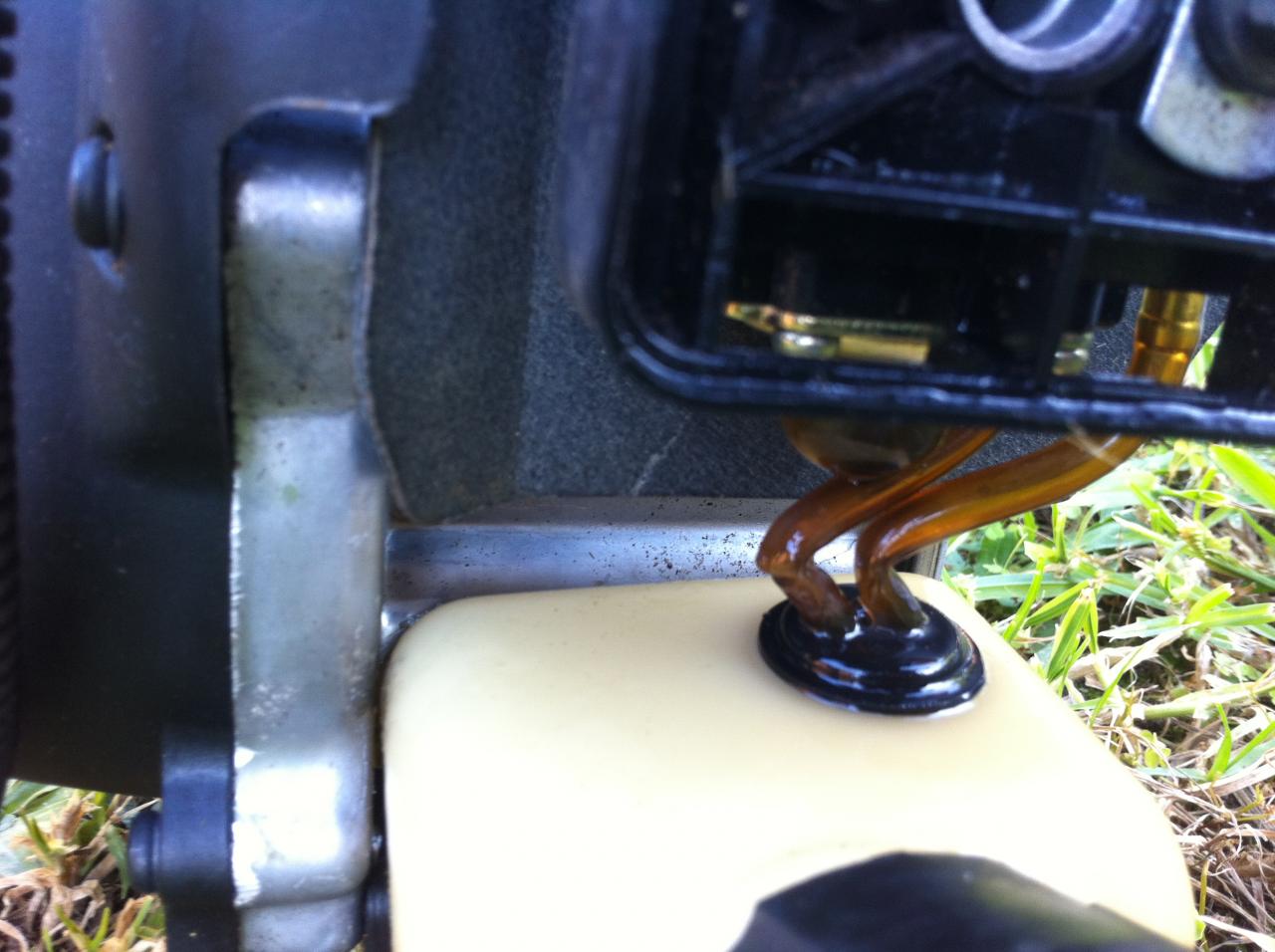

i have one more problem. the fuel line is cracked and would need to be replaced. both the fuel lines - one to the primer and the other one to the carburetor have cracked at the same time. glad i noticed it while doing the inner cable. any suggestion on where can i get the fuel line and step to install. looks fairly straightforward but would like to follow steps from experts here.
many thanks again.
dhiren [Linked Image]
First, what you have done with the inner cable at the carburetor end appears to be correct. It seems to fit properly into the hole in the anchor fitting.
Second, those fuel lines look like they have gone hard and are discoloured. One has a strange kink as if it has been overheated. You can get fuel hose at a mower repairer, but there may be cheaper options if you measure the hose and then buy a metre of it.
At this point I have no idea how the upper end of your throttle system is supposed to work - I can't tell from those pictures. Let's see if someone else can help.

The cable connections look correct to me, I've got two of those whippers here for parts. Just make sure the outer cable is secured correctly at the control end.

Greg, my understanding is that he's now correctly assembled the carburetor end which was the original problem, but along the way he's dismantled the control (upper) end of the cable and now can't put it back together. Could you post a couple of pics of the upper end of an assembled one?

Woops, Sorry, my bad! Apologies all round. The GMC's I've got here have a different type of handpiece.
Looking at the pic of the upper end, the inner cable doesn't look to be able to fit any other way, and I would say that the other half of the handpiece has the locator for the outer cable. My suggestion would be to try assembling the handpiece with the other half first. You should be able to test the operation of it without having it fitted to the whipper.
The only cable adjustment I can see is the brass piece the cable goes through in the first two pics.
If all else fails, maybe strip it completely again, take a photo of all the parts, and I'll guide the reassembly.
