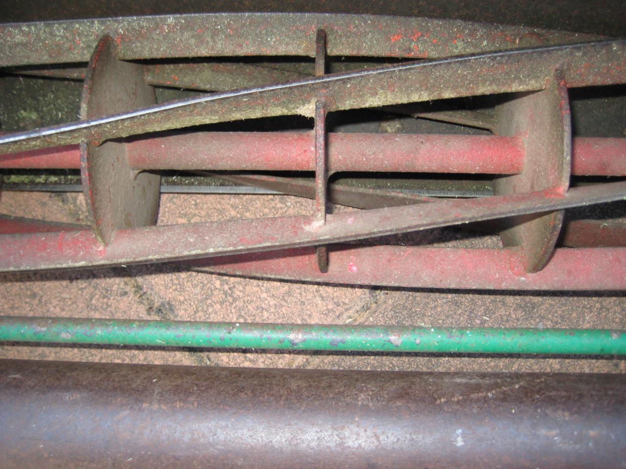

This is a picture of the fixed blade wear my mower has. the "shiny" part is about 4mm wide and fairly even along the length of the fixed blade. the wear is (by my guess) at an angle of about 2 degrees. The cut is not much better than my rotary mower at the moment. The blades are not contacting and I can get aprox 1/2 to 3/4 turn of the cylinder blade when spun by hand, but it is tending to grab and rip the blades of grass rather than cut them cleanly. My question: am I better off having this sharpened or milled flat and square, or should I replace the knife because I will probably loose a fair bit of meat on the knife to return it to square ...and it could take some costly labour time? Sorry the picture isn't great but I think you should be able to see what I mean. Cheers

Beammeup, from your picture you appear to have the bluntest reel blades I've ever seen, and I thought I'd seen some blunt ones. That, plus what may be too much clearance between reel and bedknife, would produce the outcome you are getting. Your description of what is happening, and of your bedknife, suggests what you need is a routine resharpen of both items, followed by proper adjustment of the clearance between them. Of course they must be sharpened simultaneously by the same expert. I seem to recall deviosi telling you where you can get an excellent job for $45, which is a highly attractive price. Remember you need to have the reel bearings checked by the expert, and you need to try to get him or her, or better still someone from your local bowling club, to instruct you in adjusting the clearance between reel and knife: that is the main determinant of how well it cuts, and how long it is until you need another resharpen.

Beammeup, because your reel blades seem to be running some distance away from your bedknife, you can at least fix your folding-without-cutting-the-grass problem by adjustment. Try a sheet of newspaper between the reel and bedknife, and turn the blades by hand (spark plug lead disconnected, of course). If, as I expect, the newspaper is not touched at all, you could practice adjusting it - on both sides individually of course - until it cuts or tears the newspaper most of the way across, but doesn't touch the fixed and moving blades against each other. (You can't expect scissor-like paper cutting from blunt blades.)
You said the reel only turns half a turn or so, despite there being clearance between fixed and moving blades. This sounds as if your reel bearings may not be in great shape.
The reason I suggest you practice a bit more before sharpening the blades is that if you make a small error in adjustment and there is light contact between them, it won't really matter because they need sharpening anyway.

You're right Grumpy; the newspaper doesn't even get damaged between the blades. I will make some adjustments gradually (say 1/2 turn of the adjusting screws on each end at a time) and see how it goes. Thanks again.
