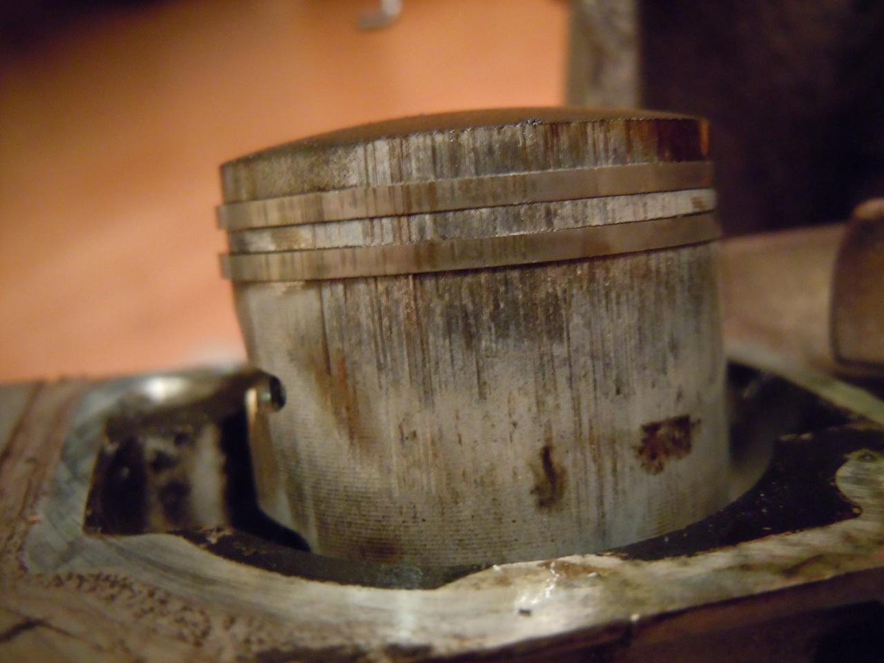

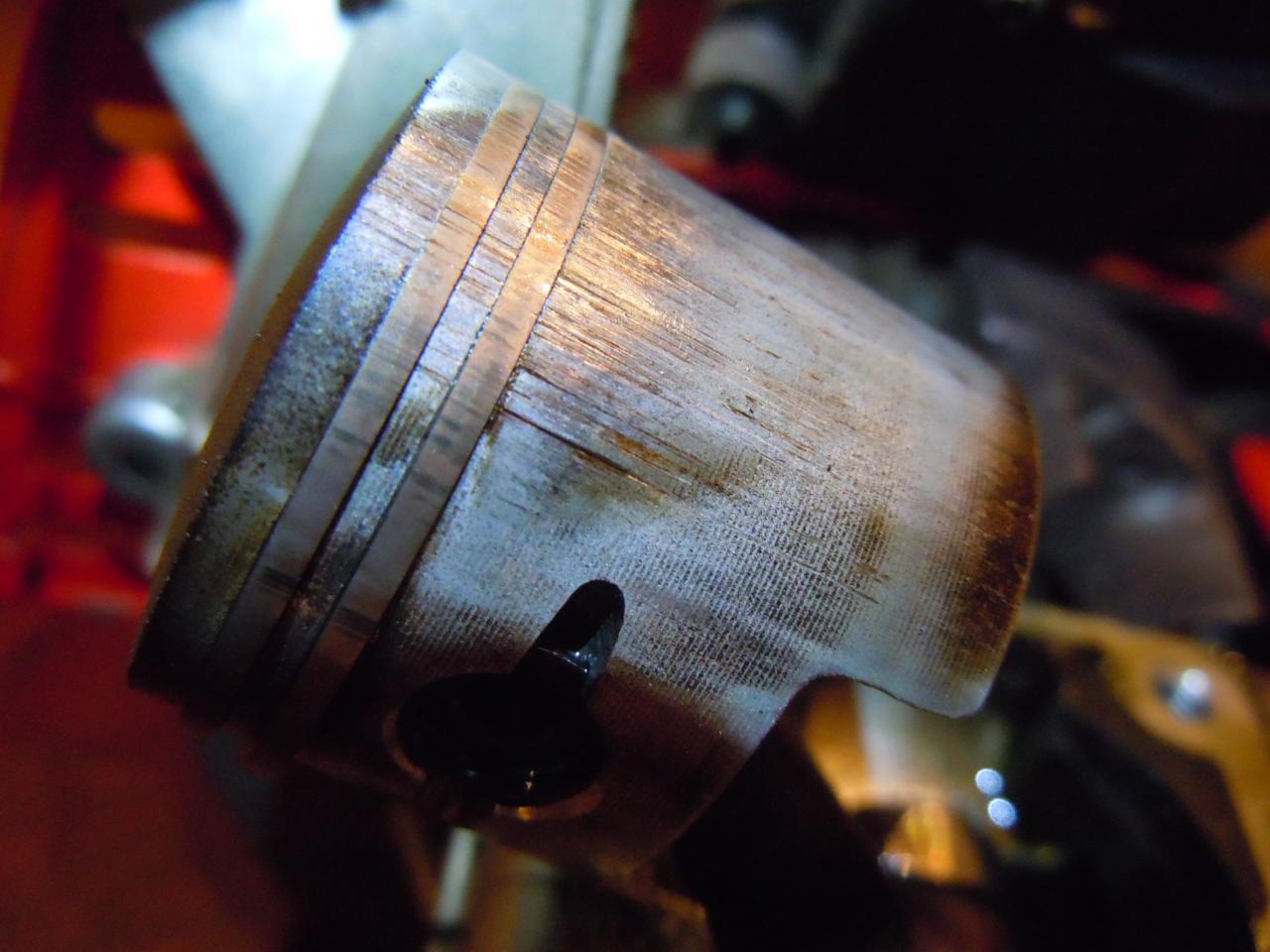

Bad news. Took my Shindaiwa T230x apart and found this: [Linked Image]
Exhaust Side of Piston
Intake Side of Piston
Exhaust Side of Cylinder
Piston was scored throughout. The cylinder was extremely smooth except for a single small spot where you could feel a little bit scratched if you touched with the fingernail.
QUESTIONS: Do I need to replace piston rings AND piston AND cylinder? Or can I just get away with buying piston rings? The trimmer works!! It just has trouble idling so you have to keep pulling the throttle to keep the engine running. Will it cause more damage in the long term if I don't replace the entire piston? I'd like to know your opinions...
That piston is significantly damaged - it looks as if someone has run it without oil in the petrol. There seem to be score marks running across the piston rings as well, but it's hard to tell from the photo. The score in the cylinder is probably more important though - piston scoring is most important when it reaches all the way to the skirt and the induction process is port controlled. If there is any scoring or roughness on the outside surface of the piston rings, that is a critical fault and they must be replaced.
It would be possible to remove the rings, polish the piston exterior with very fine wet-and-dry or something similar, fit new rings, and give it a try. How well it worked out would depend mostly on that cylinder score you mentioned. That will bypass the rings causing blow-by, and the blow-by will erode the new rings and ruin them much sooner than wear would have. So, how much do you intend to use this trimmer? If it just sits in the shed and you occasionally cut the edges at home, it may last several years. If you are a contractor, forget it.

What I find interesting is the PATTERN of scoring/damage of the piston. On the intake side, you only see two major scoring streaks right along where the little pins that keep the rings from rotating, and the scoring goes right to the skirt of the piston. The center is pristine clear with no marks.
At the other end (exhaust side) however, it is scored throughout (the exhaust port had a bit of carbon deposits which might have fallen inside and caused damage).
The piston rings are definitely damaged on the exhaust side; I will replace them.
The cylinder score would better be described as a barely noticeable scratch/roughness felt with your fingernail. It does reach the bottom of the cylinder skirt. However, I don't see any blow-by below the top piston ring...
I use this trimmer 3 times a month for 15mins at home. So I guess I'll go with your advice and polish the piston, but I wonder what product should I polish it with?
Dario, I think a variety of things would work. I might spin it in the lathe and polish it with some extremely fine emery cloth, but I think wet-and-dry paper of 250 to 400 grit rating would work quite well for the small amount of metal removal required here. Remember, the idea is not to remove, or even reduce, the scores, but to remove only the raised-up parts, so what is left will bear properly on the bore.
Remember to check the piston ring locating pins - do not let them stand out past the aluminium surrounding them.
