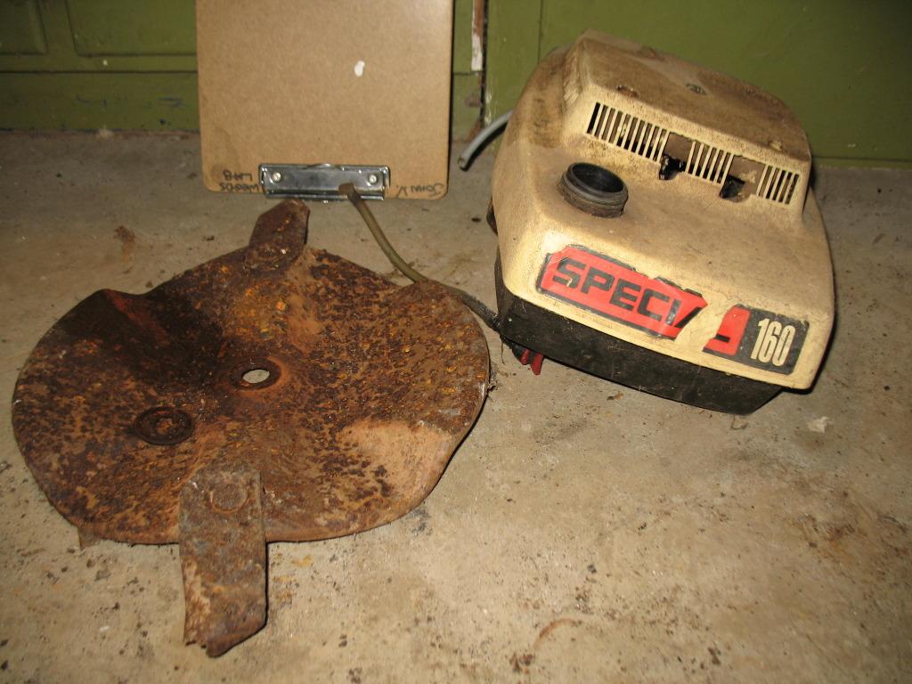

See photos,

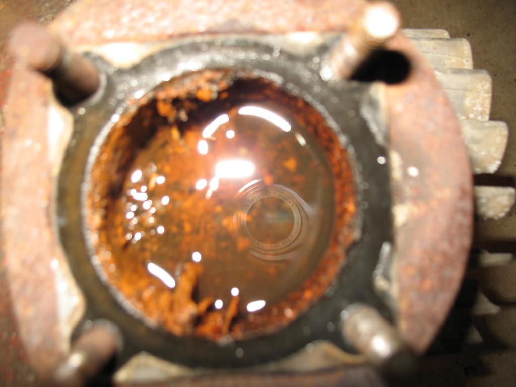

I picked this up as a barn find (should have left it there?) Mate picked it up off the side the road 5 yrs ago sprayed some Aerostart in it, it fired up and the he shoved it in a leaky shed. What do you think guys? scrap and or Rat for bits to ebay? I'd have to unscrew the cylinder studs and split the cases and then the crank to be able to machine out the piston (which is STD). The crank actually turns!! go figure!!

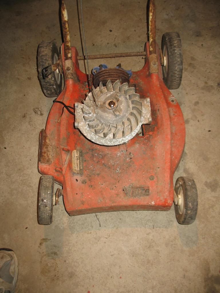

The base is not too bad, the wheel aduster and front axle locator / Keeper has rusted through (easy fix)although it is a bit loose in the housing.....
Oh yeah the engine # is 4 753 6 98 ????
Thoughts?
KEEP!
This was not as common as the normal utility, its a 75-75 Victa special 160.
It will need a fair bit to restore, but its not an easy find, and quite a nice machine when done up!

No I havn't found any cracks in the base. I think that part would come up pretty tidy with a new bush on the axle & axle keepers other than that it is missing one front wheel cap. I dont think it saw much action, going by the piston skirt and inside the base...The carby appears fine (other that the water high water mark)
I figured it might be a bit odd /rare, mmmmmm a pretty punishing 1st resto project....
It shouldn't be too bad, that engine is not to hard to find, and usually in good nick, the rest is cleaning, re-shaping (that front wheel looks a bit off line) and maybe painting.
I would imagine the hardest part is if you want to replace the 'Special 160' sticker.(mind you, the cowl could use some work, so if a suitable replacement can be found, you may get a better sticker on that)

I had the same thing with a motor on a Super24 slasher. Looked like that inside and turned over still. After a night of getting air into all that wet stuff it locked up solid in the cranckshaft.
Easier just to bin the motor.

Is it just me or is there something wrong with the base on yours where the front axle goes on?? Looks like the LH side in the pic is sitting too far back. Mine has sloppy clips holding the axles and a bit of wear in the height relay arms holes.
Yeah I think so too, but need something to take the mind off a few other things at the momment. I always enjoy a challenge!!
You are right there, what has happened is the front axle has retaining clips which hold it to the base, these have collpsed (rusted out) and allowed the adjuster rod from the back to over centre and drag back the wheel and under a bit. I suspect this is why it was dumped, if you have a look at the blades in the photo there is evidence of them stiking the adjuster rod which runs underneath from the rear to the front. I'll take some more happy snaps to clarify and post...
