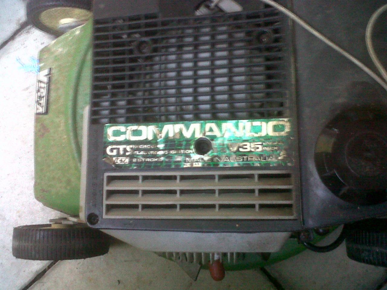

Hi,
I recently obtained this mower as we a re moving into our first home from an apartment! I need to repair the starter recoil, but before I order anty parts I want to make sure that I order the correct ones!
Yes it is a powertorque, it would be worth making sure the spring etc is broken before replacing it, the rope may have snapped and the person that replaced it has not tensioned it correctly. cheers
