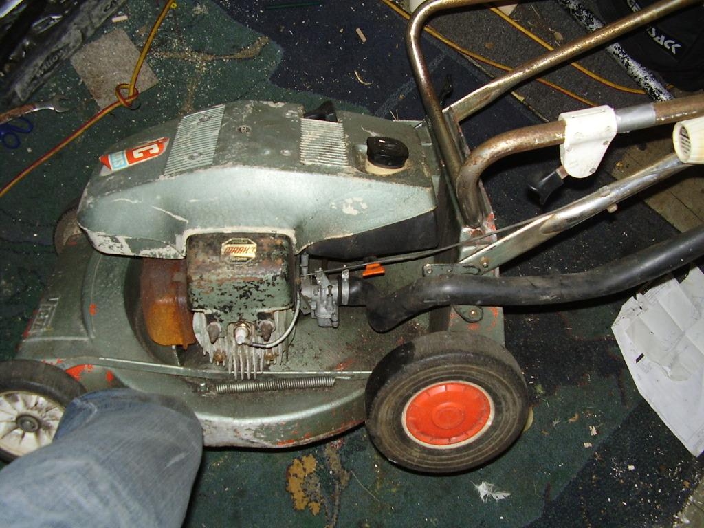

hi all, been fooling around with old victas lately rebuilding them with new piston rings ect, i have an old "70's"series 70 mark 3 160cc 2 stroke with points and condenser and also a vc full crank 160cc the next modlle up i think with smaller flywheel and electronic ignition with the older stle top end and g3 carb, i recently filed down and regaped the points on the old series seventy and installed a new plug and i could not belive the diference this thing had , will start with the lightest tug imaginable on the pull cord first time every time even without a prime "you could almost breath on it and she will take off" but the question is i want to convert the old points system on the series 70 with a points and condenser eliminator kit i have one already a blue atom here is the photo
i bought it years ago for an old "65"jhonsen seagull outboard for the exact same reason and never used it i tried installing it in the mower it gave a spark but did not run at all dispite many pulls then i found this
http://cgi.ebay.com.au/Atom-Electronic-ignition-module-suit-early-Victa-/140533397592
but there are no more availible i cant find any anywhere on the net
is there an equivelent part that will do the same job....???? i notice when the full crank victa comandos apeard just afterwards they ran electronic ignition would a module off one of them or a power tourqe moter work the same way if i used one of them without changaing flywheel/coil any help on where to find or what to look for to get one of these points and condenser eliminator kits for early victas would be so great as im planing two mod one of these two the max with help from

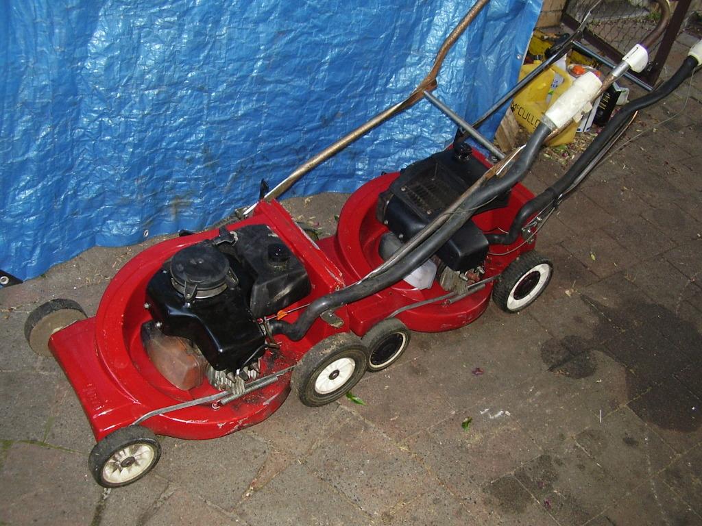

a vice and some files and whack it on a scooter with a go kart clutch from what ive reserched you can get 16-20hp out of a stock 4-5hp victa 2 stroke if you get it right but they go boom quick but hey if dont make the scooter damm ill get my lawns done fast smile here are some pics any way off my rebuilt mowers b4 after not quite finished but theyve both done atleast 100 lawns each and still showing no signs dieing soon
