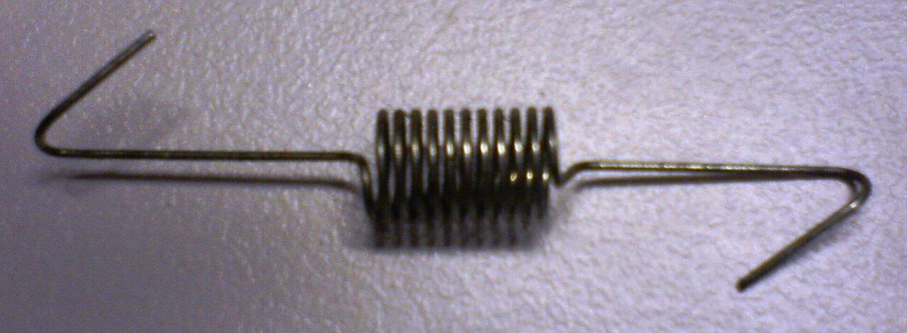

Here is a picture of a GXV120 governor spring:
