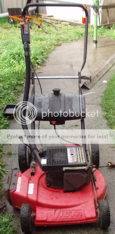

Joined: Jan 2008
Posts: 55
This is mine ![[Linked Image from i977.photobucket.com]](http://i977.photobucket.com/albums/ae251/victa160/mower-1.jpg) Mine doesn't have provision for a catcher unfortunatly, apparently I can fit a mulch plug, i'm trying to get hold of one but not much luck yet. I like your mower, unfortunatly I cant help with info on what it is. Will give the grease a shot, it will be less likely to leak compared to oil.

Im thinking that the top on is a 505 SP

Hi victa,are you able to post a photo of your mower as i am trying to identify my own self propelled to obtain the correct parts. as for your rear axel/diff i thought that bearing greese would do but not sure...ken ![[Linked Image]](https://www.outdoorking-forum.com.au/forum/uploads/usergals/2011/02/full-3912-467-sdc10601.jpg) HI hope you don't mind me asking you about the Victa in the picture you posted with this post. I am looking at buying a mower that looks very alike although the pictures are from different angles. Can you tell me which model your one is? I would be really grateful for any help you could give me. ![[Linked Image]](https://www.outdoorking-forum.com.au/forum/uploads/usergals/2015/04/full-9134-21192-mower1sml.jpg)

Pierssy, as nobody else has stepped up on this one, that mower looks a lot like a 'Pro 505SP' model, as it's known in Oz. The Victa 'Pro' series are their heavy duty models, intended for the professional 'lawnie' contractor, and local council, market. 505 = 505mm width of cut, in that model number. These models haven't changed a great deal over time, since 1984 when the Victa half-crankshaft PowerTorque 2-stroke engine was introduced. Download the ~2000 Victa Illustrated Parts List [1.8 MB PDF file] from HERE , and check out p. 32 for the mower, and p.18-19 for catcher info.
