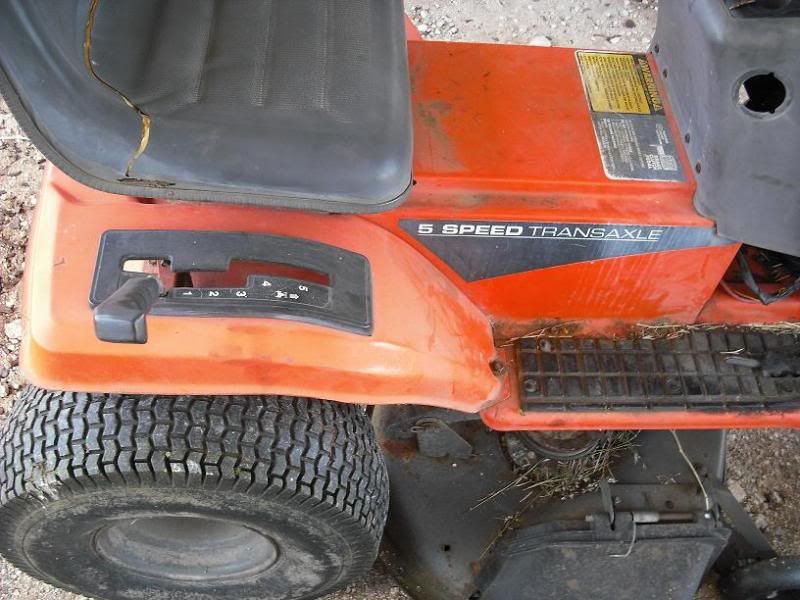

its a 5 speed transaxle, where i have a foot clutch to disengage the gears and change them on the rear righthand side.
is that the answer you were after? smile

On the gearbox it will have an ID plate and I need those numbers. One problem could be a sheared key in the pulley on the axle. cheers2
