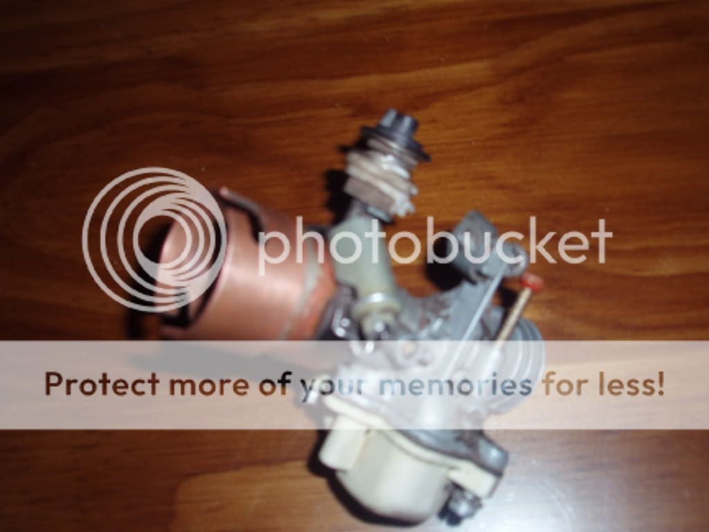

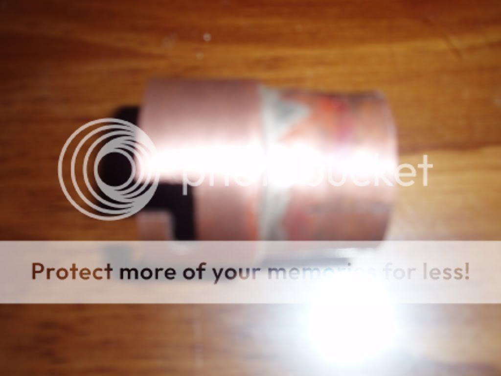

It has this brass/bronze type of adapter, not sure if it was bought or hand made.

Hi,
Sorry about the delay, but here are a few pics of the carby setup.
[Linked Image from i977.photobucket.com]
wow, that manifold is a work of art!

Yeh it looks like either a standard copper reducer that you braze on or two bits of pipe brazed together?
Regards Jay
