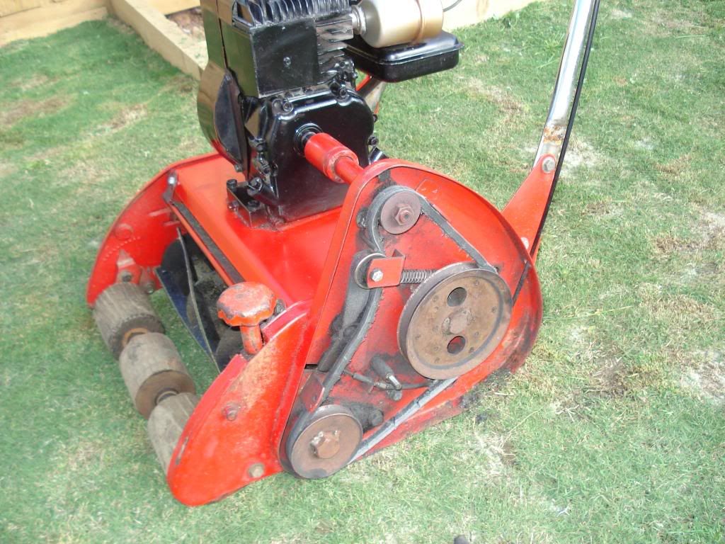

I am a complete noob when it comes to Scotty's. I have just purchased this Scotty, but i have no idea what model it is! It has a Briggs and Stratton 3HP engine, the cutting blades are 17inch in width. the model number is 64608. The model type code (stamped on engine) is 80202 0572 047810110. Any thoughts would be great, cos i got no idea. the previous owner thought it was a model 45, but i'm not too sure, neither was he.
[Linked Image from i124.photobucket.com]
Also, i noticed that this belt keeps slipping off the pulley, and it's in terrible condition. Anyone know what it is called? is there a way to increase the tension in that pulley with the spring attached, so the belt dosen't slip off?

Hi Alex, and a big warm welcome to the forum, it's great to have you aboard! yay
If you check out the thread "Victa Imperial Identification" in this topic, you will see that your Scotty could be a composite machine made in New Zealand by Morrison mowers that was badge- engineered as Scott Bonnar.
For identification, the Model 45 Scotty is the machine in my avatar, and you can also have a look at if you wish, at the thread "Scott Bonnar Model 45 Restored" in the "Old Mower Pics" topic on this forum.
Bruce has uploaded a parts list and manual for the "Imperial" in the Parts and Manuals area which you can access after subscription.
To subscribe, click on "My Stuff" on the top tool-bar, scroll down to subscriptions and follow the instructions.
You may need this manual to help sort your slipping belt problem.
PS..My thoughts are that the V-belt may need replacing! wink

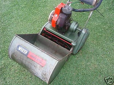

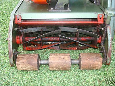

Hi Alex, Here are a few pics so as you can see the similarities with the Victa Imperial and Scott Bonnar
[Linked Image from i266.photobucket.com]Victa Imperial
[Linked Image from i266.photobucket.com]Scott Bonnar
[Linked Image from i266.photobucket.com]Imperial
[Linked Image from i266.photobucket.com]Scotty

Hi Deejay,
Yes the appearances are very similar indeed..... mine is exactly like your second and fourth photo! so they are pictures of scotty's... right?
as for the belt... i went to my local rover dealer and he sold me an A36 Vee Belt.... but it is a little too big... so i have ordered the A35 Vee Belt...
The spring has completely lost its tension... which i think is causing the belt to come off the pulley and become shredded.. i have searched far and wide for a new spring... but cannot seem to find any!

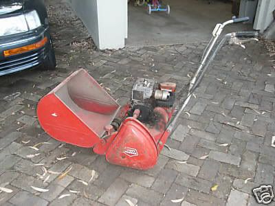

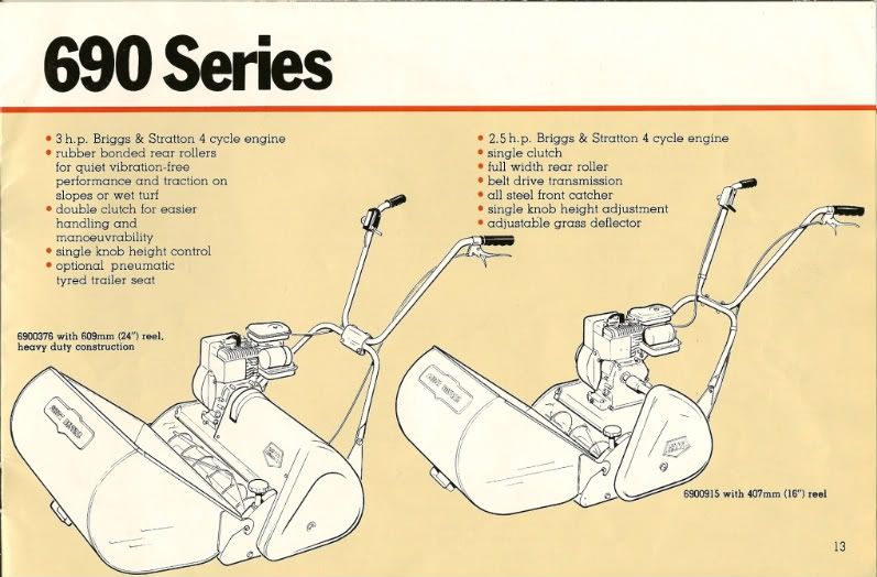

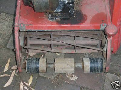

Hi Alex, I have just spoken to a chap today from Rover Australia, and he confirms that the Victa Imperial was manufactured in New Zealand by Morrison Mowers, imported into Australia by Masport for Rover-Scott Bonnar and badged as a 690 Series Scott Bonnar....Please see the pics below;
Hoping this might be of interest to you. wink

hi darryl,
sorry but i haven't been on this site for ages.... i think you have ID'ed it perfectly, sounds to me like it is a Rover-Scott Bonnar 690 series.... now if only I can find some spare parts for it!!! lol.... i'll do some more research on the net..... thanks mate!

Hey Alex, for what it's worth the build date for your Briggs is October 1978. I've got an older 80202 on a Webb brand mower I've been fixing up which has the exact same set up to the drive belts (see posts in this forum RE Webb). Just don't get started on engine colours....heheh.
