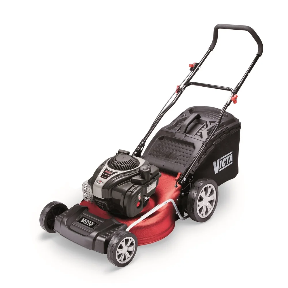

From the angle, it looks like a victa rapid mulcher
https://cdn.productreview.com.au/resize/listing-picture/6ccd73a0-76f2-3945-8f8c-cd4c10193845?
They had significant issues with rear wheels snapping, often fixing them free under warranty

I thought it might be one of those generic "put your label here" Chinese numbers exported all over the world like the notorious Victa Thunder. The black plastic piece oh the front had me wondering.
Good sleuthing Tyler.

Not quite a thunder MF, but close relative. As an aside, the motor is actually 5ftlb, so more like a 3.75hp, which must do well on a 20in in long grass.
The other thing is 2 I have seen have a novel way of ensuring the crank doesn't bend when the solid bar blade hits an immovable object
The deck is so thin that the motor is ripped through its mounts!

Nice work around Speedy, but Victa were warrantying these. Whether or not they will honour it now its 4 years after the fact or not remains to be seen, but its worth a shot.
Go to a Victa dealer with it and quote Dealer Service Bulletin DSB1084
