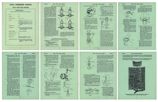

PART TWO – Section T – Victa Two Cycle Engines
This Manual is an amalgam of the old and the new – with some
illustrations dating to earlier models. Note the push to using original
spare parts … an issue even back then.
Here is SECTION T Victa Two-Cycle Engines: -
VICTA WORKSHOP MANUAL c1964 - Section T

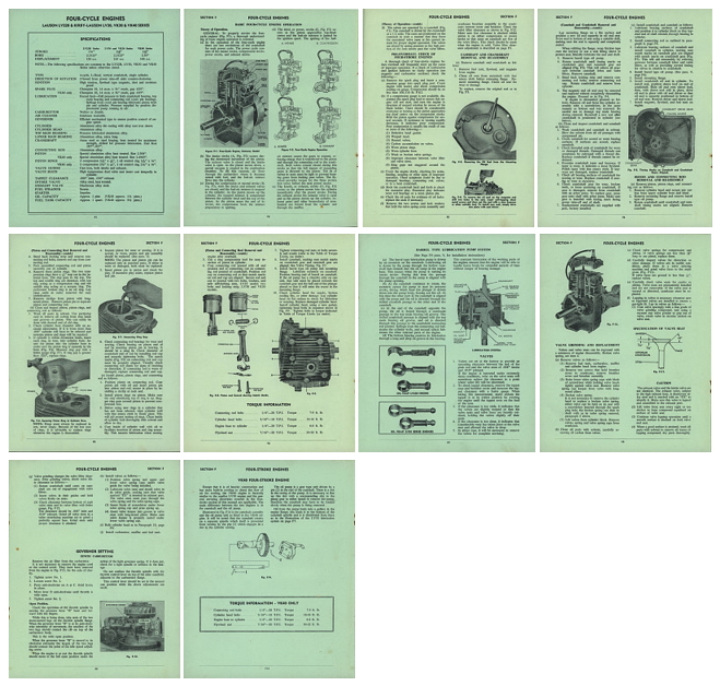

PART THREE – Section F – Four-Cycle Engines
Of course, Victa had to engage with the 4-stroke engine.
It dominated the 1960s domestic mower landscape in Australia -
with all the big mower makers using Briggs & Stratton and/or
Kirby-Lauson [and later, Kirby-Tecumseh engines], in their
domestic range line-up.
Note that these were designated as Lauson Vertical [LV] and
then Vertical Kirby [VK]. Why the change? The answer was in
new North American ownership of Lauson. Tecumseh’s marketing
strategy was to gradually remove ‘Lauson’ from the reality …
Lauson designs were now Tecumseh engines.
In the 1960s, Victa used Kirby 4-strokes on their top-end lawnmowers.
Here is SECTION F Victa Four-Cycle Engines: -
VICTA WORKSHOP MANUAL c1964 - Section F

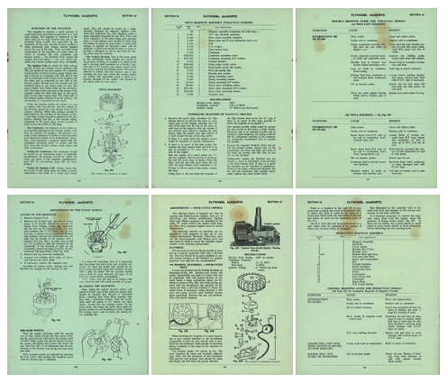

PART FOUR – Section M – Magneto
All the following sections cover the ancillaries – Magneto, Carburettor and Starter.
This part covers 2-cycle & 4-cycle ignition.
Here is SECTION M Magnetos: -
VICTA WORKSHOP MANUAL c1964 - Section M

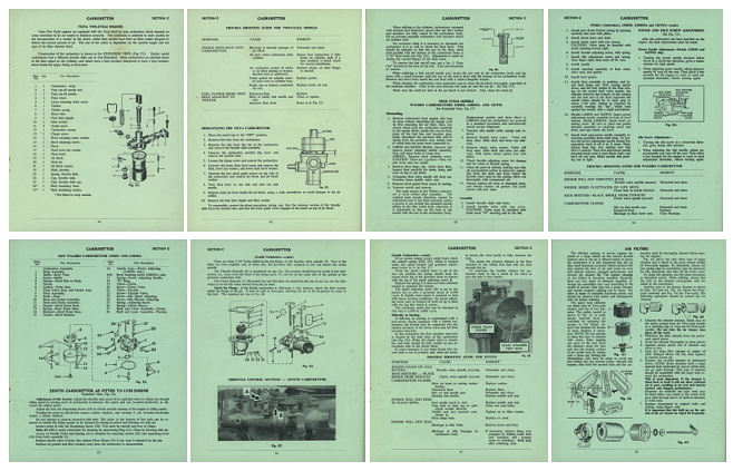

PART FIVE – Section C – Carburettors
This part covers 2-cycle & 4-cycle carburettion
Including air filters used at that time.
Here is SECTION C Carburetors: -
VICTA WORKSHOP MANUAL c1964 - Section C
