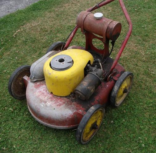

I believe the first model had a handle-mounted fuel tank similar in design
and appearance to the other Rotoscythes. The handle was rigidly mounted and
was not foldable. That would be corrected on the later model. Here is an
early advertisement and early 2015 auction photographs of the first model:-

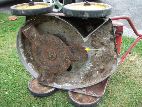

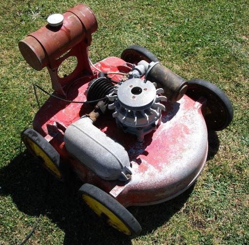

In the photographs (below) the first photo shows the underside of a County.
Note that it is not fitted with any blades. The blades and fasteners are shown
in the second photo.

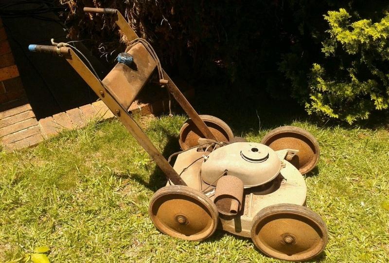

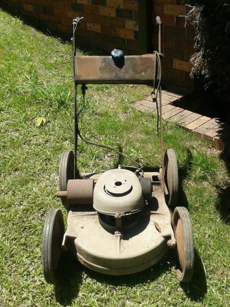

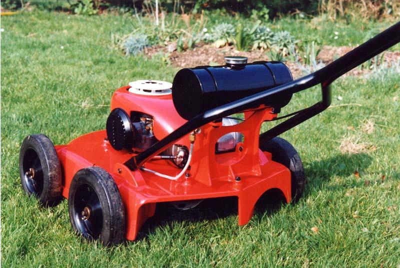

The second version of the Rotoscythe County makes a couple of changes.
For one thing, the mower becomes more transportable: with handles that can
be easily removed without disturbing the fuel tank, which is now affixed to
the base (not the handle).
The County becomes a more modern machine, embracing the fully cowled engine
and muffler. I can only guess that this occurred post 1954, as there is a
'blind spot' in advertising records after that year.
Here are some photographs of member pcamore's unrestored machine, one with
engine cowl removed; the other with cowling attached.
