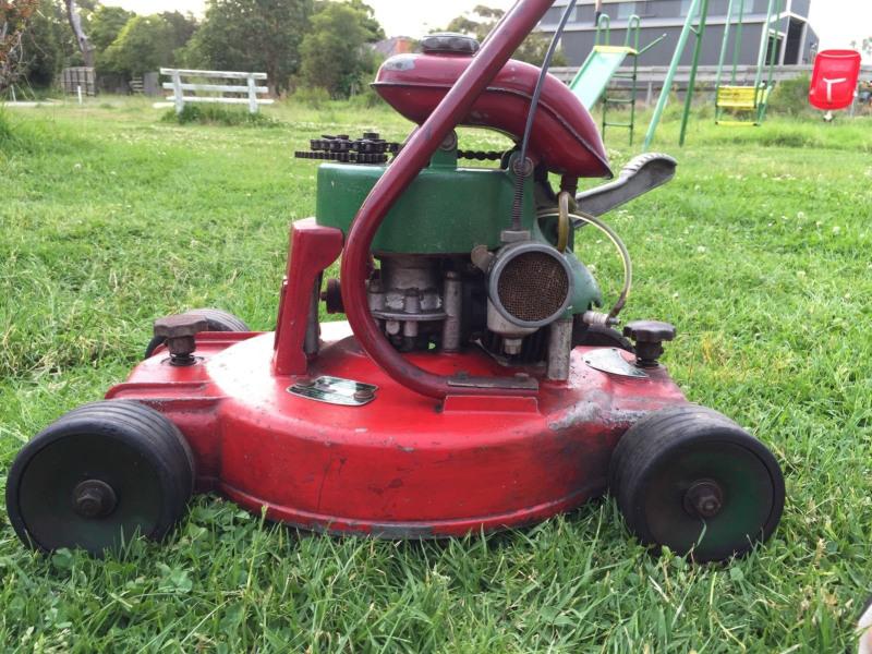

The Austral-Villiers Adaptomatic was an Australian 16 inch rotary lawnmower made by Condeco Pty Ltd,
of 909 High Street, Armadale, Victoria.
Made from about 1956, it was powered by a Villiers Mark G series engine of 70cc capacity, and fitted
with an unusual A-V proprietary kick-starting system. Its other unusual feature was that the machine could
be adapted to take accessories via a power-take-off arrangement [not Version 1 machines].
This was a machine that used extensive aluminium castings, and the deep-skirted alloy base incorporated
a front safety skirt. Engine protection was via two swing-back blades, and a small, spring-loaded clutch
plate between engine and blade holder. The rubber-tyred wheels were small in diameter, and the handles
could not be folded.
This is a most unusual little lawnmower, collectable - not because of good design - but because
it just did things so differently.

The Adaptomatic's version of the kick starter was over-engineered and would have been incredibly
expensive to manufacture. On the plus side, the development of this particular arrangement had a
bonus: the ability to include an air-shroud or cowl for fan-forced engine cooling.
The cowl's supporting structure was not the little Villiers engine, but three steel tubes and
bolts that surrounded the engine and directly connected to the mower deck.

VERSION 1
Here is what I believe to be the very earliest model. It is serial number 230 and it appeared on
an auction site a few years' ago. Note the unpainted base with no ribbing between the front wheels.
Of particular interest is the total absence of the height adjuster knobs seen on later models.
I am unsure how height of cut was affected on this particular version:-
[NOTE: Version 1 appears NOT to have had the PTO feature.]
VERSION 2
The second version offered two height adjustment knobs: one controlling the rear wheels; the other
controlling the front. Not quite a 'one point' system yet ... Note the strengthening ribs in the base.
VERSION 3
The final version was really a consolidation of the designs into the one point system that became
the lawnmower design expectation by the end of the 1950s. This was achieved by conventional means -
a bellcrank and lever connecting rod.
