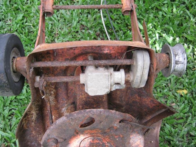

Wheel drive speed control, this is something different as you could vary the speed of the wheel drive
The wheels were driven by the axial through two gear boxes, the centre box is just a adjustable cone the one at the wheel is a chain drive. The centre box is driven by a Vee belt from the bottom of the engine
Did any other brand of mower drive the wheels this way

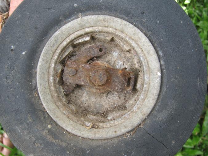

Ratchet in the wheel so you could turn a corner

Man,Ian you sure find the unusual! I know of other southern cross mowers,but this one ive never seen. It awesome! Fantastic technology for what,late 50s? Love the gear box set up,be great to see this completed and restored!

Its great that you have one hubcap, it is in a condition that could easily be replicated...is it plastic or metal?

Wow. Love the gearbox and the ratchet wheel turn. Wonder what problems it had, or was it replaced with simpler, or less parts, systems. Great find. And how does he find these mowers? I suppose it's networking, starting conversations with people and talking to people. Let people you know you collect mowers etc.

The transmission is fantastic. Check out another rare AUS machine:-
