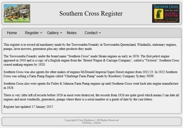

The second acknowledgement must go to the Southern Cross Register
Ian Matthews' site provides for registration (and acknowledgement) that
SC machines survive ...
If you have a Southern Cross lawnmower, I recommend
you place it on the register ... http://southerncrossregister.nqmp.org/

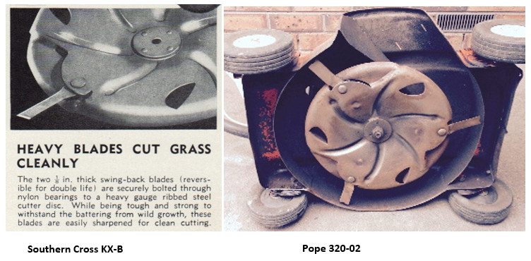

It was only in recent times that I saw closer similarities in detail -
with the base style, wheels, windrower and bladeholder. There was clear
collaboration between two great companies - from QLD and SA.
When I say collaboration, I certainly do not mean the KX-B was a Pope copy.
There are too many similarities in design to say it was coincidence; but
too many differences to say this was a re-badge. It may be that Pope supplied
certain expertise, components, or process machinery. We are never likely to
know that. Also, note that the self-propelled version of the KX-B is totally
unique to Southern Cross.
The image below is an exploded view of a Pope 320-13. This mower was
powered by Clinton. This chassis is one of the earliest Popes to use the
single-point height adjuster - a major change in the 320 series.
The image below is an exploded view of the KX-B
The base is a deep skirt pressed steel design in the style of the Pope.
The height adjuster assembly is of a similar design, as are the wheels,
bladeholder and blade assembly, and windrower. The handle assembly is
quite different.

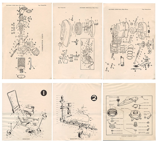

PART SEVEN - Operator Manual - Part 1
The Instruction Manual for the KX-B is comprehensive and nicely illustrated.
I have divided it into three parts for efficiency. The first part covers
Operation and Maintenance of the KX-B.
OPERATOR MANUAL for SOUTHERN CROSS KX-B PART 1 - OPERATION & MAINTENANCE
PART EIGHT- Operator Manual - Part 2 & 3
Parts 2 of the Operator Manual for the Southern Cross KX-B cover the parts list
for the Standard and the Power Drive. Part 3 is the accompanying illustrated
exploded views
of the engine, chassis, transmission and starter. All for personal
use. Enjoy...
SOUTHERN CROSS KX-B PARTS LIST
SOUTHERN CROSS KX-B ILLUSTRATED VIEWS

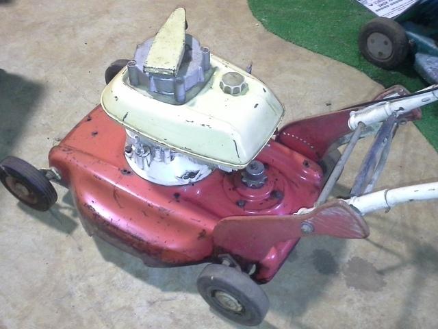

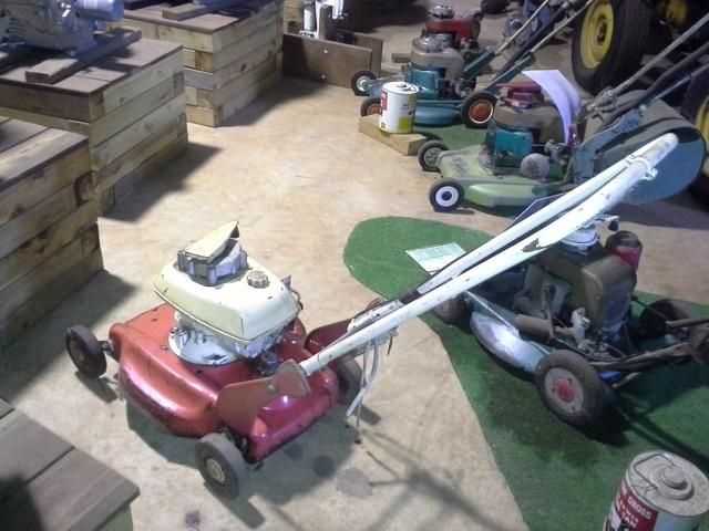

Images of the KX-B are thin on the ground...
I hope this is not an omen of just how rare these mowers are.
SOURCE: https://www.outdoorking-forum.com.au/forum/ubbthreads.php/topics/54682/Southern_Cross_KX-B_Power_Driv.html
A big thank you to member Paul C who took these images at the
Southern Cross Museum in 2016.
