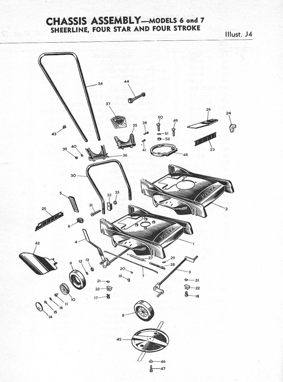

The base is also a different shape. In the GREEN book it show the 2 bases
The 4 star base is more of a square look where the 4 Stroke is more rounded

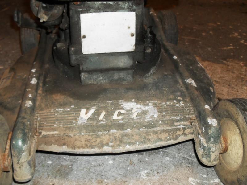

nice work. i did not know they were different as i only have one. now i will have to check to see which ONE it is? there is no gap from engine to base but i was sure its a 4 stroke.round filter too

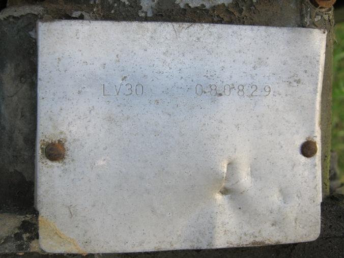

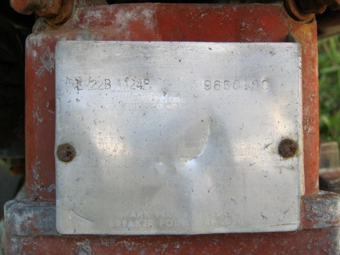

if you can read the engine plate the 4 Star has LV22B engine the 4 Stroke LV30 engine

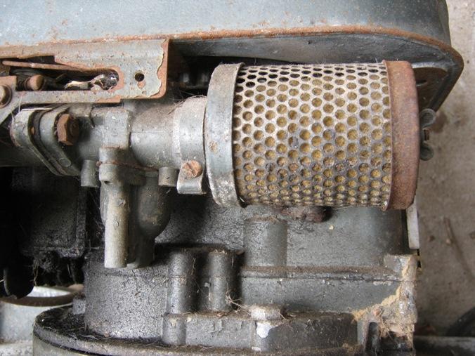

You have the oval air filter,that is awesome I'd love to see some closer pictures of that.As most were replaced so they are getting harder to find.Mine doesn't have it on.

Gizmo your one is in fact the model 7a,or four stroke.

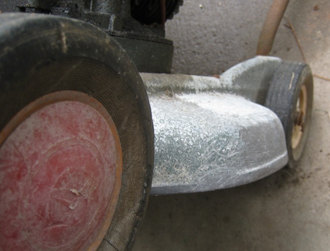

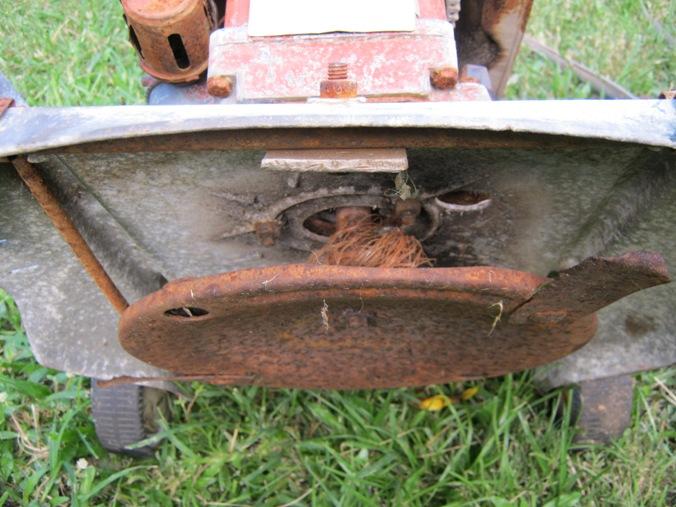

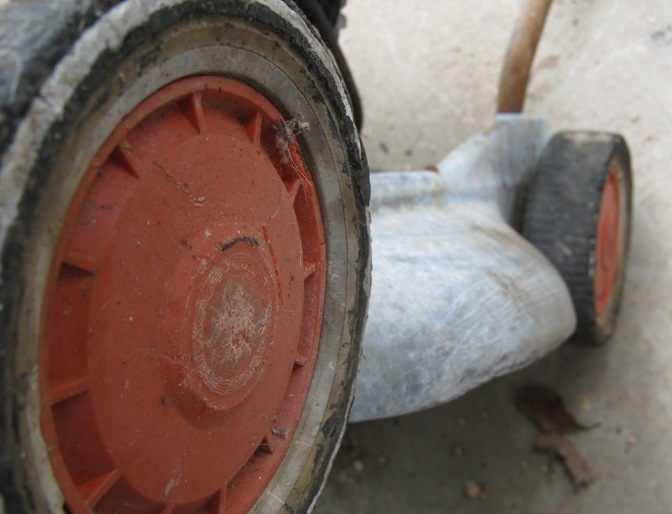

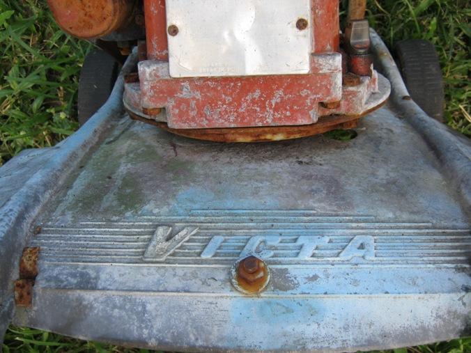

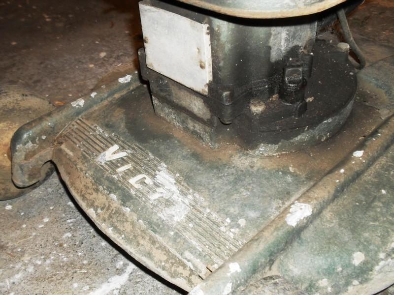

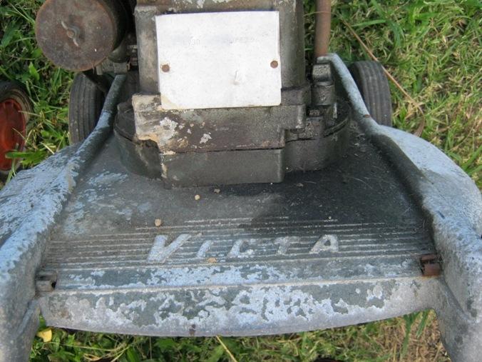

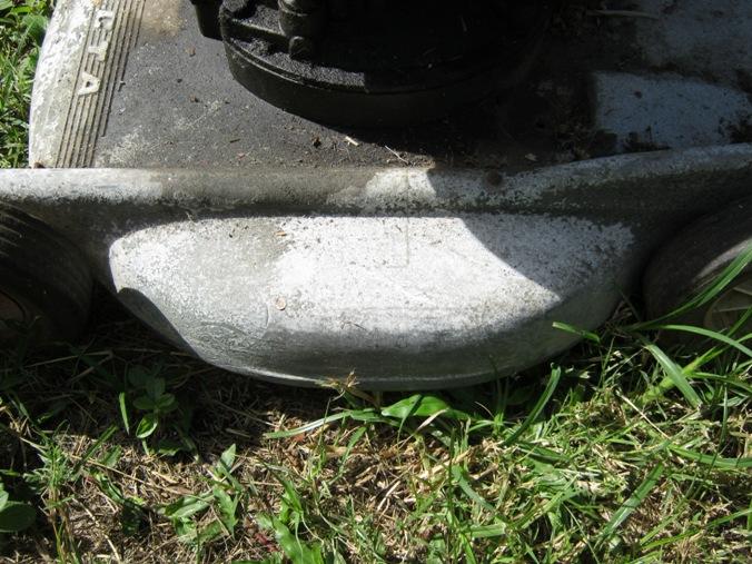

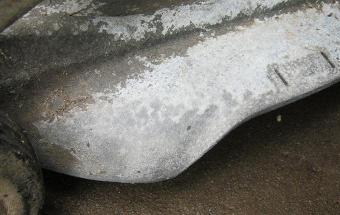

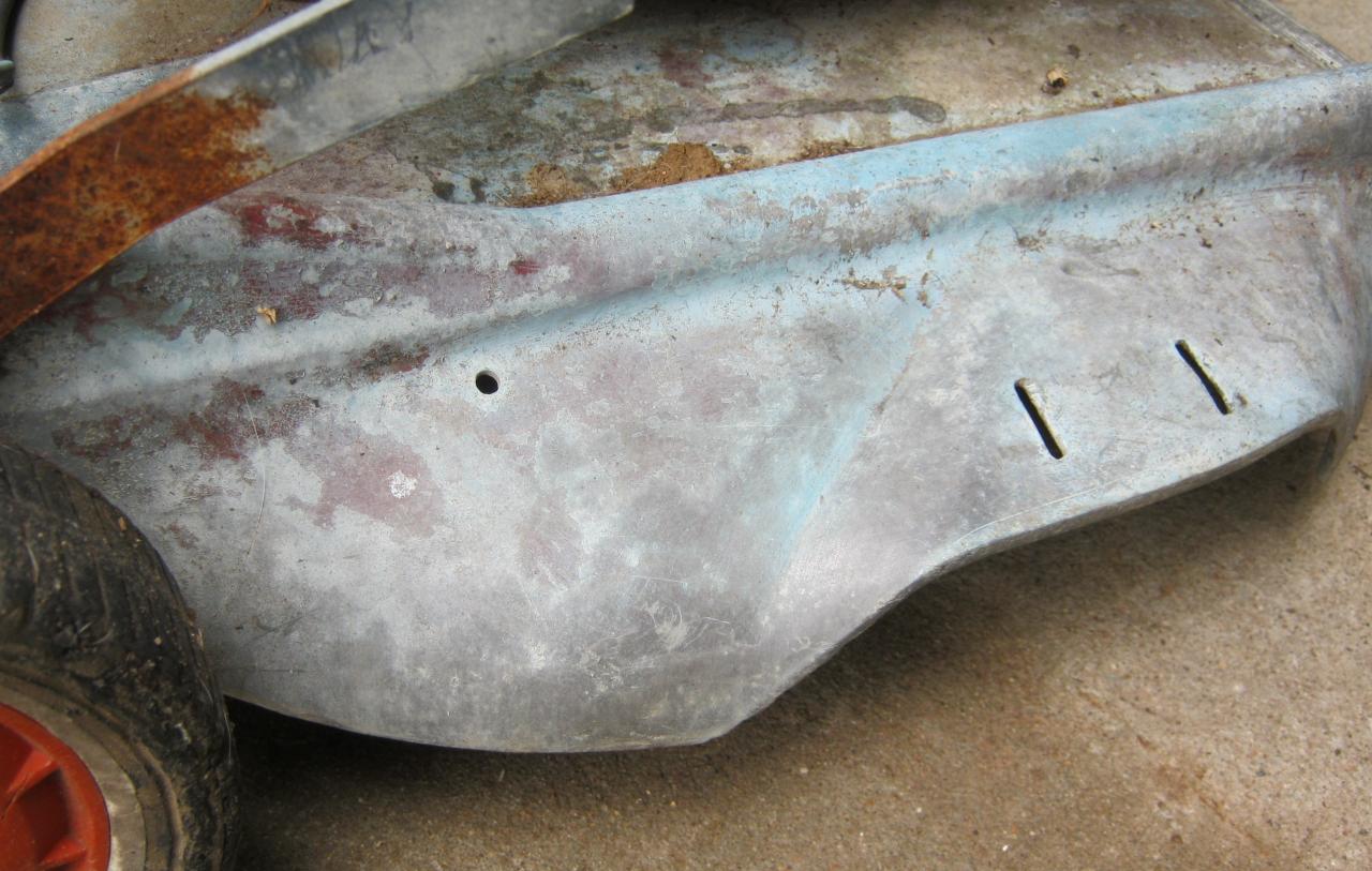

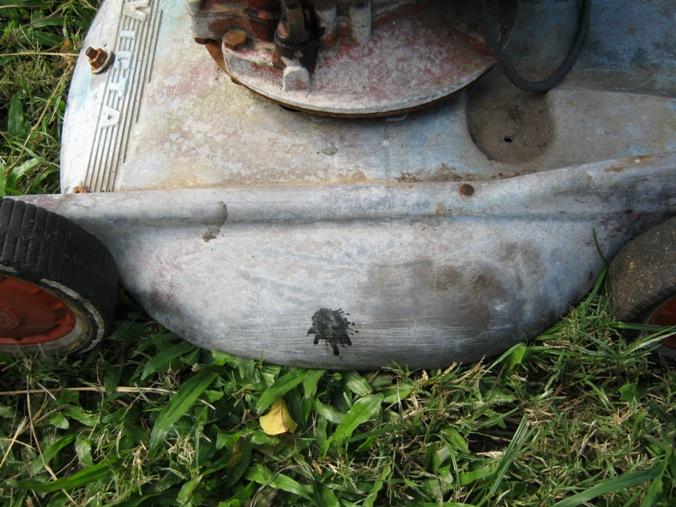

The bases are very different on both sides here some better pictures that might show it better
4 Star
4 Stroke
The other side
4 Star
4 Stroke

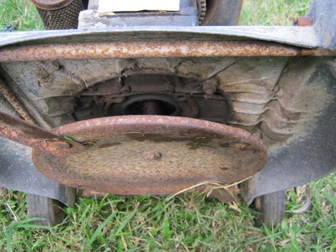

Also the base is different when the engine fits and is listed as 2 parts in the Victa books you can see the difference as below, the engine mounts
AS you would know the 4 Star was made from 1960-61 the 4 Stroke 1961-62
I wounder there is a over lap of models or was the base shape changed while is was still a 4 Star which would explane that your two bases are the same
Ian

Hmm strange I'll have a better look at mine as I have two of each base and I haven't noticed changes as their bases where used for both two and four strokes.If you have a look at a Sheerline base you can clearly see the holes for the spacer plate on the for the four star.I wonder if one hasn't been changed as they weren't the strongest bases ever made and even earlier on some where changed.The picture from the green books really only give a rough idea.As if you look you'll see two hollowed bits for the carby on the two stroke.Only the consul 2 had those as their carbys were on the opposite side from other two strokes.Does the four stroke base have hole on the wheel at the bottom of the handles where a screw can go in?
They do have the right carbys on them and yes it is the right air cleaner for the four star.Bugger I've never been able to find one.Good work there.

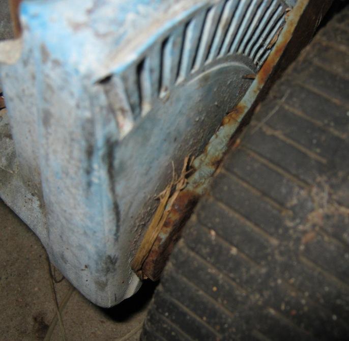

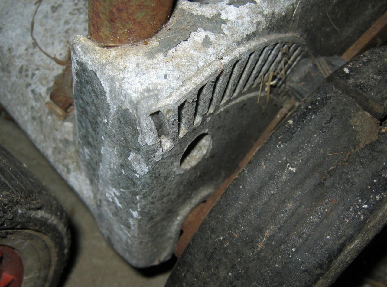

Here is the hole behind the wheel
4 Star has a hole the 4 Stroke does not
You will also note the under side of the bass picture above the center hole is a different size
OK I didn't do a lot today but I did go and have a look and yes there does appear to be some small changes in the bases. What I can see is the four star has the same base as the Sheerline and four stroke has the same base as the Cadet.
