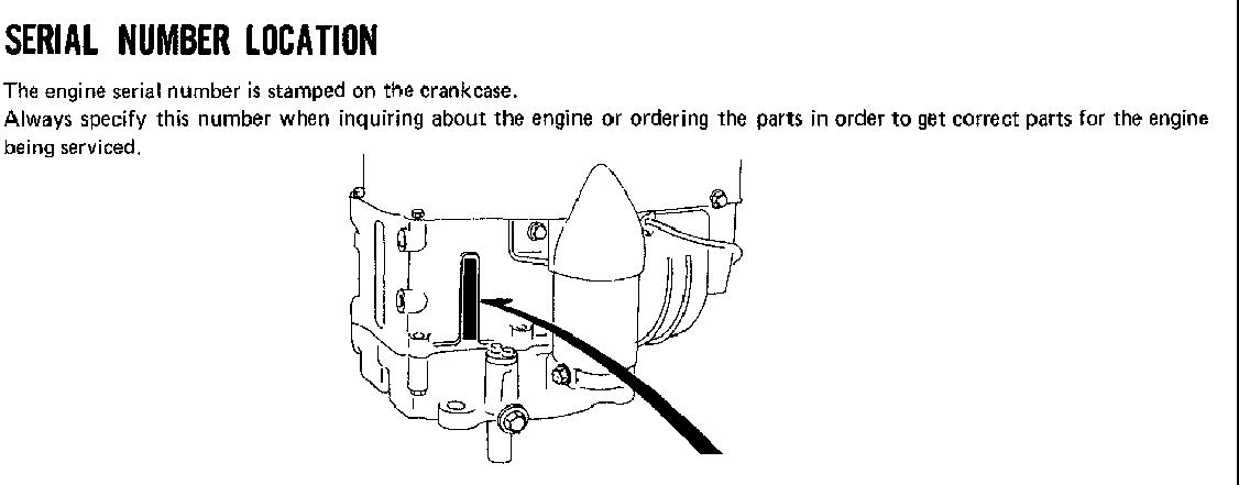

where on the motor will i find the engine code ?
jason
The GV400 serial number location is shown in this drawing from the workshop manual.

that`s where i got the gv400 2055406 number from,that`s the only number that`s there.

Jason, there is usually a first line with the model and serial number, and right underneath it a separately stamped four letter engine code.

thanks again for the detailed reply grumpy.have degreased & cleaned the entire motor & definately no other numbers on the engine than those quoted previously.

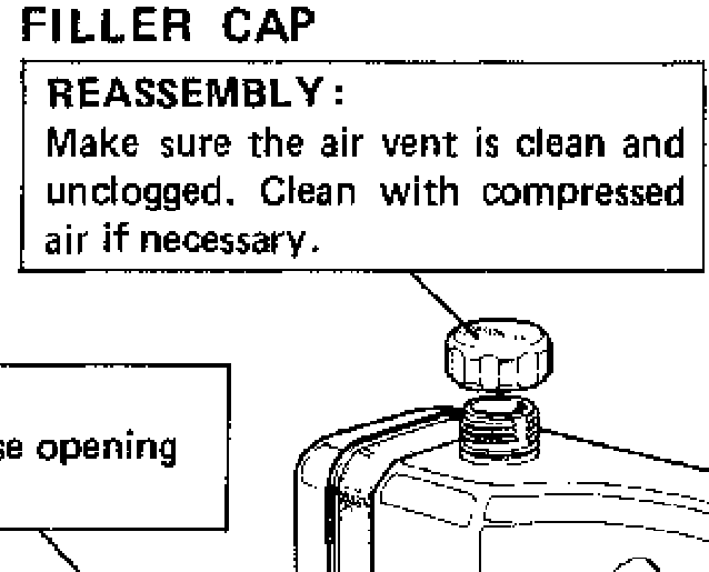

Jason, please do the test I asked for on fuel flow through the fuel line. Disconnect the line at the carburetor, and let the fuel run into a cup. See whether it continues to run at full flow, or can only sustain a trickle. Continue the test for at least a cupfull of fuel, preferably more.
I am trying to check two things here, either of which could cause your problem. The more likely of the two: the vent in your fuel tank cap may be clogged:
Cleaning that vent should be a routine service check.
The second thing the flow check will test for, is an obstructed fuel filter or one that has been installed backward.
The reason the clogged tank cap is the more likely problem, is that it takes half an hour's running for the engine to stop. Given that you said the tank is about 3/4 full, it would take a while to create a decent vacuum in that amount of air space.

in regards to the fuel cap, i don`t think it`s the correct one for the tank.it doesn`t fit properly,has no vent but someone has put a hole through it previously,it has BP embossed on the top of it.

First, the fuel tank. Here are the disassembly and reassembly instructions from the manual:
You need to remove the starter, top cover, tank stay, then tank. It will probably be most convenient to disconnect the fuel line from the tank before you remove the tank stay.
The interior of the tank needs to be bone dry before you clean it. My method of cleaning is to start with compressed air, then brushes and rags to dislodge the recalcitrant stuff, then more compressed air. Ensure the interior of the outlet is clean.
