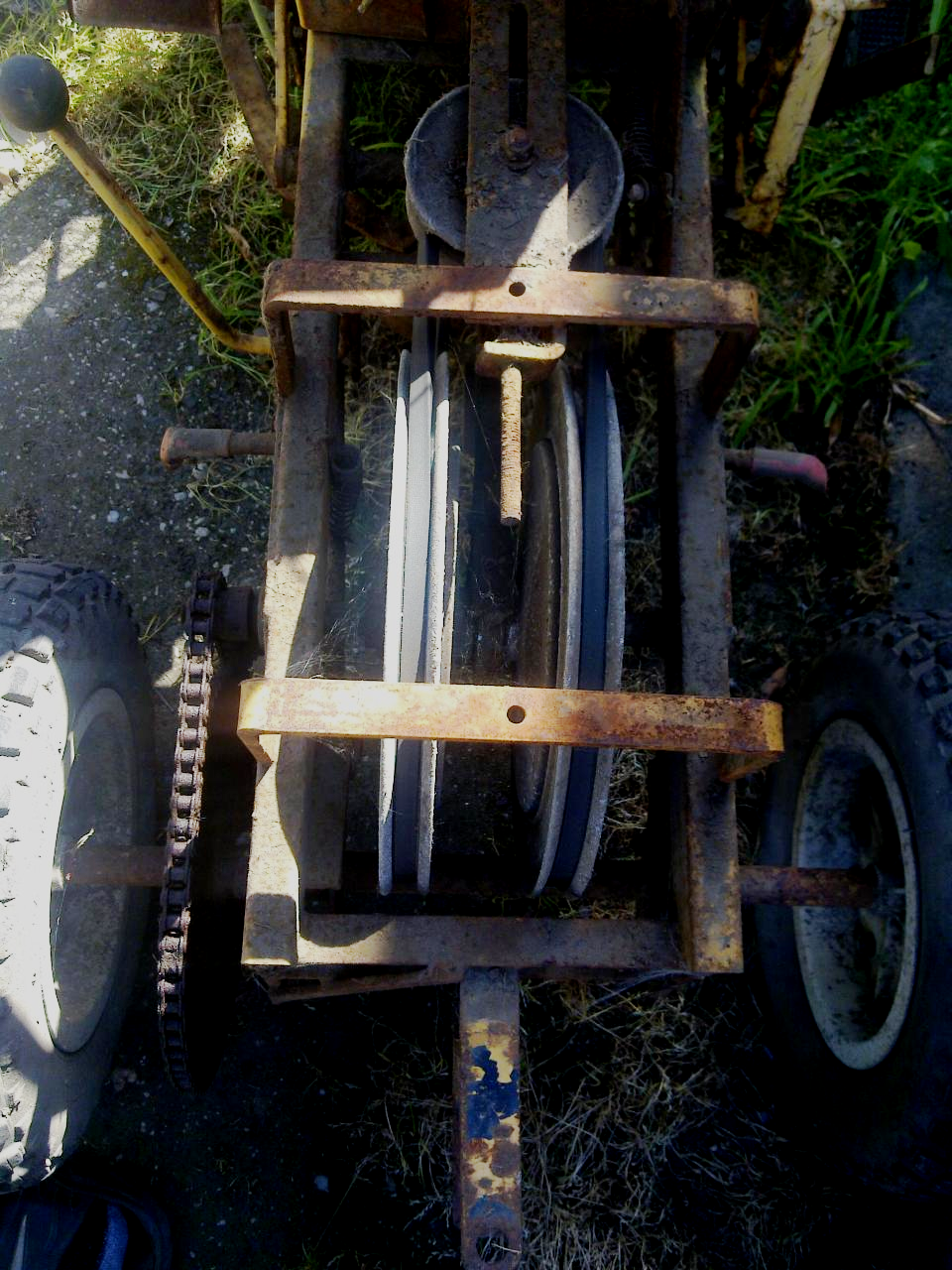

This picture from that thread shows engine end of both the cutter and wheel drive:
There are two pulleys on the front of the crankshaft. The front pulley, right at the front of the mower, is driven through a clutch operated by a spring and lever on the right side of the mower. That pulley drives the cutter deck. The rear pulley drives the rear wheels of the mower. Each of those belts drops vertically from its crankshaft pulley then runs around a pair of idler pulleys that turn the belt through 90 degrees so it is running horizontally toward the back of the mower. The cutter deck belt only reaches as far as the cutter deck, under the center of the mower. The wheel drive belt continues as far back as underneath the driver's seat, then runs a full 180 degrees around a large pair of clutch pulleys that change its direction to forward - see picture from the same thread as before:
After passing halfway around those clutch pulleys the belt runs forward and around a spring-loaded idler pulley that tensions the belt. There is a ratchet mechanism so that the tensioning pulley can only tighten over time, not loosen. The two clutch pulleys are parts of two clutches: one for forward and one for reverse. A linkage from the pivoted clutch pedal under the driver's right foot engages one or other clutch depending which direction he or she wants to go. The left end of the shaft running through the hubs of the two clutches carries a sprocket for the chain drive to the rear wheels. The amount of pressure the driver applies to the clutch pedal (top of pedal for forward, bottom for reverse) controls the amount of clutch slip and hence the mower's ground speed.
Because the clutches are large, the system is reasonably durable and these mowers have been used successfully for contract mowing in urban areas.

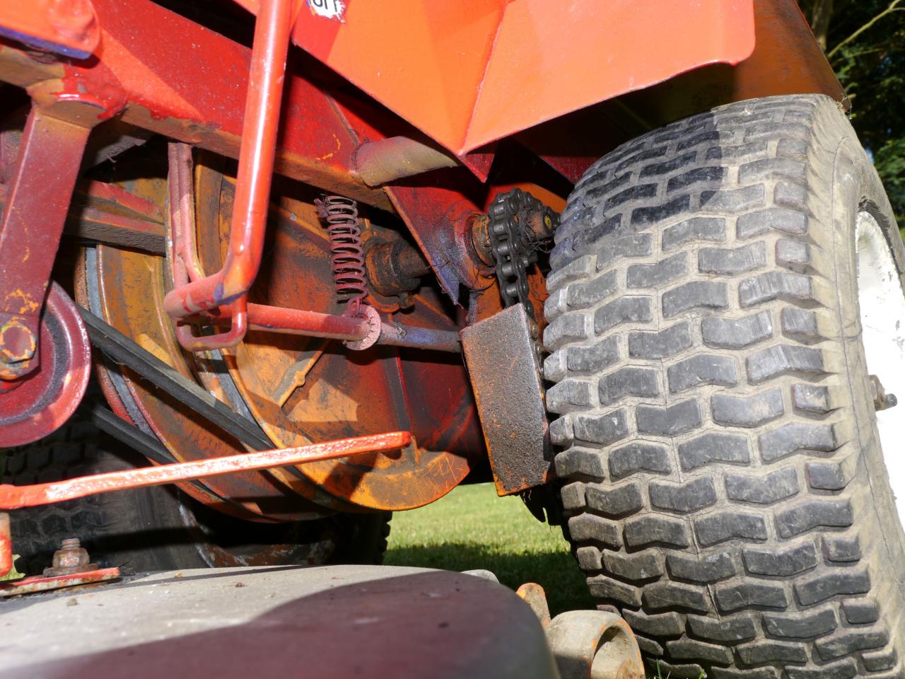

In case you are interested in details, the mower in your picture (which seems in impressively good condition for an old ride-on) has its cutter drive belt missing. Also, in the side view you can see the wheel drive belt running back under the center of the mower, where it runs over the tops of a pair of idler pulleys that raise it to clear the cutter deck's drive pulley when the deck is in its raised position. Just behind those idlers, you can see the wheel drive belt dip down around the clutch pulleys (see area circled in yellow):

I've just taken delivery of the mower, and it's in better condition than I thought it would be! OK it needs a good strip down and overhaul but the bodywork is excellent. On a first look I can't find any numbers on the chassis but maybe I'm not looking in the right place, no doubt one of you will tell me where to look! Numbers on the B&S engine are as follows:

Here are a load more photos of the mower.
I put some petrol in it plus some oil, adjusted the carb jet to 1 1/4 turns, puled the starter about 10 times and she fired up! Runs really well with no smoke and the forward / reverse clutches are fine. I just need to get a cutter belt and I also need to replace the cutter clutch lining as that is non existent.
It looks to be in excellent condition, and for such an old machine, remarkable condition. I am surprised to see that the wheel drive clutch thrust bearing mechanism is assymetrical - I would have expected it to be symmetrical. There may be wear on it, or a modification. Also, your final drive chain looks dry. Perhaps it has been treated with dry lubricant. Ordinarily chains require oil.
There must be a reason for the cutter clutch having worn out. Presumably it has been slipping. You will need to find out why.
