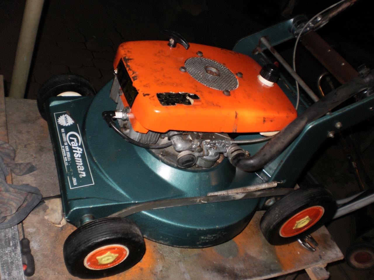

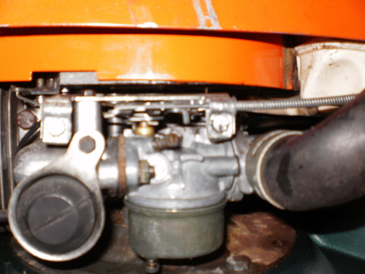

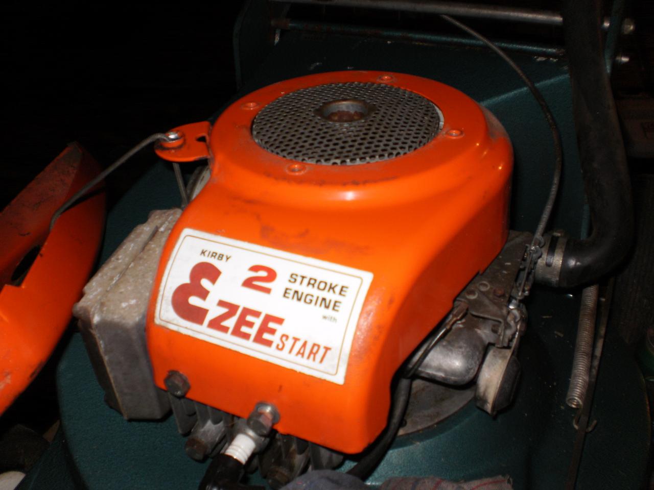

still new to this ! can anyone help with this one ? scored it tonight at the dump and all that seemed wrong is that it was full of oil , drained it and fresh mix in there and a few pulls n off it went woot seems to run well but only at full revs , wnt idle down but stops when you ask it too . was too dark but there seems a lot adjustments on the carb ?? and i think gov' flag is stuck . also would anyone have a catcher that might fit ? 1st one of this type i have ever seen anywhere . thanks Dave
The engine is a Kirby-Lauson 2 stroke, which is moderately unusual, and it seems to be in remarkably good condition for a 40 year old engine. It is a K7, K9 or K11 - the other versions did not have a primer bulb. It appears to have K11 stamped on it.

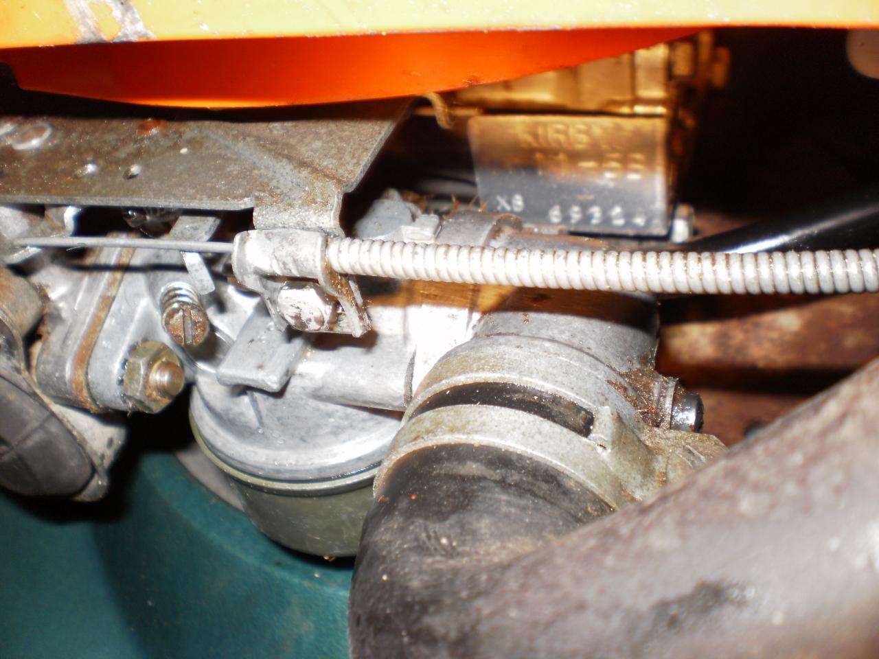

thank you for the help there , the drain also allows all the oil out too !!! hahaha it sure helped get it running . when its lighter more pic's of the carb' its covered by the cowlimg though , see if i can get the top part off tonight its looks like it might be 2 piece . thanks again

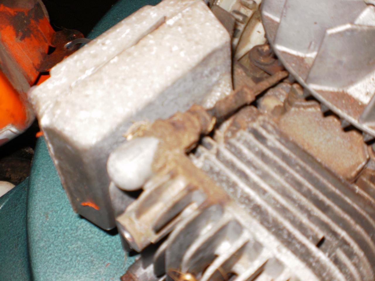

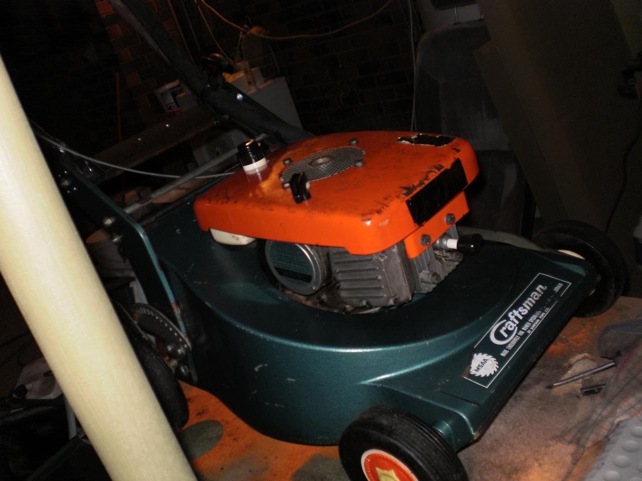

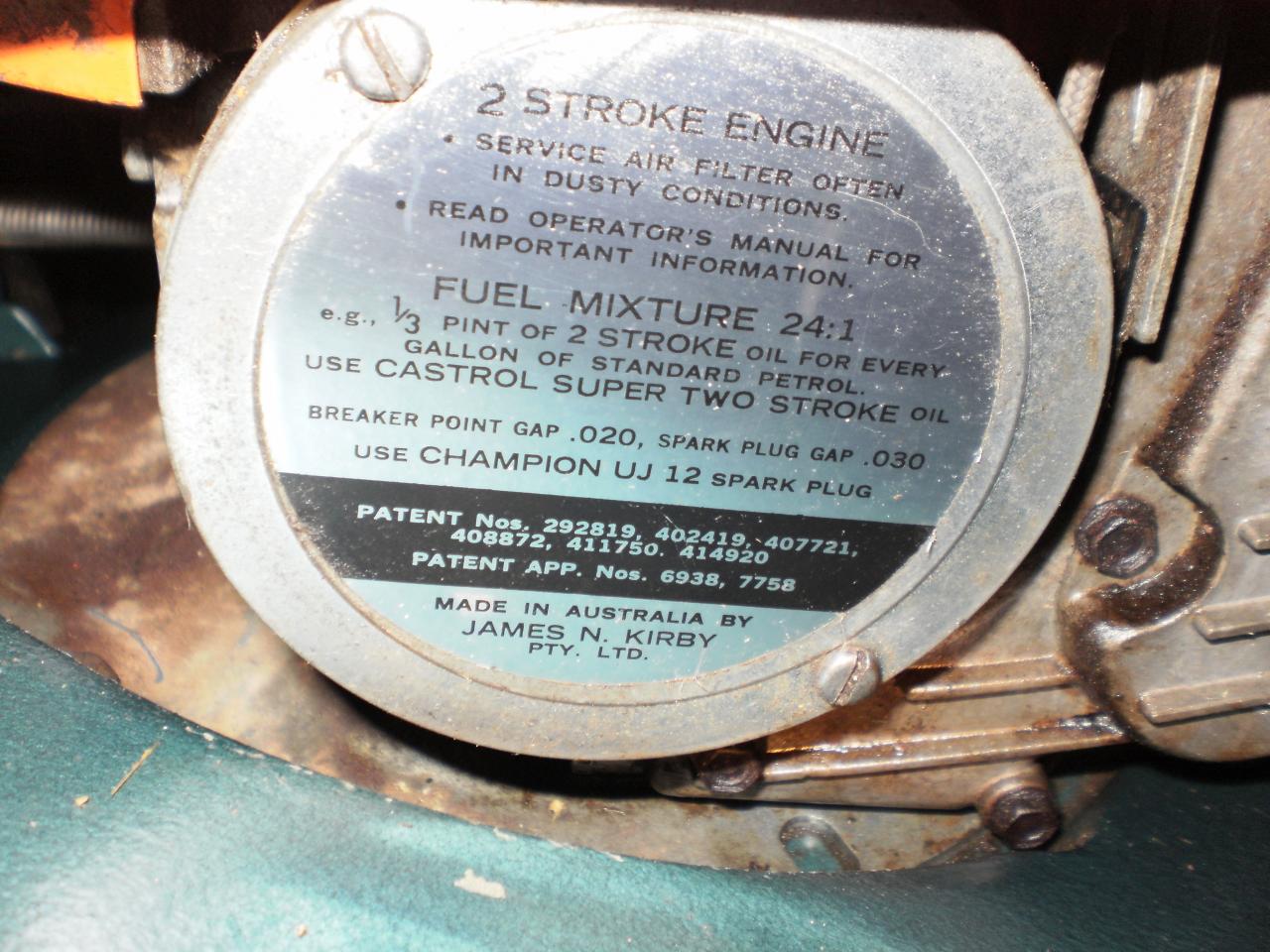

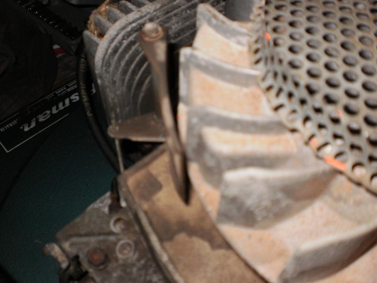

this is as opened , didnt even need to take an airline too it ! hard to believe how clean it is under there . would the rod in the last pic' be decompressor ? works from starter , sorry no better picture of the carb' its not realy broken so no need to break it just yet !!
The second picture shows the governor vane at minimum clearance from the flywheel: it should only be there if the speed control is set on maximum. If it wasn't set on maximum, your governor is stuck or mangled in some way.
When you move the speed control lever toward maximum it stretches the governor spring, and the spring pulls the throttle wide open if the engine is not running. When the throttle is wide open, the vane is close to the flywheel. If the engine is running, the vane is pushed out from the flywheel by air pressure from the flywheel fan, and it pushes the throttle toward closed. With the speed control lever in the slow or stop position, the governor spring is relaxed and the throttle should not be wide open, so the vane should be further from the flywheel.
I can't see a rod in the last pic. The decompressor is operated by a link from the vertical pull starter, which opens a simple valve connected to the cylinder.
it is connected to the starter yes , and the flag was a little tight last night and close to the fan , but seems ok now but a little late to be running it , or is it ? hehehe it was a fast pull apart last night is all , so if i get home early enough i'll try it again tomorrow n seeif all is ok , but it sounded sweet . thanks grumpy for the advice .. Dave and also if i'm doing this in the wrong place ? please tell me
If the governor vane had more or less seized on its pivot, and you've freed it up and oiled it, it may work properly now.

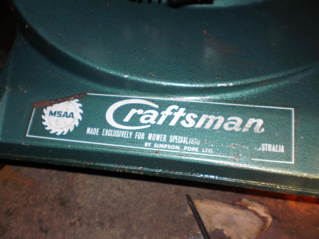

Hi grumpy and vccomm, if you have a look at the first pic in this thread showing the front of the base...it states "Made exclusively for the Mower Specialists Association of Australia by Simpson Pope Ltd." wink
Thanks Deejay. So, it's a Pope that was made for a generic home brand group catering for retailers too small to have their own private brand.
