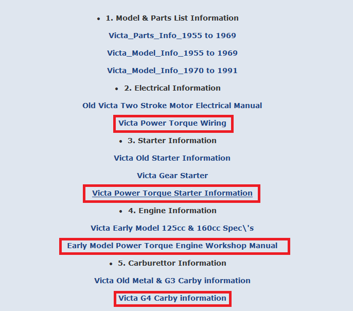

At the present, there is nothing that is written specifically for the VSX-160, this is mainly due to Victa not releasing there service information individually for each engine, as the process for servicing and repairing a VSX160 is the same as that of a V40 power torque, a V30 powertorque, a VE160, V35, V160 or Eco torque engine.
Occasionally updates are added to cover general changes across the board, and I am currently tracking one of those for you.
I have highlighted the documents you will need for your engine, although they relate to earlier powertorque engines, the process is essentially the same.
