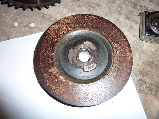

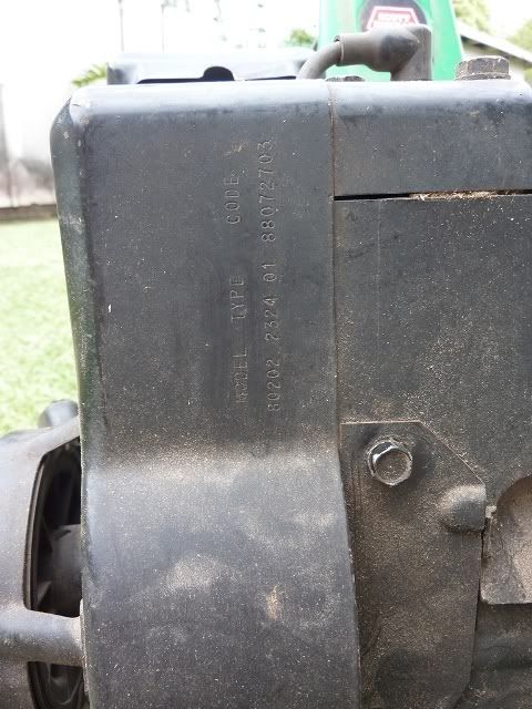

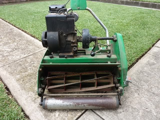

Hi all, joined the forum today, was told to put up some photos of the 45 17" I intend to rebuild/restore.
Was looking for a bit of info on this model, told to put up the code on the B&S motor, it is: 80202 2324 01 88072703. Can anyone help me out with what all that means? My father had a 45 in the 80's, his was painted the darker hammered green with the orange B&S motor, is this one newer than that?
I bought it for $150, told by its elderly owner that it hadn't been started in 5 years and wouldn't start for him. Changed the fuel and oil and it started in a few pulls and purred nicely. Did a test run and all seems operational, cuts nicely and drives well.
I've almost stripped it down to the frame but have come across a stumbling block, the absolute last nut to be undone is the engine shaft sprocket nut. Can't for the life of me figure out how to get it off as I have no grip on the shaft to get it off, can anyone give me any ideas? I don't want to dameage the shaft by using vice-grips or putting it in the bench vice.
The strip down was for the intention of checking everything and to ready it for new paint. I'm thinking that sandblasting is my best option, anyone can recommend a place in Sydney and give me a rough idea on price for the frame, chain cover, and handlebar centerpiece?
Hoping people can give me suggestions as to what to do, I don't need a show pony, this machine will be used, but I want the best result possible.

Hi David, our B&S historian, Deejay, is away on vacation at present but we can make a start with some easy stuff. First, the numbers on your Briggs engine. It is 8 cubic inch displacement (130 cc), is from the first Briggs design series, has a horizontal crankshaft, a Pulsa-Jet carburetor, plain main bearings, and a rewind starter. (The model number tells us all that). It was made on 27 July 1988. If it is the original engine fitted to your mower (which is likely), the mower will have been made between late 1988 and some time in 1989. Being made after 1983, your engine will have electronic (breakerless) ignition.
Your mower's reel (the rotating blades) looks as if it has probably never been resharpened, which means the quite large expense of replacing it is likely to be a very long way in the future. I can't judge how sharp it is, or the condition of the bedknife, from the pictures, but if it is mowing well, things look positive. You seem to have got hold of a good example of the SB45. However you need to inspect the condition of the chains and sprockets, in case they are worn or rusted.
So far as dismantling and painting are concerned, let's see if one of our experienced SB45 owners is available to help. Steve, Deejay?

Cheers for the info Grumpy, much appreciated.
My main problem at the moment is that I simply have no idea how to either get the engine shaft sprocket or the engine shaft bearing off. The shaft goes through the left(standing behind) side of the frame and it's being there is stopping me from having a stripped chassis ready for re-painting. I've attached some pics.

I'll try to go through your questions in order David. First, removing the drive shaft sprocket. I think all you need to do there is hold the shaft from rotating while you unscrew the nut retaining the sprocket. The shaft rotates anticlockwise when viewed from the sprocket end, so the nut should have a right hand thread (cylinder mowers have a sprinkling of left hand threads in the drive system, so always be careful about this). Hold the shaft close to the bearing housing with a Stillson wrench or a pipe wrench of some other type. Remember such wrenches are "handed" - they will only work in one direction, so the teeth bite into the shaft when you unscrew the nut. That means you have to turn the wrench over if the teeth lie on the shaft in the non-biting direction, otherwise you might as well use a file while pressing on the back stroke instead of the cutting stroke. Then apply a socket or ring spanner to the nut, and unscrew it. Your washer under the nut appears to have been bent up to help lock the nut, so you will probably need to tap this down flat to be able to put the spanner on properly and unscrew it easily. After removing the nut the sprocket appears from the parts list to be pushed onto the shaft over a key. Look at the end of the sprocket to see if there is a keyway, to verify this. If there is a keyway, the sprocket may be a bit tight on the shaft. If so you may need a little gear puller to pull it off.

Success! Bit the bullet and used the big vice-grips. slight marks to shaft but will be hidden under engine clutch/flywheel housing.
David, those small marks on the shaft can be further reduced by judicious use of a file, making your strokes around the periphery, not along the shaft. Just remove the part that is raised up above the original level, don't reduce the diameter of the shaft. Once the raised up part is gone, the marks will be quite inconspicuous. However it would be wise to do this after you put it back together, since you may make new marks when you re-tighten that nut.

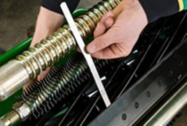

Hi grumpy....this might prove of interest to you....taken directly from the John Deere site...
Special Feeler Gauges
Feeler gauges are used to accurately set the cutting cylinder to bedknife clearance on cylinder mowers. This adjustment is vital to ensure a good quality of cut. Also, if the two parts are set too close then they will make contact, leading to rapid wear of the bedknife and cutting cylinder and overloading the drive system. These special feeler gauges can help prevent injury to the operator. The feeler gauges are 30cm long, so hands and fingers can be kept away from cutting surfaces. The length also aids access for hard to reach places. Two thicknesses of feeler gauge are available � 0.001� and 0.002� � to help operators adjust John Deere cutting cylinders as recommended in the operator�s manual.
Part numbers: [Linked Image]
Special feeler gauges
KJD10551: 0.001� (one thou) feeler gauge. Used for setting up cylinder to bed knife clearance on greens mowers and 22M type units.
KJD10552: 0.002� (two thou) feeler gauge. Used for setting up cylinder to bed knife clearance on John Deere ESP cylinders.
Just food for thought, mate. grin
