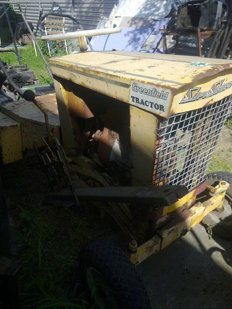

I grabbed a cheap 11XL (rear engine) with a 28" deck last week. Deck is in great condition.
I might look to getting this tractor up and mowing.
I would love more info on it. What model and year etc.

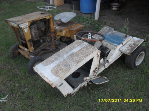

Heres the pics.

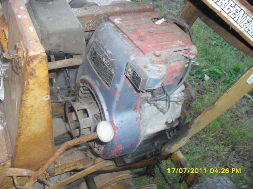

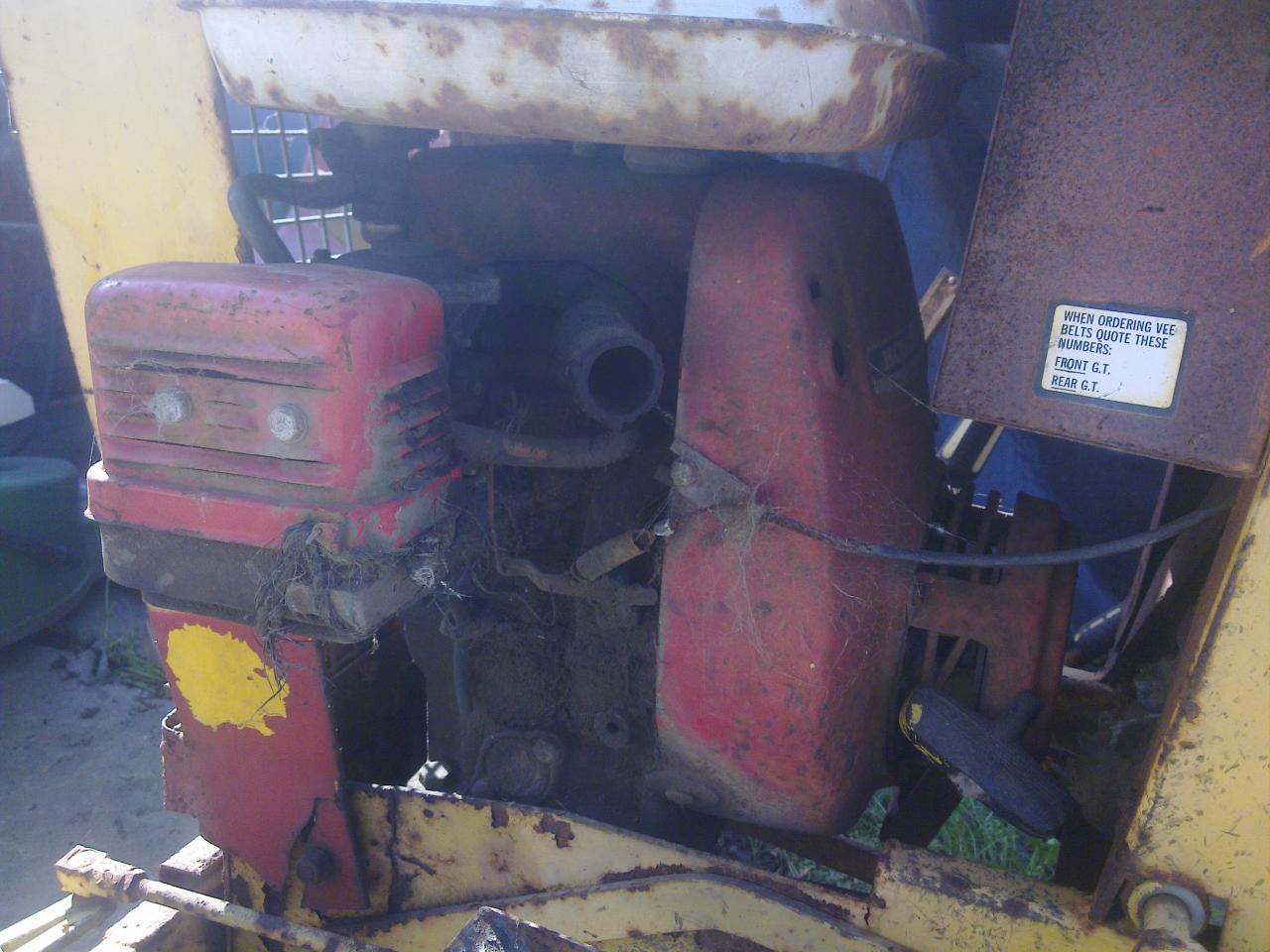

G65 Motor runs. No exhaust.
Top of the tank is rusted pretty bad but i have 2 spare engines.
Pedal for the drive is seized up (hence the bit of wood) need get my hands on a hot stick and try that. Its been soaking for a while and still seized solid.
No seat or bracket.
No pulley etc for the deck belt. Different deck or at least drilled different to the one on the 11XL.
Steering is pretty much seized up. Flat tyre not helping.
Just needs some love. Pretty sure i can make it work again. Not sure if i will bother with a full on restore. Id have a use for it but friction drive is no good for what i want.
Would like to know exactly what the model is.
And a part list or manual would be a great help.
Cheers, Bob.
I can't really tell, Bob, but it looks a good deal like the "Mini Tractor 5 and 8 hp" model to me, though that one had B&S engines. It also looks as if you may have some potentially expensive parts missing (almost the whole crankshaft clutch, for example). Interesting machine, though, I hope you get it going. Some pictures of the engine part of the drive train would be useful for our Greenfield archives - we've only seen the wheel-drive mechanism up to now.

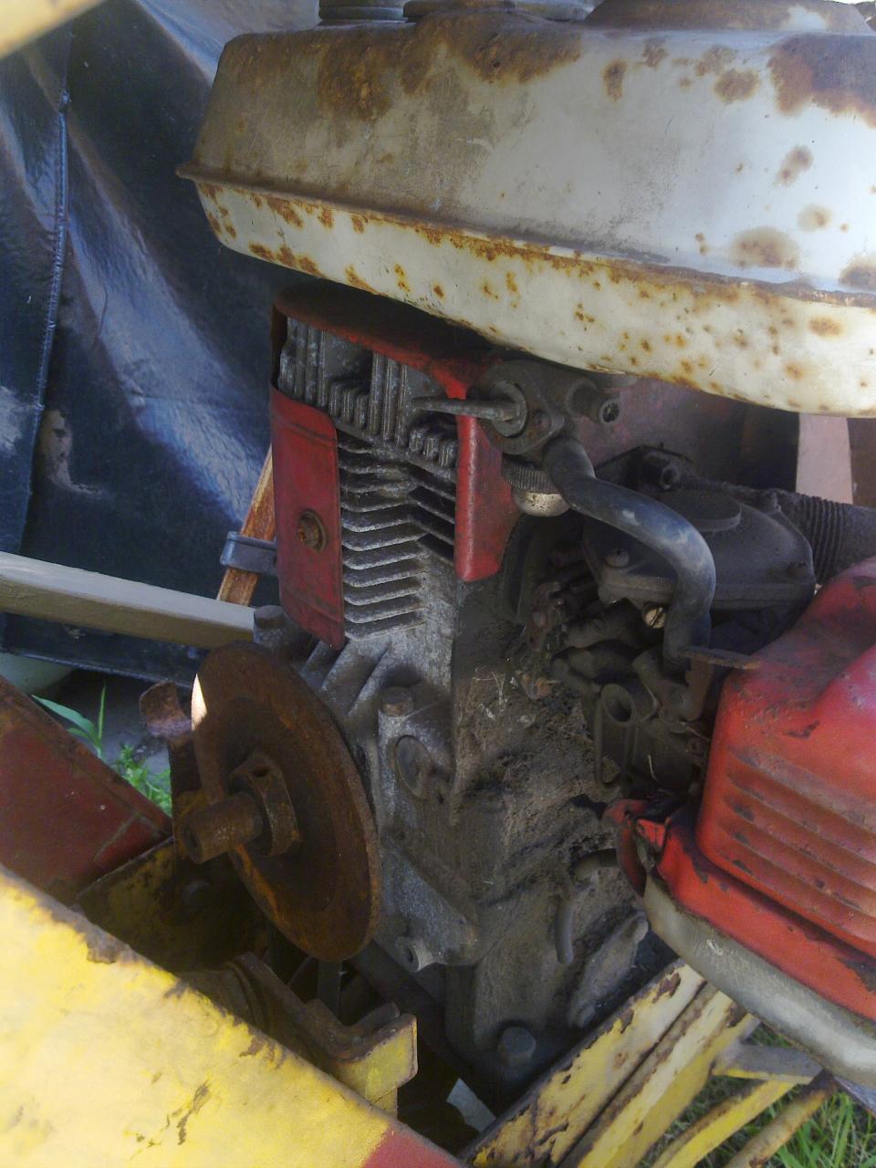

Behind that disc is the Vee pulley. Ive no idea what the disc is there for.
Can see the vee pulley in the pic with the engine ID sticker.
In the pic above you can just make out the belt below the pulley and see the tops of the horizontal rollers that twist the belt so it will travel to the back, up over the drive pulleys and around the idler.
That last pic was taken with the bonnet tipped as far forward as it will go. The bottom edge hits on the bracket for the front axle right on that gnarly weld.
The thing is sure gunna need a lot of love.
If i remember right the lever on the left moves the linkages, so it would be for deck belt tension/engagement. Height on the other side. Luckily all that stuff is there.
If my hunch is right i could just set it up carefully over the 28" deck and drill some holes in the deck and bolt it on. It would just be the front pulley and belt then.
Chain was rusted up, seems to be a bit freer now.
One wheel is loose on the axle, spins, not sure what is up there.
Beauty is that its a little bit agricultural in construction. Making/remaking bits wont be hard and they wont look out of place.
Only hard bits are the alloy parts, rims, steering wheel, seat basin and the steering gears and arm. Got most.
In theory if i can free up that pedal it will move under its own steam. Well gasoline, its not quite that old.
Im not sure where it would fit with the 5 and 8HP seeing as its 6.8HP.
Ive seen pics of one with a G200, i think they were rated at 5HP. Or 4 point something.
There is one similar on eBay in QLD, even has the G65. Bonnet is a bit different. I did message seller requesting pics but no joy so far.

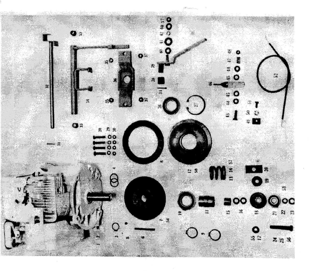

I did download that parts list but its for a Vertical shaft motor.
Im thinking there must be some parts lists for the horizontal shaft tractors somewhere. Perhaps i will have to approach Greenfield directly.
I can't find a horizontal shaft Greenfield in the manuals section either. The mini-tractor is the only one that has a pulley and clutch system that looks like yours, and as you said, it is vertical shaft so there will be some substantial differences.
Contacting Greenfield seems like the best next step, especially if you can quote the serial number of your mower. I find a lot to like in the Greenfield design, at least with regard to the chassis and propulsion system. it would be nice to see yours - an unusual model - sorted out and documented for our archives.

I found the bar on mine, the post is on the opposite side and the bar had fallen down in behind between the grille and lower edge of the bonnet. Im not sure where the lever is meant to be or go theres no tell tale that it was ever there.
Mine still has the belt rollers for the deck (will probably need renewing as will the ones for the drive belt). So all i would need would be the clutch.
Feel a bit silly, i thought the park brake was the deck engage. Doh! looked today after i got the pics and its pretty obvioulsy a park brake.
Only thing thats bugging me is what the lever is on the left on the deck just below the foot rest. I was thinking of a deck brake but its just got a spring on the other end and doesnt even go close to the spindle.
And that motor looks like its not a G65, possibly a G200. It actually looks like its got some sort of reduction or cam drive.

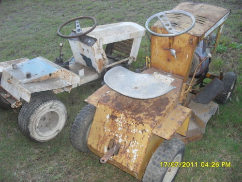

Got the pics of the other one from the listing.
Seek and ye shal find.
Heres one thats on eBay right now. Thinking of having a bid if one of the Canberra guys can pick it up for me.
Little lever and a spring makes the clutch work.

The other yellow one above has a G400 engine i think. I blew the pic up and thats the best i could work out. Strange how the front looks like its not driven off the crank. Perhaps the change of clutch was due to the change of engine.
The Red one is the same as mine.

Im a little annoyed. The old man had a cast alloy Green fields deck at the tip some time back. I told him to chuck it, dont need it.
The red one is mine too.

The red one looks complete to me (except for the missing mower deck, of course). If you get it working, you'll have one to copy to get the first one complete and working.
I'm guessing that the previous tenant of your first buy threw away the whole cutter clutch system when he ditched the mower deck and made it into a tractor. Tenant's improvements, of course. I don't suppose he kept some of those parts did he?

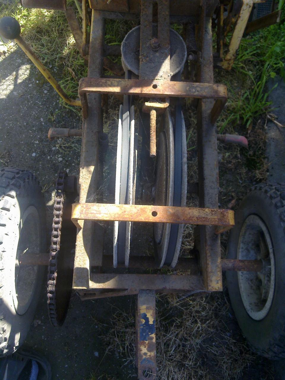

Hi, You asked earlier about the lever on the cutting deck, It is the cutter belt tensioner lever and its an "Over centre lock" type. As you pull it, the entire deck slides on the slotted brackets the deck bolts to and it tensions the belt. I have a greenfield with this type of setup but for the life of me i can't identify the model. Hope it helps.

The Clutch on the front has 2 pulleys. One is constant drive(no Clutch) as this is the drive belt pulley. The pulley with the clutch is for the cutter deck disengage. Mine is the same. I'll post pics as soon as i can.
Joined: Nov 2011
Posts: 4
1st pic is the pulley setup. The next 2 pics are for someone to help me identify the model. Points to note though, right hand discharge not left. Bolt on trailing wheels on the deck not cast mountings. Horizontal crankshaft motor and this chassis was designed for it. Closest i have gotten is that it is a Super HD8 with different wheels and body, except its too long.......
