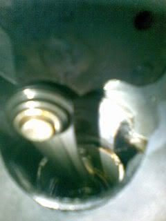

hey gmax, today i got a syringe and the fuel and injected a bit into 3 of the brushcutters except the green ryobi which i have taken the carby off. the Mc culloch 200A fired brilliantly and lasted for about 5 seconds on the little fuel i injected. it has a full tank where im getting the 40:1 mix at the moment but the fuel line is old and crusty so it leaks out quite a bit. im very happy with it. the jonesred also fires but for about half a second without fuel in the tank. the ryobi grass scorpian dose not start up. i have some pictures of the cylinder and crank of the ryobi lawn hornet. there is carbon on the crank so should i be worried about that?
[Linked Image from i181.photobucket.com]

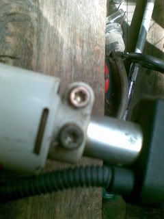

my stihl FS 56 brushcutter has these strange screws. i have tried screwdrivers and allan keys but none of those work. do i need a special tool for the stihl?

last thing, on both of the ryobi's there are stickers that say 77dBa. what dose this mean?

77dBa, is the noise level, the stihl FS 56 brushcutter looks like
it has torx screws, you can buy torx bits from D**k Smith,
They look like these: http://cgi.ebay.com.au/SECURITY-BIT...QimsxZ20080913?IMSfp=TL080913129001r9264
