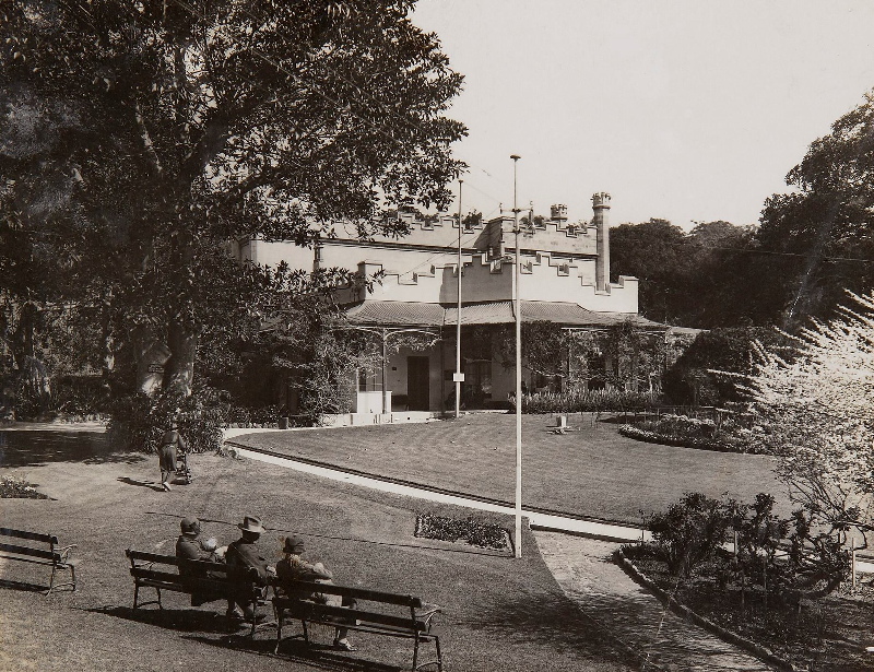

Whenever I look at old photographs and I see a lawnmower, I want to know the
mower's identity. This one was a challenge!
I feel there is real historical significance in it though. I think this is Australia's first power
reel mower
in use at one of Australia's most important locations: a 21" New Moon
lawnmower made by Lark Parkes Limited of Sydney, and in use at the historic
Vaucluse House!
I remember visiting this house as a teenager on holidays in the late 1970s.
The image has been professionally dated to 1926, but the Photograph was found
pasted into an album and captioned 'Vaucluse House 1922.
I think the professional dating is closer ... and accurate.
Source: Caroline Simpson Library & Research Collection, Sydney Living Museums
You may view the Record and enlarge the image here:
http://collection.hht.net.au/firsth...?recnoListAttr=recnoList&recno=47875

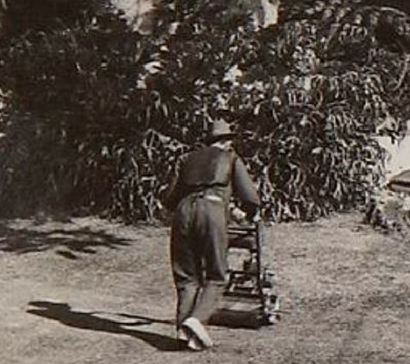

PART TWO - Photograph Identifiers
I am a stickler for fact and accuracy, but I am not beyond best guess and speculation.
I did not rush in to this one; because I recognised the significance of the lawnmower and the location.
It was only recently that I have been prepared to say something.
I have identified this as a very early AUS Lark Parkes 21" power lawnmower.
As you may appreciate, I did not have a lot to work with in identification.
No 21" machines have been found - only a couple of 14" machines.
The larger machine seems to have just been wider than the 14" job.
Evidence suggests the 21" was not self-propelled!
CRITERIA:
I have looked at the mower catalogues of the UK makers, and none of their mowers seem to fit the image.
I would like to list specific identifiers:
- The dating of the image;
- The top-mounted fuel tank and RH brackets (top and bottom);
- The apparent RH alloy side frame;
- The affixed RH crank handle;
- The handle design - cross braces (top, mid, lower);
- The handle grip position;
- The engine position and height of barrel;
- The foot stance and dress of the operator (suggesting push effort).
