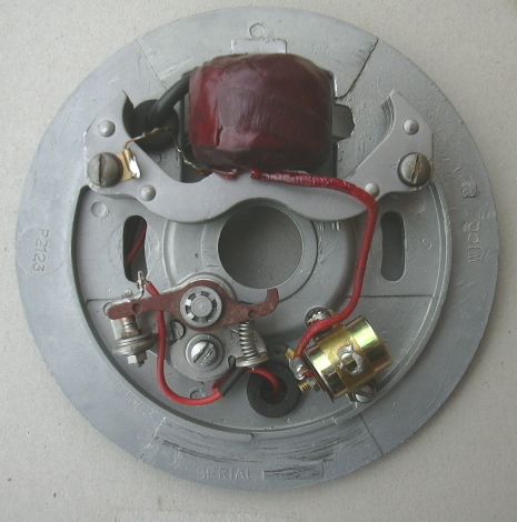

I guess the magneto is this one:
New re-manufactured coils are available from the UK but are wico-pricey,
if you know what I mean...
http://www.villiersparts.co.uk/wip.html
