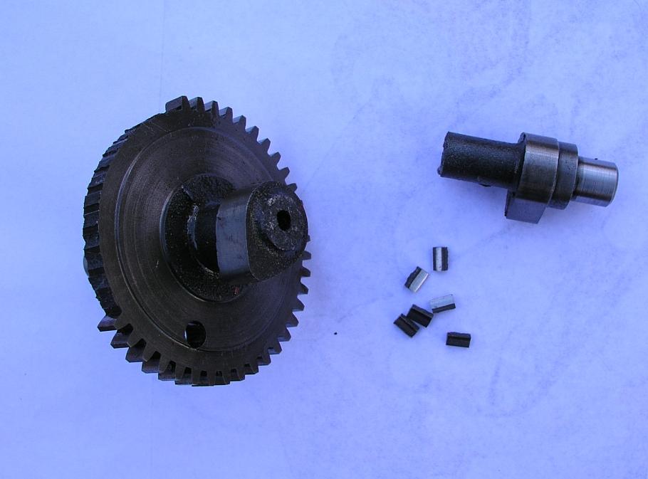

Then began the process of trying to track down the cause. I pondered over the carby settings for a long while. Changed the plug. Cleaned the points, checked for spark. Everything looked okay until I removed the inspection plate and took a peek. The valves were not working when I turned the engine over! So I drained the oil and found two gear teeth in the oil pan. OH NO!!! Then shook the crankcase and heard it rattle! Straight away I new something catastrophic had taken place.
Here is what I found. That metal is as weak and brittle as chalk. No wonder it snapped. I wonder if somebody before me has soaked these parts in acid or something corrosive? Or maybe they have just gone brittle with age.

Jack, The metal on that gear shaft is so brittle you can break it away with your fingernail. I can only guess someone had soaked it in acid prior to me buying it.

I'm not convinced the metal is the problem, over revved engines will do that, something was not right for it to rip all those teeth off

Showed it to a mechanic mate. When I told him how old it is and showed him the state of the metal, he just laughed. "Metal fatigue mate!" came the reply. "Same reason old plane wings drop off."
He reckons all the years of heating and cooling, things being under pressure, then not under pressure, swimming in mineral oil for the past 50 years, it all takes its toll. And considering this is only a very light, porous alloy material ("sh$$ metal" he called it), eventually it got soaked through, possibly following a flaw in the casting that had been there ever since day one, and you see the result. Basically it had to happen sooner or later, and I guess with a reconditioned engine, all sealed up with new gaskets and oil seals and new oil, the extra stresses were just enough to cause it to break.

Yes it certainly is a combination of fatigue and a casting defect. As cast components can last a lot longer than that.

Yes LRT, the metal on that camshaft had turned to chalk, literally. It must have broke suddenly, causing it to go crooked just long enough to strip off the teeth. That is why the teeth are only stripped off one side and the other side is okay. All this would have happened in a couple of seconds.
