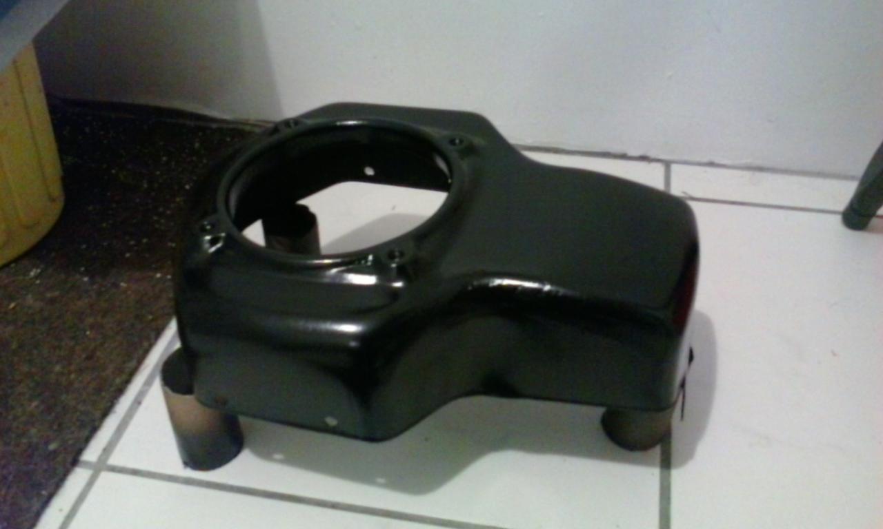

I took to it with an old toothbrush to remove any paint flakes that had lifted and leave as flush a surface as possible before I re-prepsoled the exposed spots and hit them with regular grey undercoat.
I then painted it with satin black topcoat and hope for the best. This one is going on a beater so no biggie. It looks good so far. The next one I do will be with a lot more care and earlier in the day!!
Pictured are the products I used and the finished work I have drying in the house out of the cold!

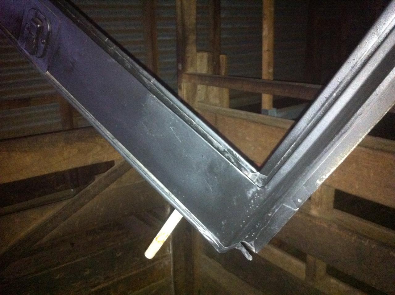

When I repainted the top cover on a customer's Victa 160, I used a heavy duty wire cup brush on 5" angle grinder to remove the old paint and rust and then used it to polish the steel. Then I wiped over the cowling with Prepwash and used Wattyl Killrust Gloss Black paint. I didn't use any primer nor filler to smooth the rust pitting as it wasn't a full restoration and would see regular use.

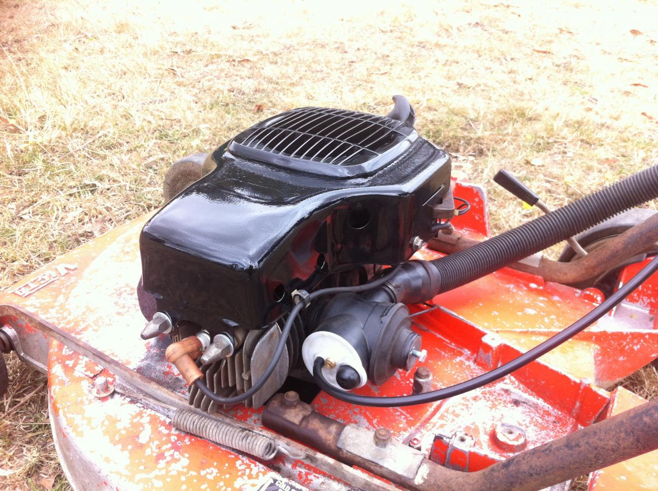

I have that as well. I tried out on the cowl that goes on my Victa Twin ( as it is mostly obscured by the plastic dress cowl) and wow, you could have a shave from the mirror like gloss.
That is what prompted me to go for a more subdued finish as I think extreme gloss contrasts too much with the plastic dress cowl as it sticks out the side.
In the case of that side pull above without a dress cowl, it looks very smart and enhances the whole machine despite the shabby paint on the base.

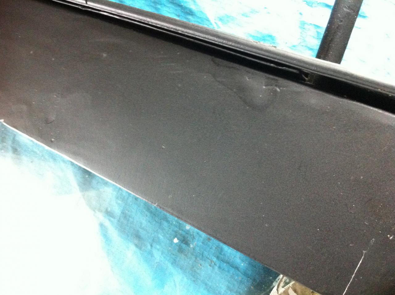

Yes the Killrust takes ages to dry. When I worked at a Case IH tractor dealership, the trick was to use a hot air gun to speed up the drying time. However, you have to be very careful not to overheat the paint as it will bubble. I've also used the Killrust Matt black, which dries quickly. However, it is probably too dull a finish for what you want.
This is Killrust Matt black on a door top from my ex Army Land Rover. [Linked Image]
