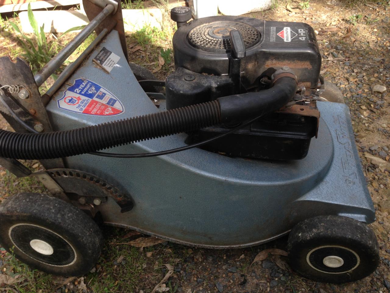

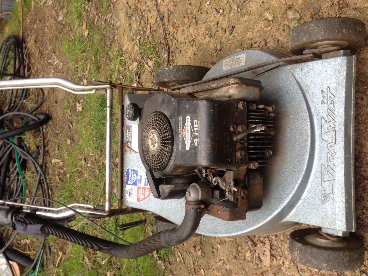

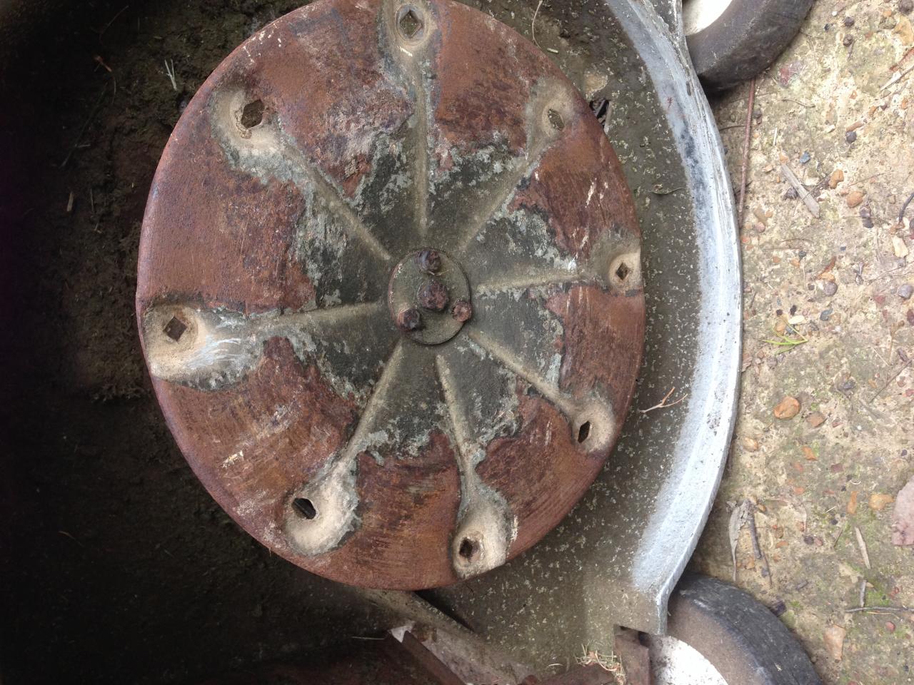

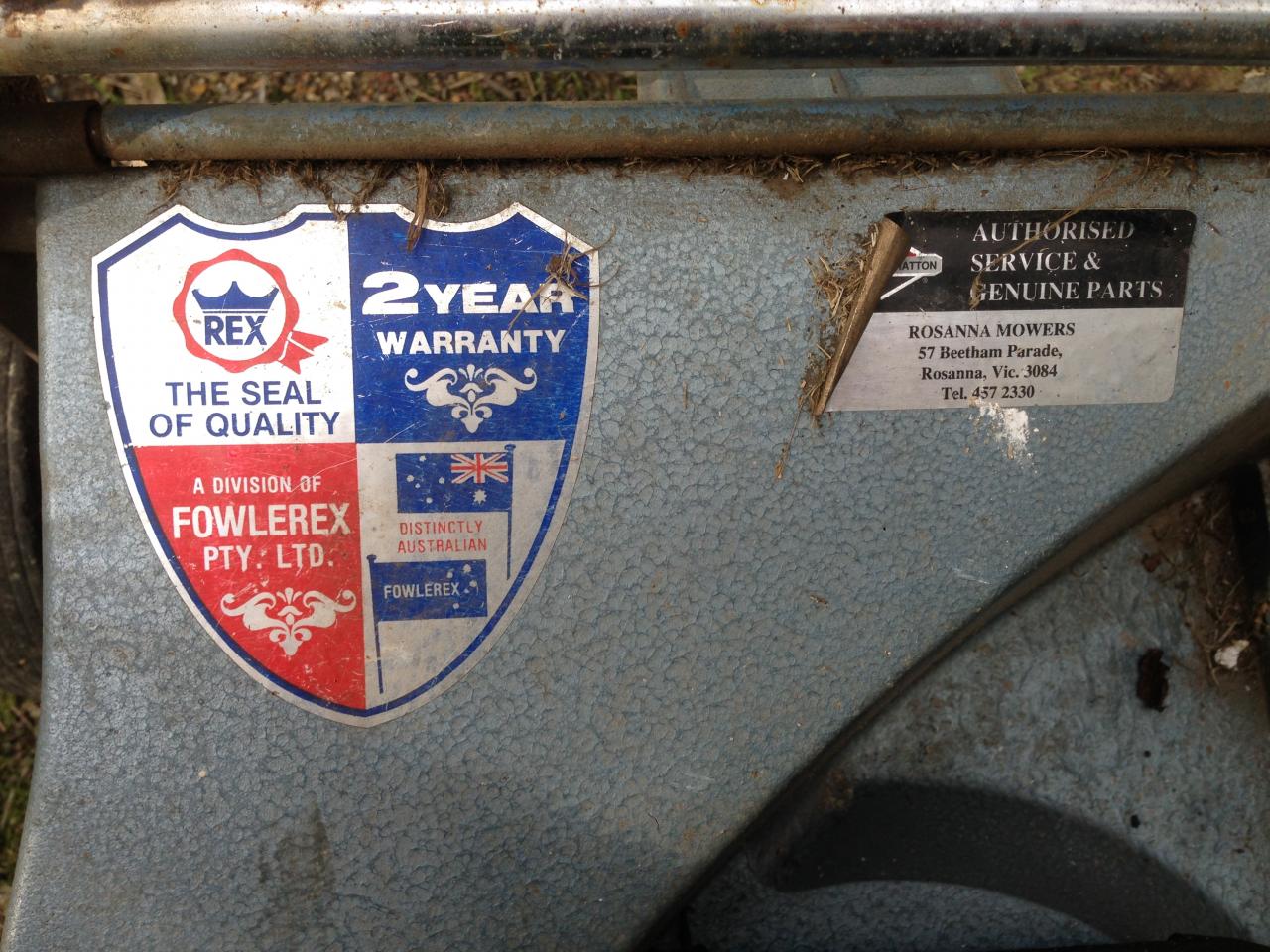

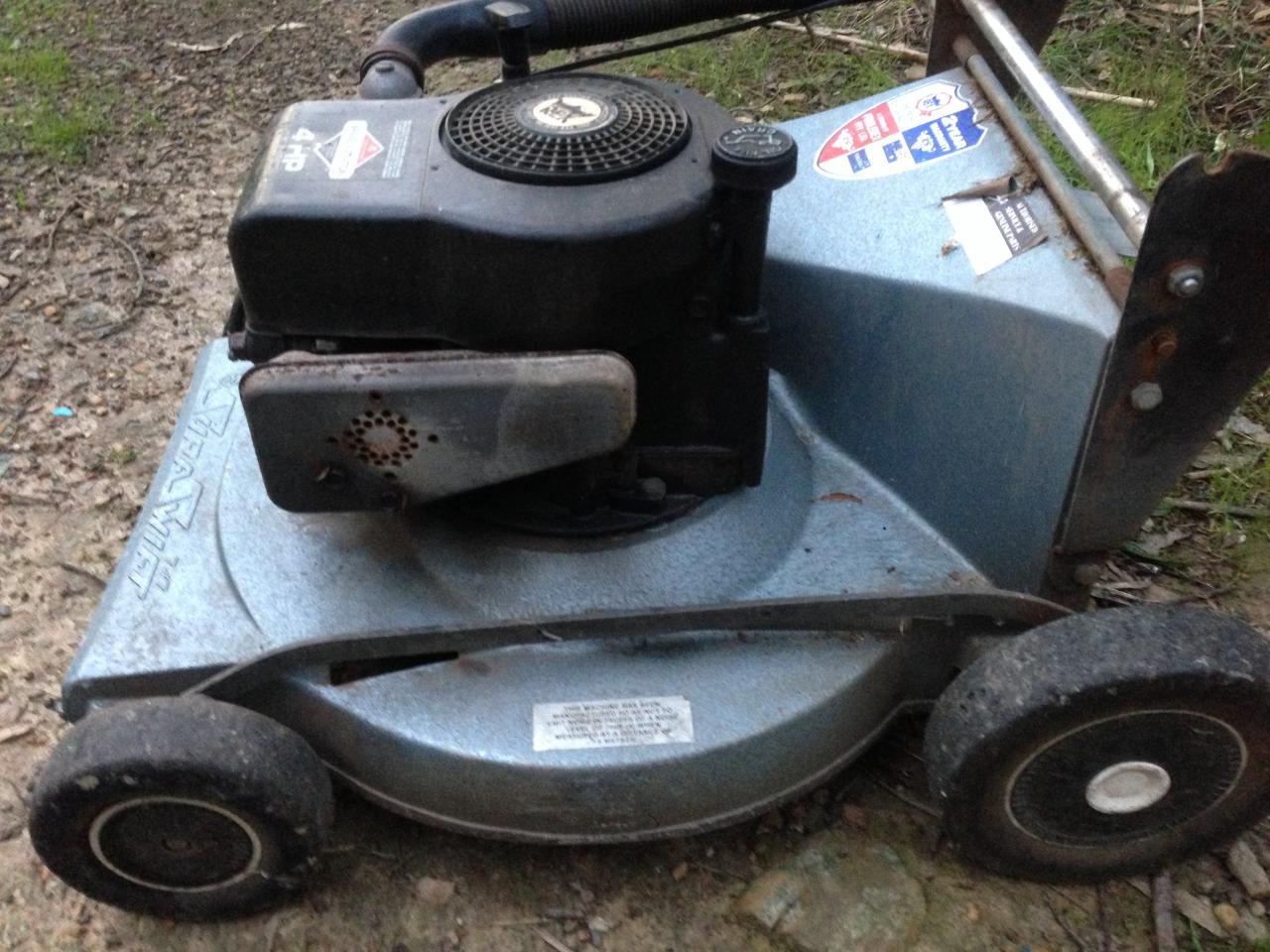

I found this Rex Supaswift 747 mower dumped in the car park of my kids' primary school. Kids want to do it up for their Mum. Love this as it fits with teaching them to fix and not just tip and buy new but...
Can anyone help me with what model it is and where I can buy parts? It started no problem just with adding some petrol and a little in the air inlet. I'm near Nth Ringwood in Melb.
Also some advice please. Is this beyond a basic bush mechanic? (I can change oil, bolt on blades and plugs, clean carby bowl perhaps but beyond that... not really) If so does anyone here want it? I'd be so happy to see it go to a good home. I'd hate to tip it. Happy even to deliver to anywhere in Melb within a reasonable arc of Ringwood to Eltham
Also I'm not sure if it suits as their Mum only needs a tiny mower as her lawn is only about 4m2 and ideally light and easy to start. This mower does need a bit of a hefty pull. There are always more free mowers on nature strips!

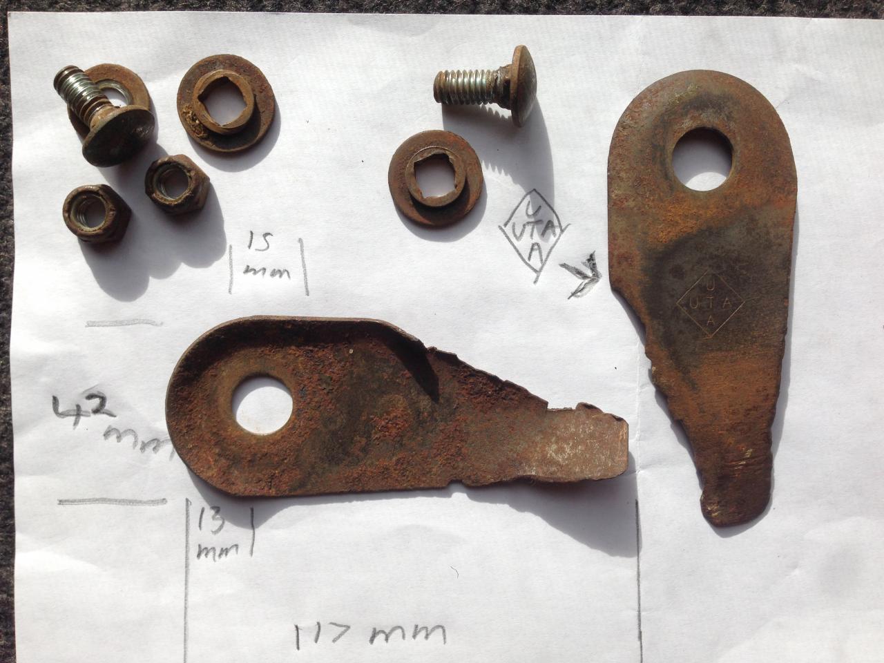

If I repair it the first thing it needs is some blades. But I can't find anything like them on eBay or Bunnings. So if you can point to good sites or places for parts, especially blades that would be great. The existing ones, branded UTA, are in very bad condition. ( I don't want them anywhere near my kids!) See pics they measure (approx 1mm margin for error):
length 117mm
width 41 mm
The have 15mm dia round hole to mount them which is about 13mm from the end of the blade
The bolts have a square 1/4 or perhaps 5/16 section on the shank which matches the inside of the mounting flanges that allow blades to rotate. They are "cupped" at the mounting end.

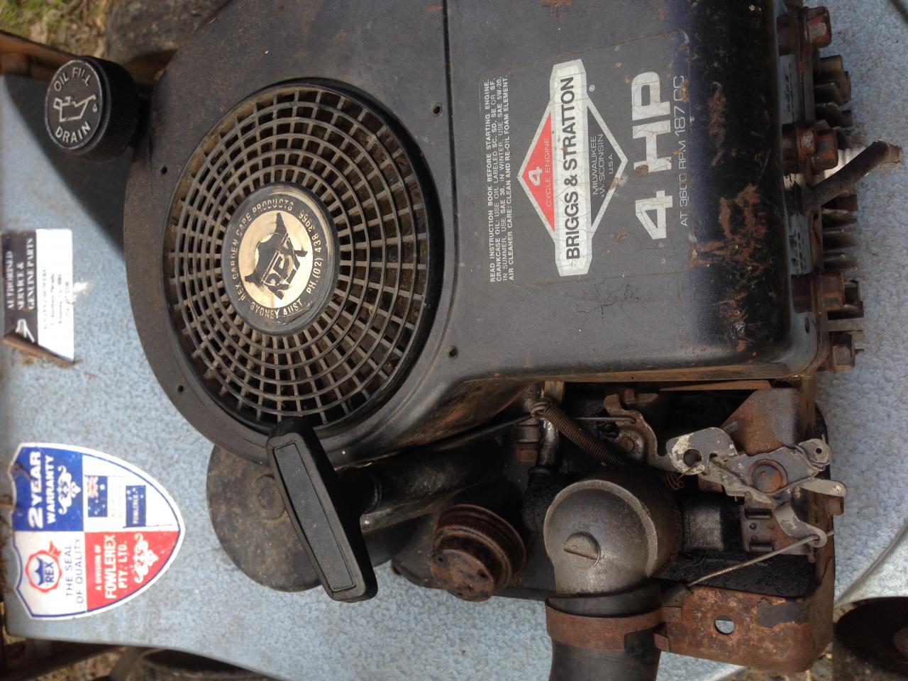

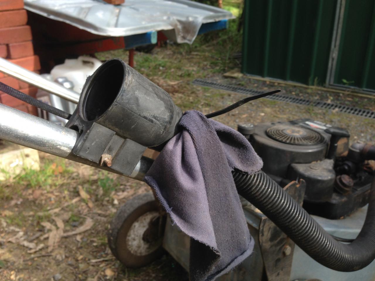

It will also need a replacement air cleaner housing but I guess aftermarket on eBay? Can I use for a new plug anything that fits a B+S 4hp engine also via Ebay?
Thanks for your help!
Regards Nick

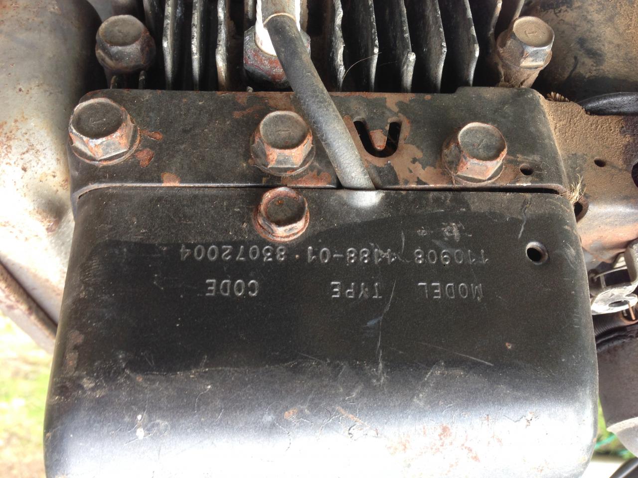

Ok sorry first post and the B&S engine number pic has flipped? So you don't have to read upside down it is:
MODEL TYPE CODE
110908 1188-01 83072004
G'day Nick-S
This is a new one on me - Fowlerrex Supa-Swift.
It is a modern iteration of the Supa-Swift Hi-arch.
The blade holder and blades are not Supa-Swift.
That is a universal blade holder with UTA blades.
Try https://www.gaspares.com.au/
However, my first call would be to:
Rosanna Mowers
Contact details
(03) 9457 2330
They should be able to tell you whether the holder and blades
were original fitments.

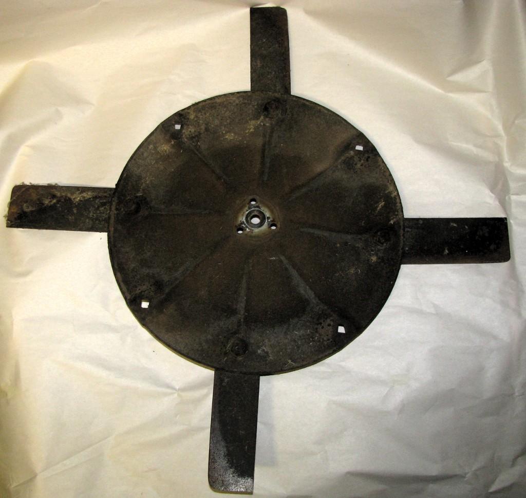

Supaswift actually did use this blade plate type; it's identical to the one on my 1985ish Big Bob, which I know to be factory original.
As it happens to be off the mower ATM, here's a pic:
Blade and bolt sets are available from the ODK Online Shop; https://www.outdoorking-forum.com.au/lawn-mo...-swing-back-blade-bolt-set-900174-900173
Edit: And UTA is owned by GA Spares; it wouldn't amaze me if they were SupaSwift's OEM supplier.
But wait and see if any other parts are needed, before placing an order - postage is the killer.
Your engine is an 11 cu in, made on 20 July 1983. So it has the Magnetron electronic ignition, rather than contact points. One less thing to have to service!

That helps heaps re blades. I did try Rosanna mowers but seems they are gone. No website and only found one place that listed them with that number but 03 9457 2330 is disconnected.

Ok thanks heaps Mr Gadge
I think you have found the exact blades. That raised part of the profile fits with the damage to the existing blades. And most amazingly they list the exact model! Thanks for the link to the ODK shop. That is great to be able to buy from here.
Looks like blades is the only part they do sell though for that mower. I'll get a sparkplug from them if I can. Then look on ebay for non oem aircleaner. But that still keeps it pretty original.

To me that air cleaner hose and assembly looks like it's off a Victa 2 stroke which uses a paper cartridge filter and for that one it looks like it would be the small one. Though missing the top unless you have that loose somewhere.
Yes, those blades were originally a Turner design; that turned up flange is a unique design feature.
