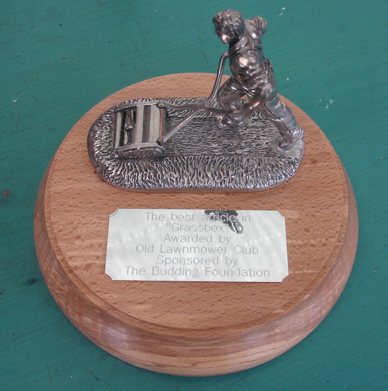

It was a surprise that this article received an award from the Old Lawnmower Club
for the best article from their magazine, Grassbox, for 2017.
The trophy is an award sponsored by the Budding Foundation:
http://www.thebuddingfoundation.co.uk/
The award was a big surprise!
