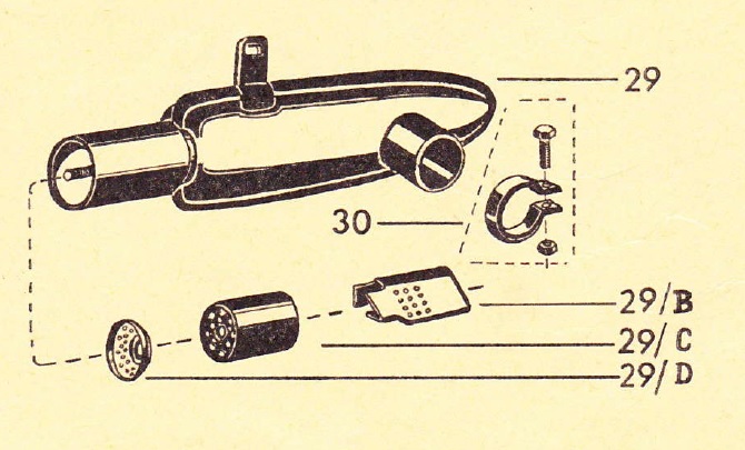

As I have found in recent months both the Viceroy models 505 & 517.I'm just trying to piece together the parts that are missing for them to be complete.List goes as.
1.Mufflers need two,one for each I'll add a picture of the type I need.

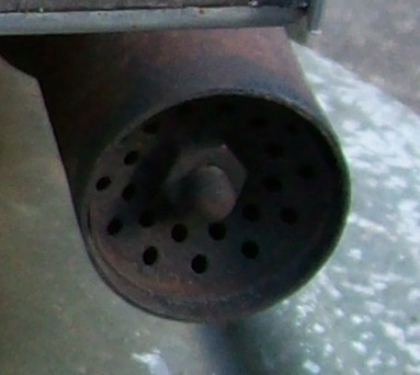

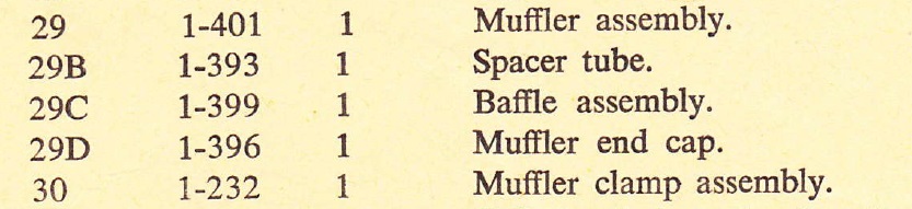

OK after having a visit with a friend and checking some parts I have.I have found some of the parts I needed.Now all I need is the mufflers.Even if it is just one as I have one that has the baffle missing but I'm thinking there could be a way of making a replacement.So if anyone has a muffler then please let me know.
Thanks.
Posts: 693
By baffle do you mean the disc with the holes? Because you can buy domed discs like that from most spare parts places and you could then just drill the holes. I can't remember what they are called but had to buy one for an old B&S two piece carburetor.
No by baffle I mean baffle.Your thinking of the end cap.See pictures below.I'm not sure you would be able to anything quite like that it is a fairly thick gauge of steel,but in saying that I'm sure re-manufacturing an end cap wouldn't be too hard to do.
