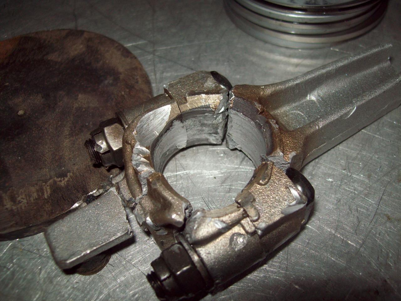

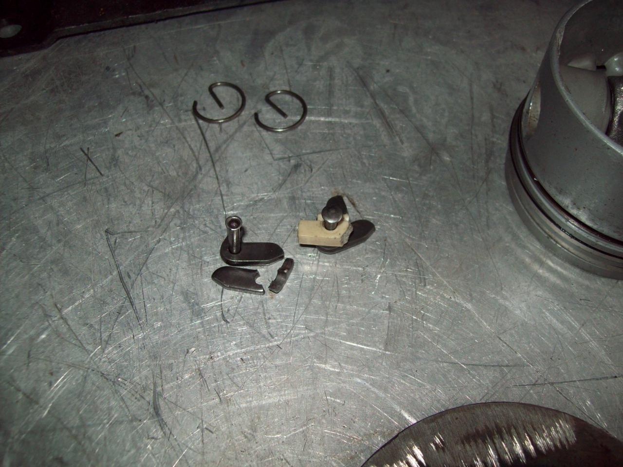

Here is the con-rod assembled on the bench, but as you can see, it is not ready to work because it is broken into several pieces.
The little end is still on the gudgeon pin in the piston.
The governor was also in the box, but part of it's mechanism is broken.
All the other parts are present, but by no means ready for reassembly! A challenging restoration job will be needed using hard to source OEM and aftermarket parts. I'll keep you posted as I am keen to make this rare engine run again.

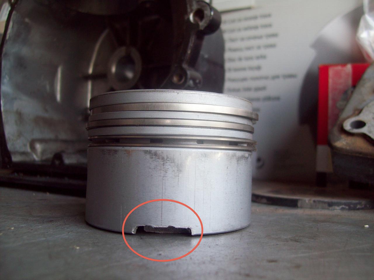

Is the crank case punctured? Looks like something violent went on in there.
Joined: Jun 2013
Posts: 407
LRT
Offline
Surprisingly the crankcase isn't damaged. There is only a small score mark. See the red circle in picture of the crankcase.

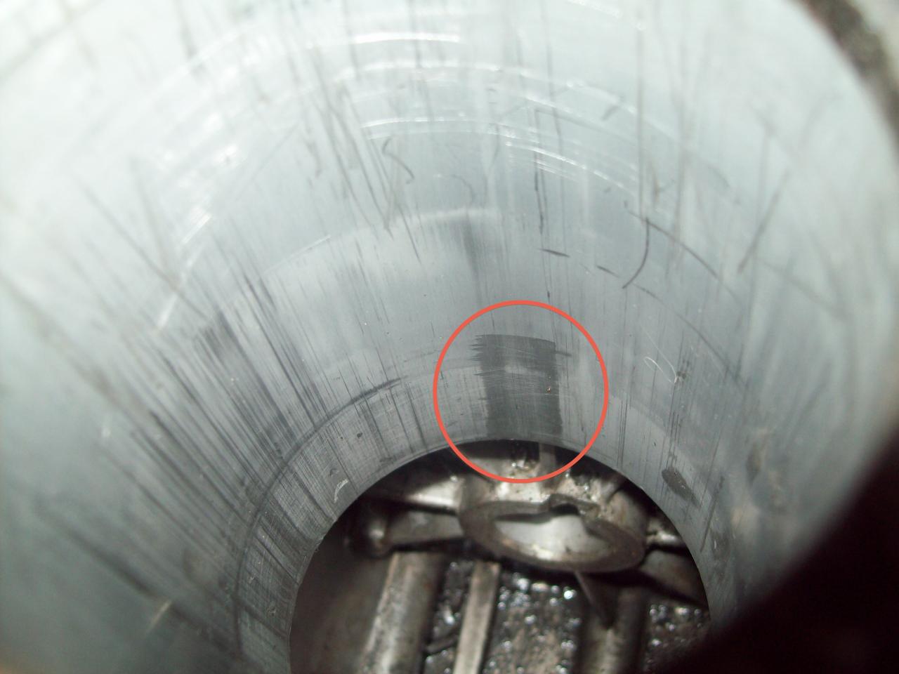

The bore is only lightly scored where the broken con-rod scraped the cylinder wall. See the red circle in the picture of the cylinder bore.

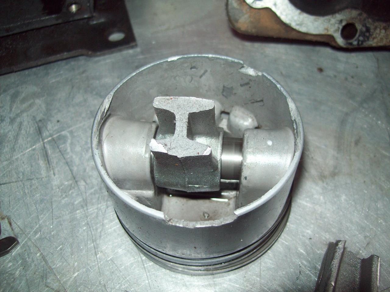

However, the bottom of the piston skirt is damaged, but none of the rings are broken even though they are loose and worn. [Linked Image]

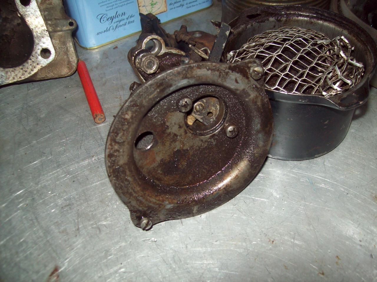

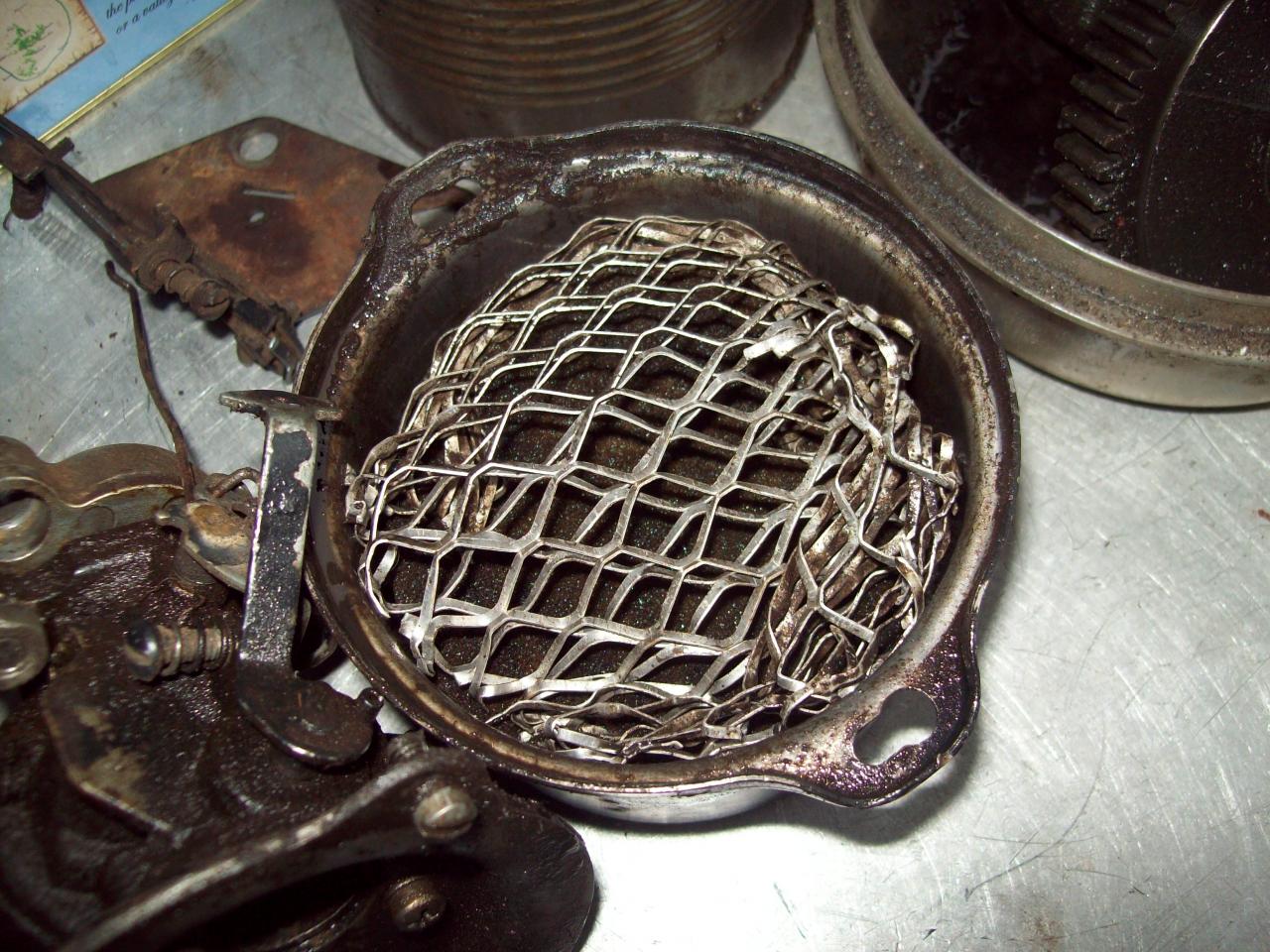

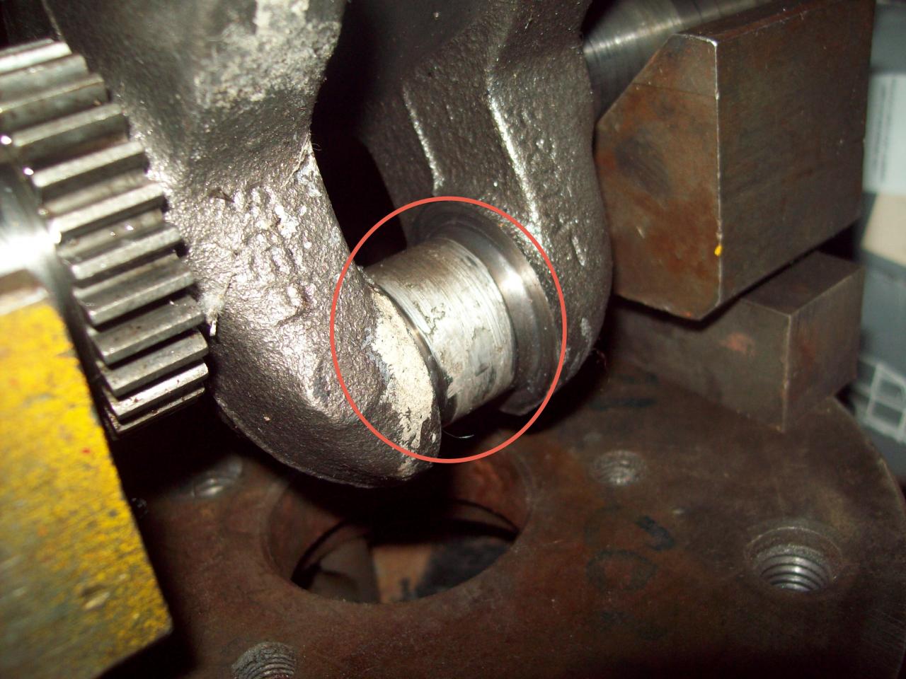

The state of the carby's throttle butterfly and the home made air filter suggests abrasive ingestion and abrasive wear failure as the likely cause of engine failure.

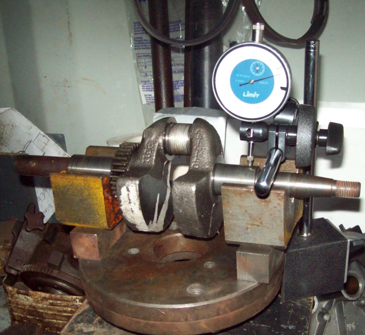

However, adhesive wear failure due to metal transfer from insufficient lubrication is evident on the crankshaft main journal. Despite this damage, the crankshaft still runs true on the magneto and PTO journals.
