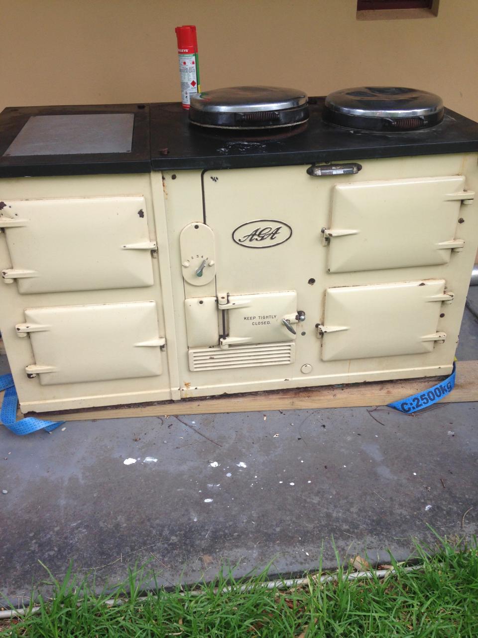

I'm now well into the easy part of restoration on this old timer(the pulling apart).
Information on AGA cookers is very difficult to come by. Some conspiracy theories include limited information from the company in order to keep prices high and second hand units out of the market. Certainly I got a very negative reply from the company when I asked for assistance.
No longer a pommie company, AGA has been bought by the Americans apparently, but information was never prozletised by the company anyway. Detailed information on Youtube for example, is soon taken down (for various reasons).
A new 4 oven cooker will set you back $39K or better in toady's money.
I've been able to approximate the date of this particular piece to between 1941 and 1945 and she probably came to Australia around 1950 and settled on a station in NSW. I was able to obtain ownership when foreign interests purchased the land and were not interested in what was, in effect, our history.
If anyone is interested, I now have a # of photos that give some detail in how these things work. I hope to have this going again for 2017 Christmas dinner.

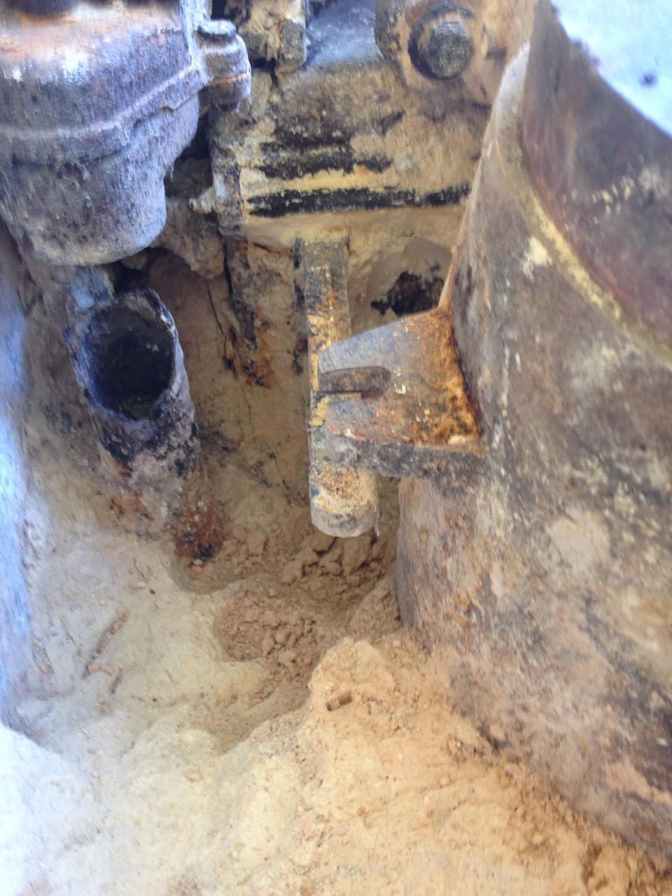

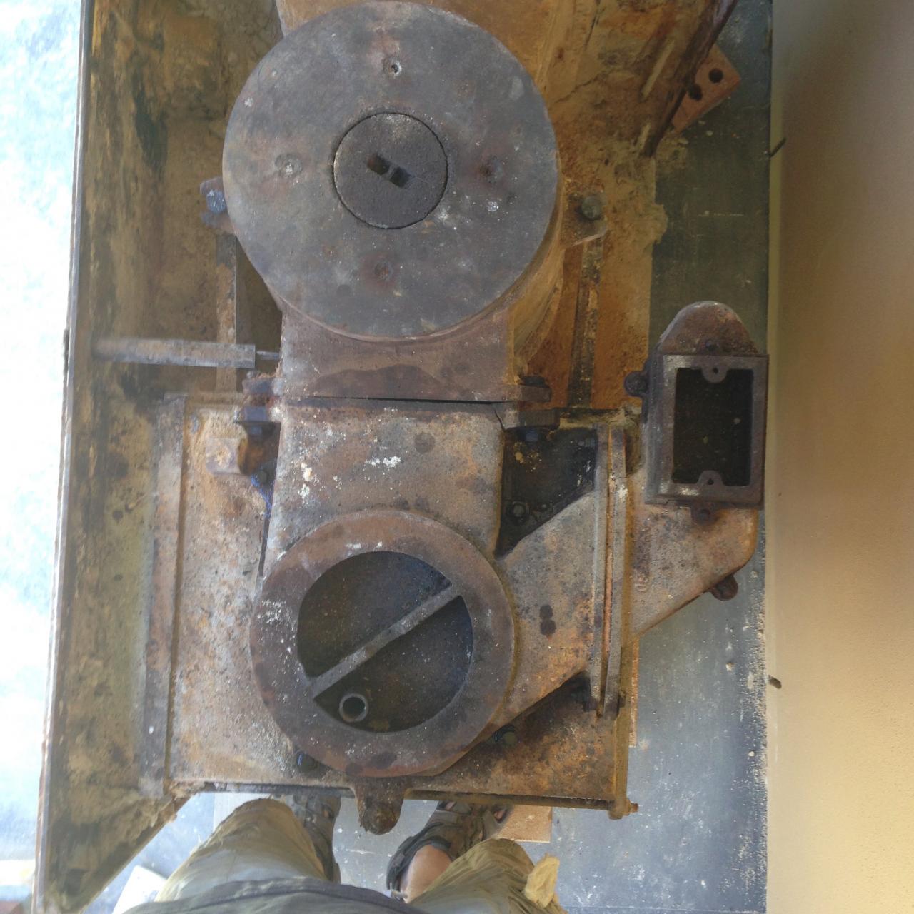

The reason for the advice on care in moving these things, particularly the 4 oven cookers is that the RH ovens and the furnace are joined, with the furnace sitting on a couple of leveling "feet" which are easily dislodged, causing the furnace and ovens to separate and the cast to crack & break off. I can see that this sort of thing could be construed as major, but in reality its simply a bit more work to remove and weld. We're lucky these days with the technology that is at hand.
The 4 oven models can easily have their "back broken" when the LH side becomes detached from the right while moving. You can see the join down the side of the left ovens. The chassis is also in 2 pieces and this is the weak point. Gadge the 2 oven that you had is all but the same except for this LH addition.
My cooker is a model E standard and is a solid fuel type ie. coke or coal or hard wood. The problem I discovered is that ( I think) she had burned soft woods and the air breather was chocked & completely blocked, however I have been able to manufacture a new exhaust pipe so that problem has been overcome (I hope). She must have been a bu##@r to light and keep going because she wouldn't have been able to breathe.
Anyway, thanks for your interest and the helpful comments. While in the midst of restorations, times can be frustrating and lonely & its good to share.
The photos below show the blocked & broken exhaust breather pipe, & you can see where the bolts or leveling legs should be at the side of the furnace & this has caused a separation of furnace & ovens. Thankfully no big deal, but it does require some additional welding, which is the current stage of proceedings.
John A
aussie

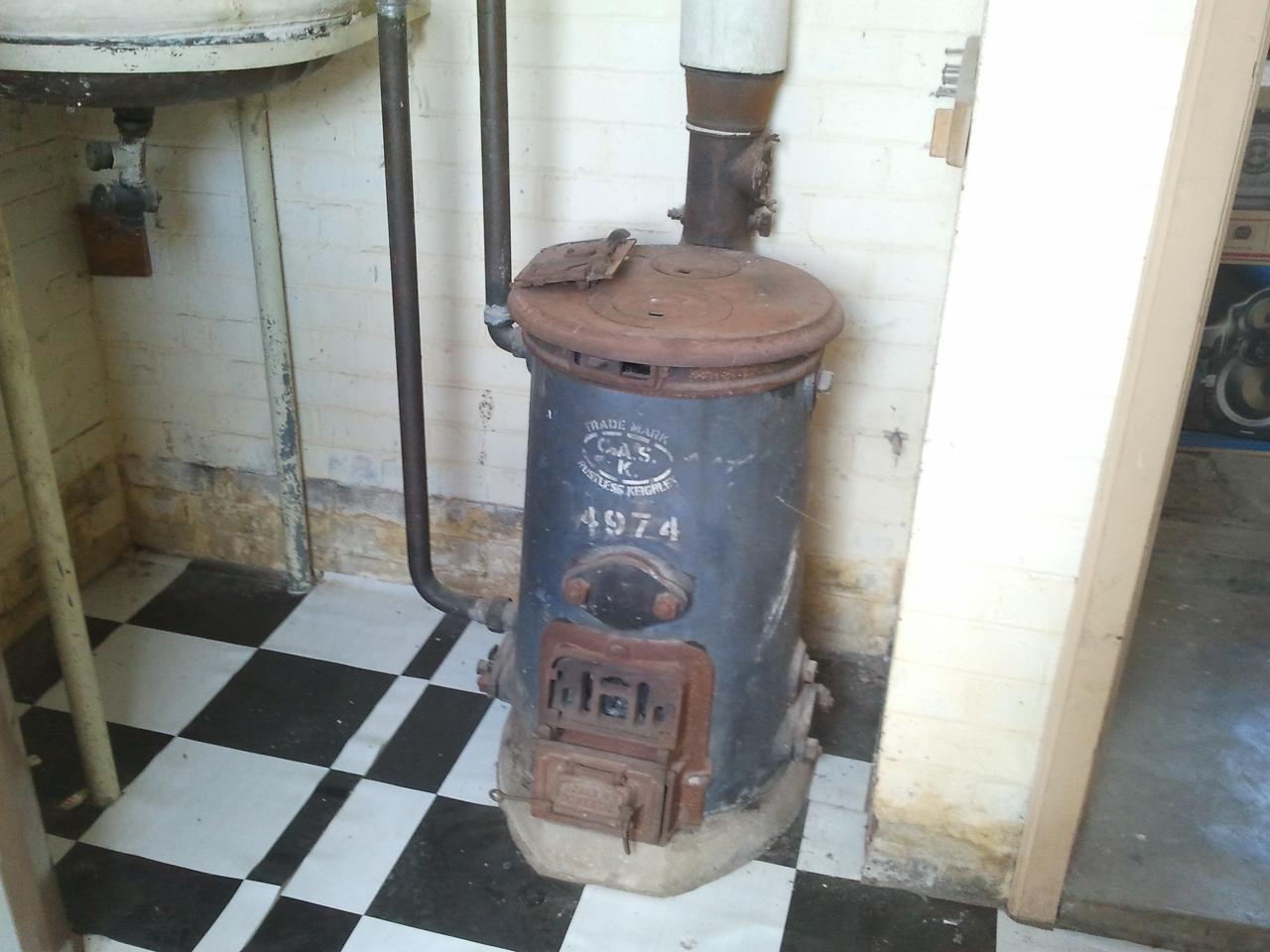

It'll be an easy job to replace that insulation with vermiculite, compared to digging the old Kieselguhr [aka diatomaceous earth] stuff out!
Some of the old solid fuel AGA's weren't suitable for use with wood, as the coke/anthracite furnaces were smaller than the wood-fired ones. The Brits may not be aware of that. Hence the oil conversions here.
The AGA in the Benambra homestead didn't have a wetback, so it didn't need to be run for hot water.
That was heated by the old wood-fired cast iron 'donkey boiler', which used very little wood.
One of these:
A half hour burn would have the water in the main tank boiling. It was a gravity feed system, with thermosyphon circulation through the boiler.

Well, that one I've pictured was most correctly termed a 'donkey boiler' or 'hot water donkey', back in its day. It is a 'recirculating water heater', driven by the 'thermosyphon principle', and operates at 'gravity feed' [i.e. around 3 metres water gauge] water pressure. A lot of people confuse the terminology, these days. See below for what a true 'chip heater' was. wink
That donkey at the Benambra homestead would take reasonable sized pieces of firewood, but was still very efficient in its wood consumption per volume of water heated. It was hooked up to a 40 gallon [~180L] hot water tank, which would easily stay hot overnight, after the donkey had been fired up the previous evening, even when the outside air temp got well below zero, by Oz standards [i.e. double figures below zero, Celsius].
The donkey and main tank were located in an enclosed rear veranda, so weren't fully exposed. This was intentional design - so that the water in the pipes wouldn't freeze, despite lagging.

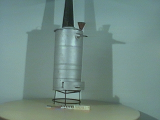

This is an actual 'chip heater', used to heat bath water;
Pic credit: Newcastle City Council's Collections, http://collections.ncc.nsw.gov.au/keemu/pages/nrm/Query.php
'Chip heater' because it needed to be run on small, fast-burning pieces of fuel. Chips, twigs, pine cones...
It was run by filling it up with water via the funnel visible in the pic [in the Wandiligong cottage, there was a tap connected to the house rainwater tanks positioned over the funnel], then lighting the fire. The heater is not pressurised at all.
When the water started to boil, it would spew out of the outlet spout a bit. Then you would run cold water into the funnel [which had a dip tube on it, that ran to the bottom of the heater tank] to displace the hot water out, via the outlet spout.
I used to love the 'choofing' sound that thing made; very like a steam locomotive! yay cool
