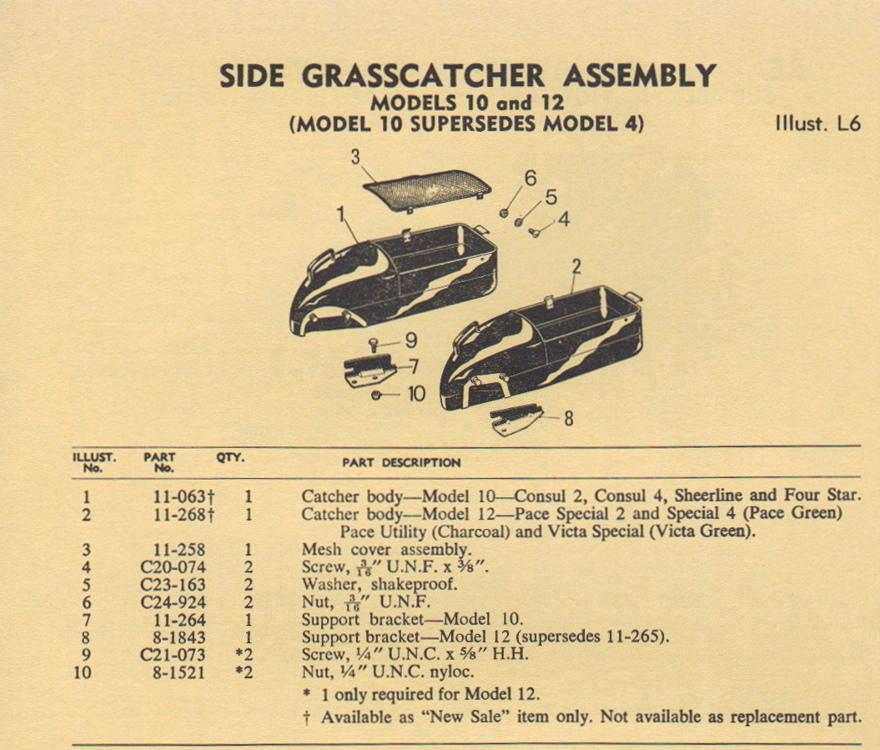

PART TWO - PARTS LIST

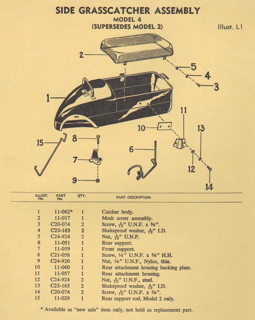

Parts lists can be revealing; but they can be deceptive too.
My 1972 Green Book covers the general use of the design.
The earliest reference is to the Model 4, that replaced the Model 2.
A close reading of the parts list suggests that the Model 2 [and Model 1?] had a
support rod (item 15) to the handle, because of the weight of the catcher and
contents. The Model 4 removed this. Perhaps it was deemed unnecessary.
The revisions of the catcher appear to be the Model 10 and Model 12. These would
have fitted later models � the Consul, Pace Special and Special 4, the Pace
Utility
and Victa Special.

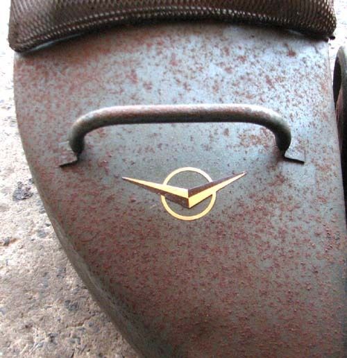

These auction images appear to be of a Model 4 Catcher.
There is no support to the handle...?
NOTE: the beautiful Victa transfer of the day.
