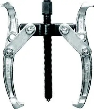

I assume you a talking about a this sort of puller:
[Linked Image from ae01.alicdn.com]
I dont have one.
Is it mandatory or can be done any other way, I can see an pin that if rusted ho be holding the clutch

Hello Pedro
Yes, that's the sort of thing, but Mallet taps on the housing
should be all that is needed. I will ask Mod BB for his thoughts.

You need to use a 3 Jaw Puller to get it off the PTO shaft and not use a hammer at all.
