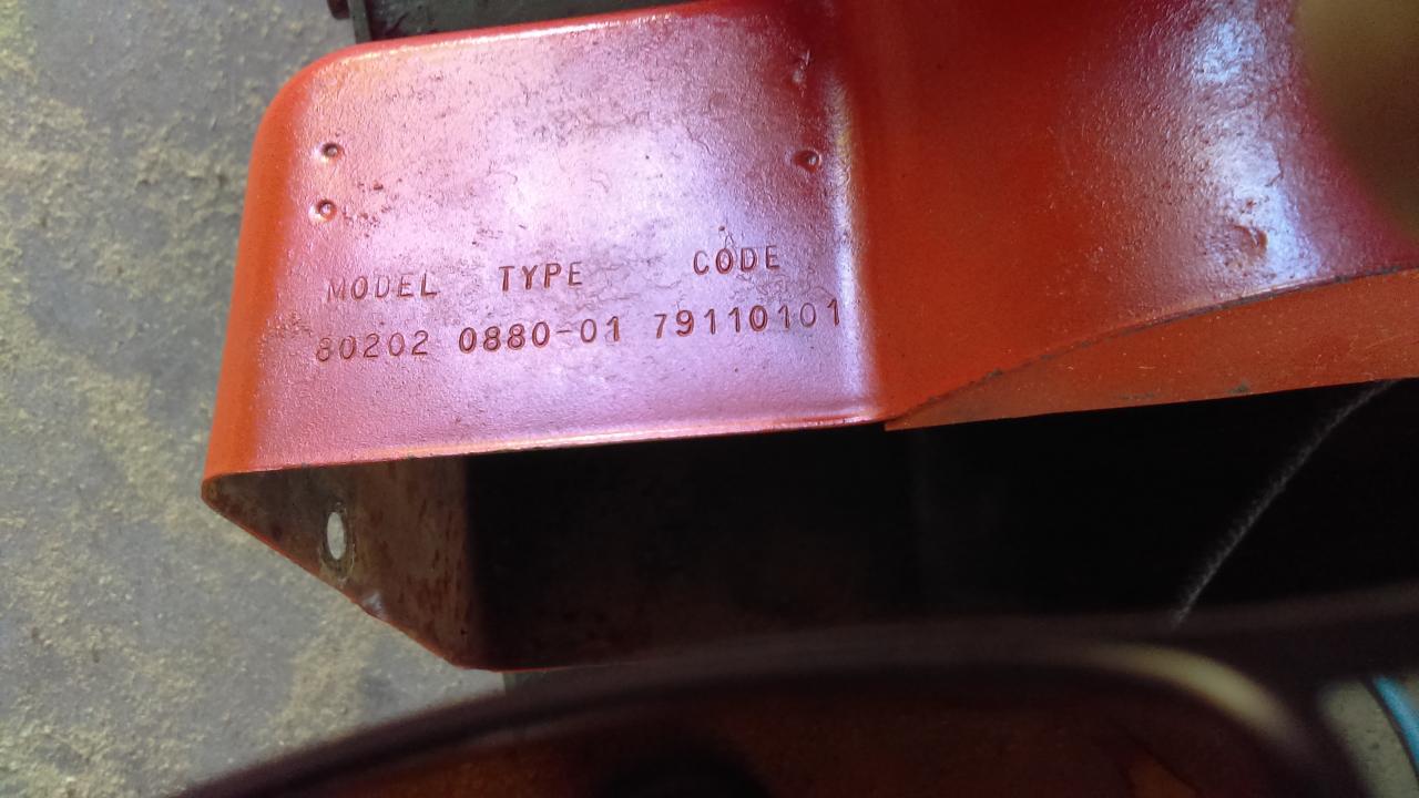

Recently picked this up planning on restoring it can any one give any information on it thanks in advance.
Joined: Feb 2017
Posts: 129
Hi Captrusty,
What you have there is a Model 33 which was the precursor to the Model 45 so this makes it a 1960's issue as it's not the Lawn King variety. The Model 33 was a 16 inch wide cut machine. This one no longer has its original engine as its been replaced with a 1979 Briggs and Stratton 3 Hp engine.

I dare say I'll stick with the Briggs for now can always swap it out at a later date if I trip of something more suitable. Managed to get it running briefly today before I pull it down gave up when the rope broke. Got it 98% only missing a belt any idea where I could find out which size I'd need ?
