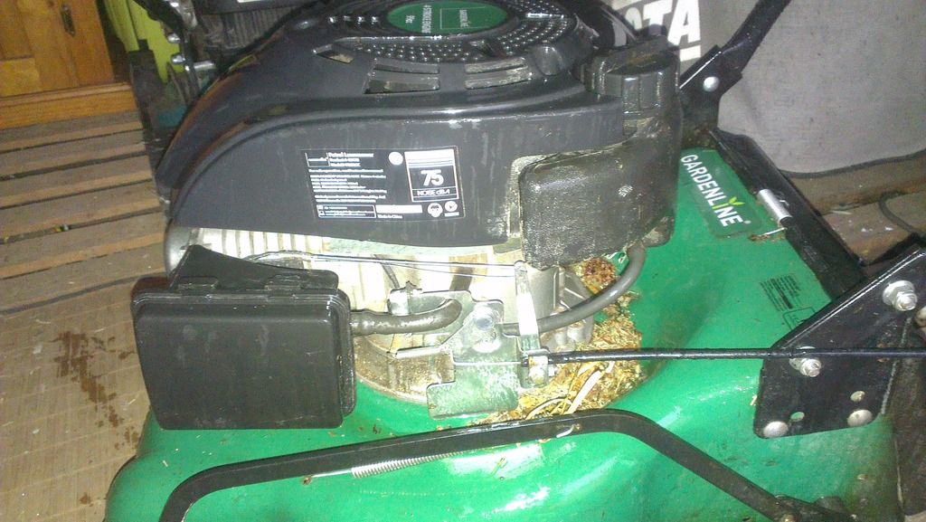

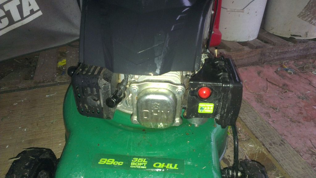

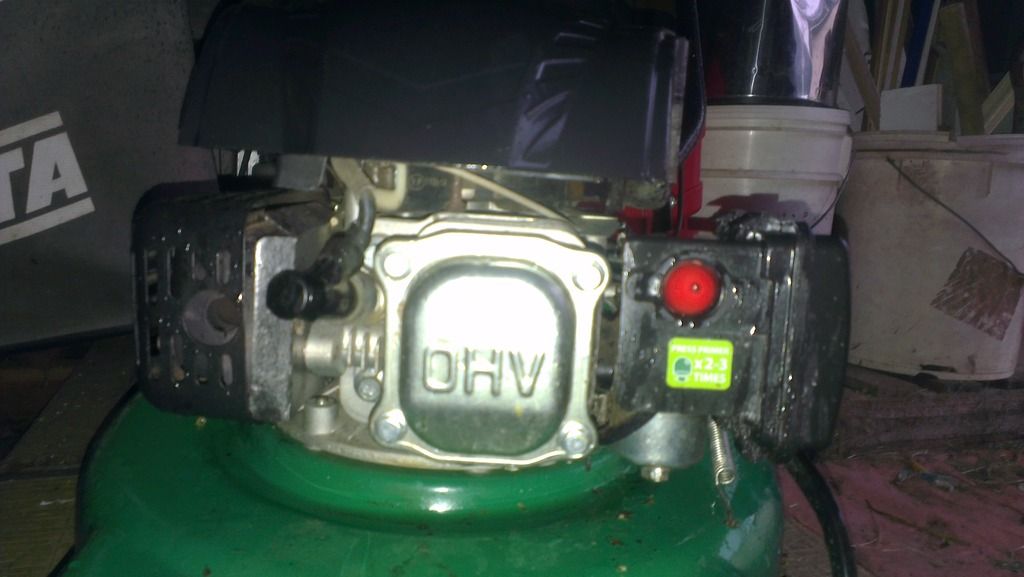

Hey guys,
Came across this gardenline mower but can't figure out what engine it is. I('m guessing as the mower is a cheap mower originally from ALDI I believe, I'm thinking possibly a HONDA clone?.. though it looks a lil' different than my other HONDA clone... any ideas ? Would like to get a parts diagram for it before I start working on it.

Your correct it is a copy of a Honda and we call them Chonda's.

Thanks Blumbly :), ant idea which HONDA series/model it's a clone of ?
Posts: 8,215
Widget,
I don't think anybody knows or cares as to what model they are a copy of, they are just lumped together as "Chondas" and just a disposable motor. If it doesn't run, clean the carby, if that doesn't work, put it in the bin
+1 to NormK.
This doesn't appear to be an exact copy of any Honda model, as Honda hasn't made any ~100cc OHV vertical shaft models AFAIK. The closest Honda would be the 118cc GXV120.
For valve clearances, the GXV120 specs should be OK to use [0.15mm In/0.20mm Ex].
In any case, the Chondas generally only copy the core engine; the ancillaries like ignition, carby/air cleaner and linkages, muffler etc. are often quite different.
