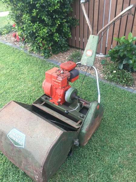

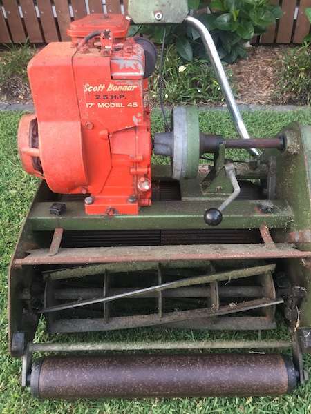

A couple of pics of the 17"... please excuse the beat up catcher. It will need to be replaced. She's past a panel beat me thinks...

The 17 inch machine has been used as a battering ram and not a lawnmower it seems. That would have to have the flattest front I've ever seen on any Scotty.
Now with that one I'm not sure if that's it's original engine as it looks to me to be an apple green 45 and that colour didn't come out until around late 76 and your mowers engine appears to have been made on the first of October 1975 which would mean the mower itself would've been made around late January early February of 1976 and at that point in time the machines were still being painted in Alpine Green (darker green) and with a black chaincase and handlebar shield.
So the Jury's out on this one as it's not conclusive.
As far as the 14 inch machine is concerned you've left off the vital 7 last digits of the engine code so that can't be dated and also some photos are essential to evaluate it.

I will get some photos of the other machine tonight and see if I can see all the numbers. The photo I took in the dark the other night didn't allow me to see those vital 7 digits.. The catcher has had some home panel work completed clearly. The corners had rusted out and as a fix it looks like someone folded in the corners and added a couple of welds. I assume the lack of metal meant it flattened out to take up the space left by rust.

Normally it took around 3 months from the Briggs plant to the customer in Australia, that being Scott Bonnar. Now being that your engine was built in early October 1975 that would've made it late December for delivery to Thebarton in Adelaide. Then one must consider the Christmas Close down from around 23 of December and over most of January, things would've been slow at that time of year, thus I'd say the mower would've been made (assuming that engine is the original unit )around early February 1976.
I must say the photos are not that good lighting wise and it could still be a Alpine Green unit as the sun is making it rather confusing, but one thing is for sure it should have a black chain case and shield for that era and not all green.
Pentagon Logo on the catcher is correct.

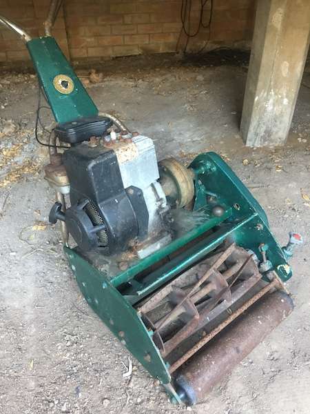

Some more images of the mowers. In different light to see if that changes your view of the colour. The chain case does look as though its been repainted. Where paint has chipped you can see black underneath. So this could ring true to your comments BB. Although, the shield is original in colour, so perhaps a retrofit.
The rough as guts 14".

I'll have to say that the green is a real odd ball green and I was actually wondering if it's been repainted some years ago as it's rather knocked around. I feel that it's been through a mower shop some time back and been spruced up as the black chain cases and handlebar shield looked hideous IMHO.
The era that the engine was built is concurrent with the 2.5 Hp that was used around early 1976 as just after that era they changed the engine to a 3 Hp and fitted the restyled handle bar with the lower kink in it.
So all in all it may be a rather original machine bar the paint on it.
Now that 14 is ugly indeed, again we can't really pinpoint the date on that one as the air cowl seems to have been changed along with the air filter housing. Maybe you could scratch the black and see if it's got much the same silver underneath as the fuel tank and the engine block.
Regardless it is a Series 1 model 45 and was fitted with either a 2 Hp, 2.25 Hp or the least likely 2.5 Hp engine when new. It looks as if it's missing it's main drive chain tensioner which you'll see once you open up the chain case.
