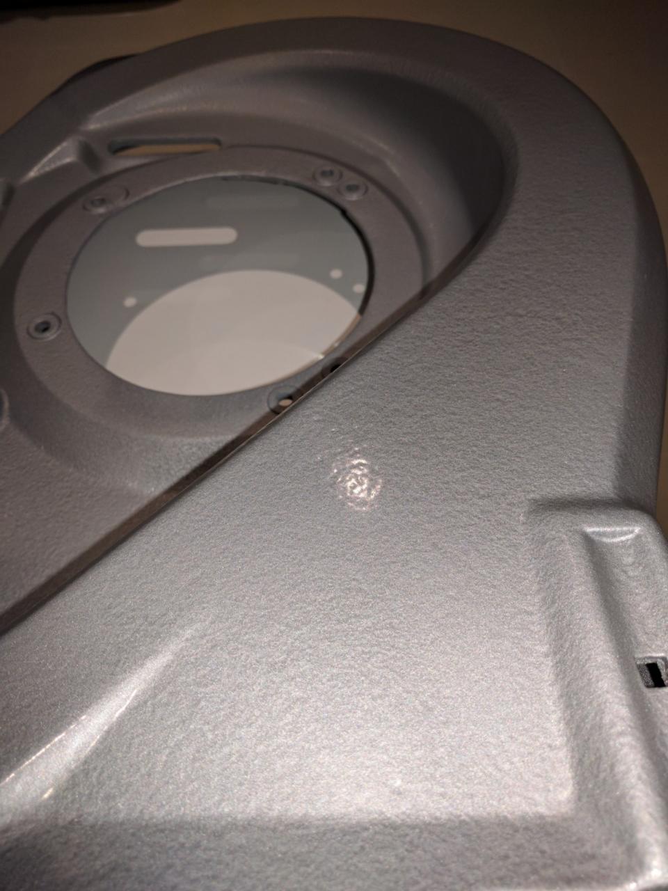

I tried your technique and it produced the best results yet! Here is a pic.
It looks more hammered than it feels. I'll have to wait and see if it has flattened out by the morning.
I'm going to try a few more tests so I'll let you know how it goes.
GT
That looks absolutely fabulous, It's not really meant to be a rough finish, just looks like it to optically cover up the imperfections in the steel underneath, that's why it was always used on machinery with castings involved.
