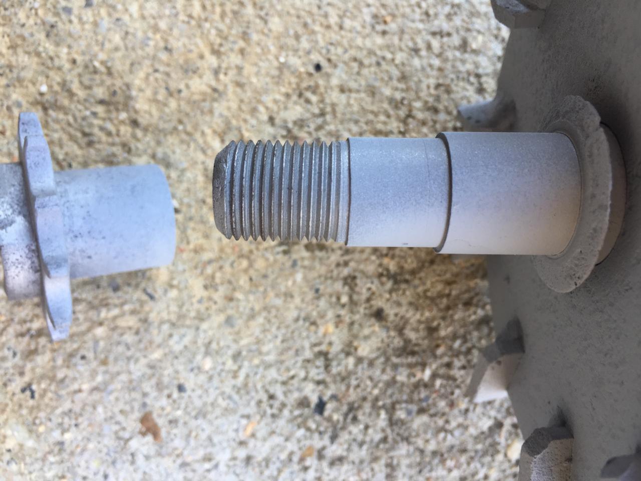

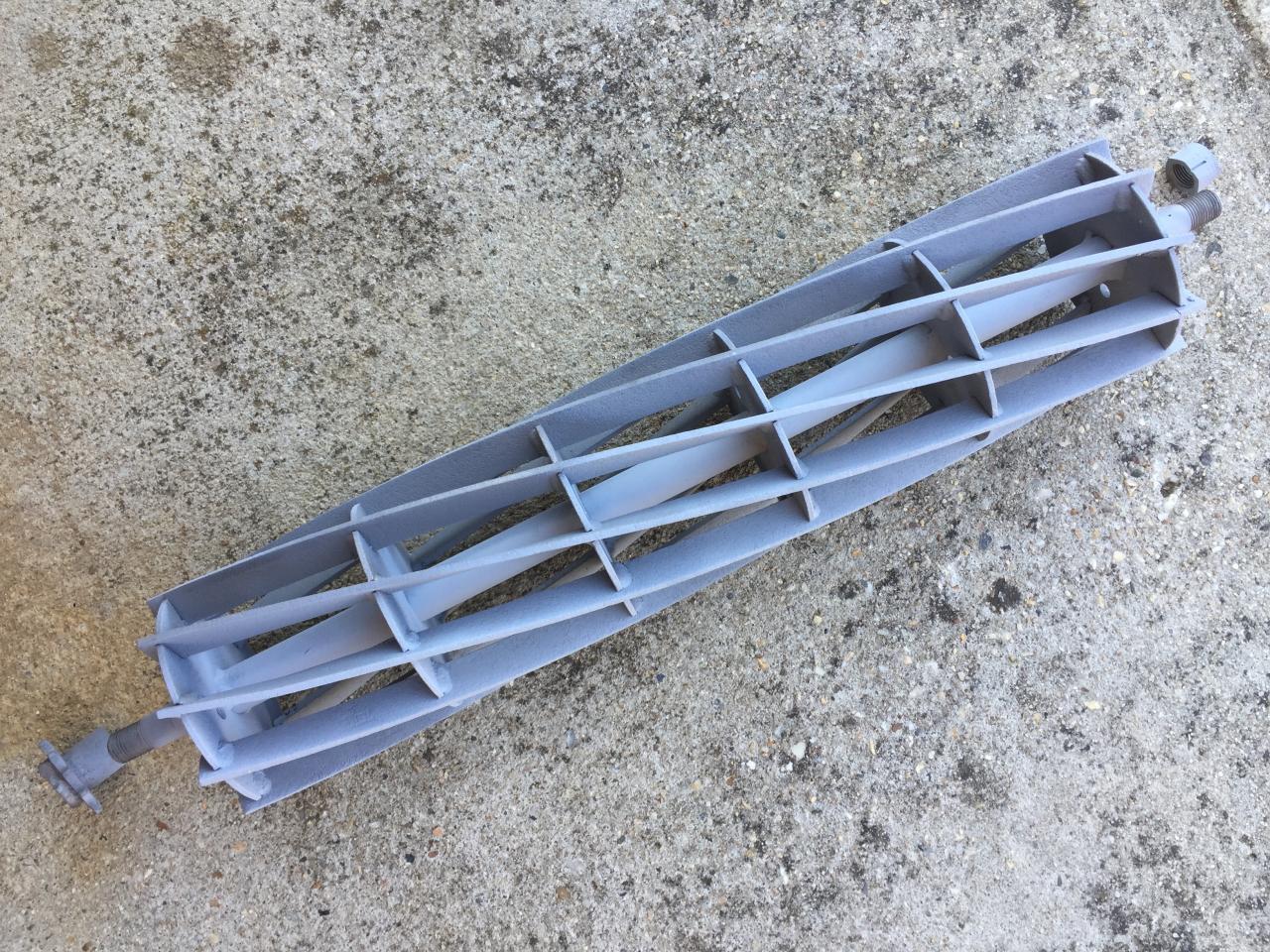

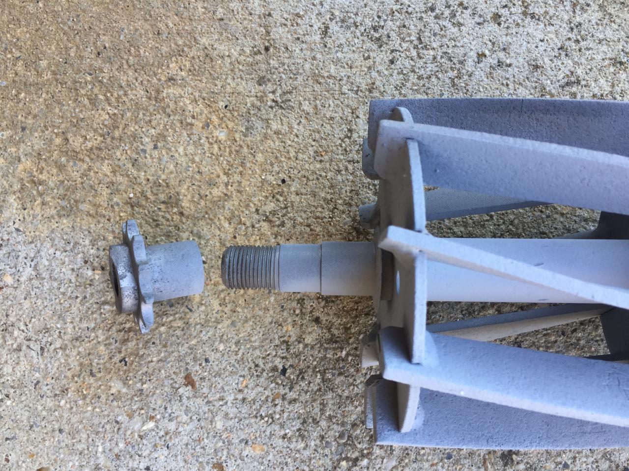

The reel gave me trouble. After some advice, It turn out the ends were left hand thread. I found an interesting imprint on the reel. An elephant with the word NONPAREIL. From what I can find, Wiliam Tyzack, Sons and Turner were a business making saws in Sheffield from 1879 - 1974.
You will also notice I have lost a tooth. Any spare in the world, it would be appreciated.

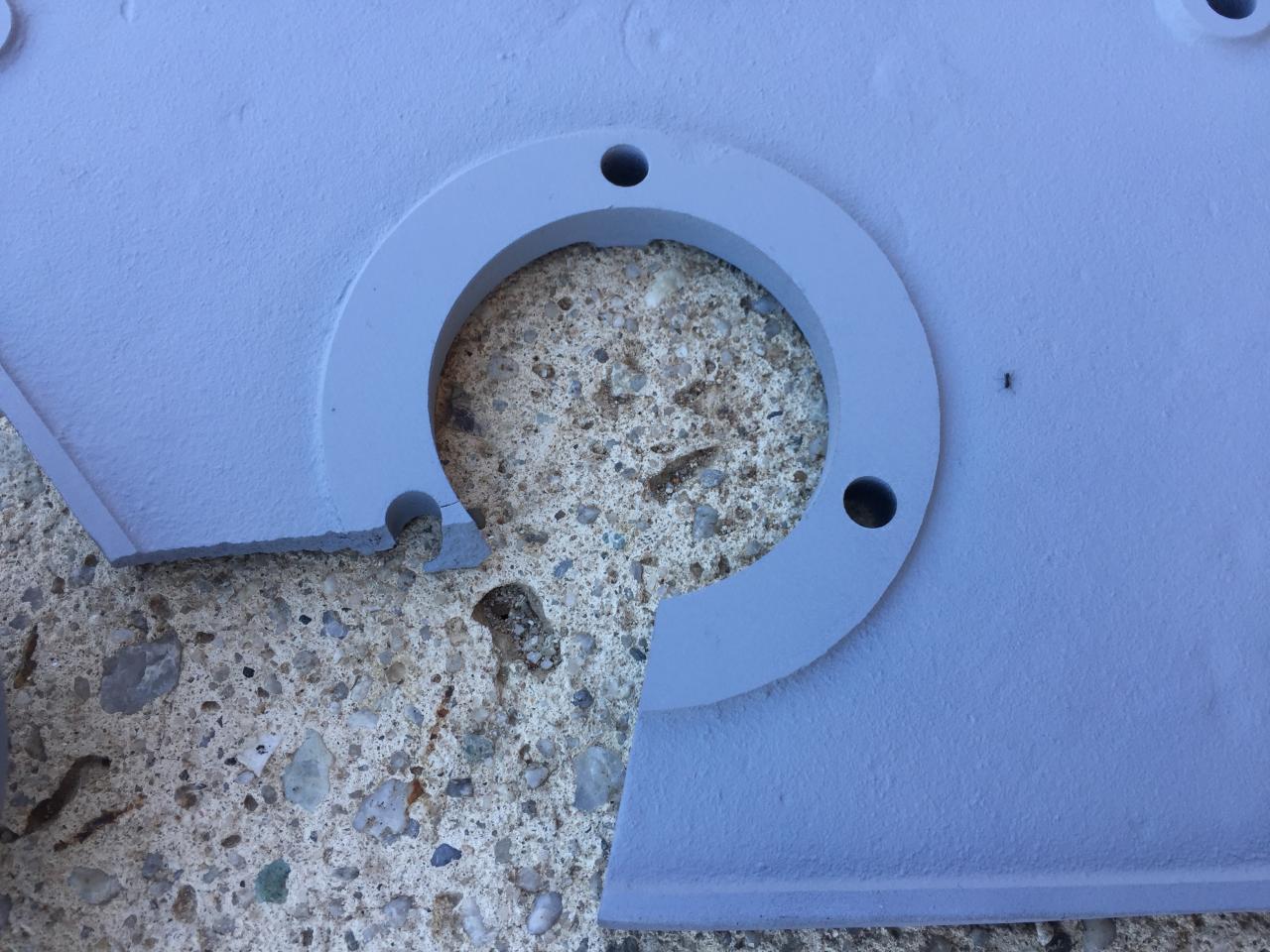

Items, which I'm not happy about, are as follows:
The brass Rear Drum clutch lever guide.
The right hand frame. Part of the frame has disappeared, which supports the rear drum bearing carrier.

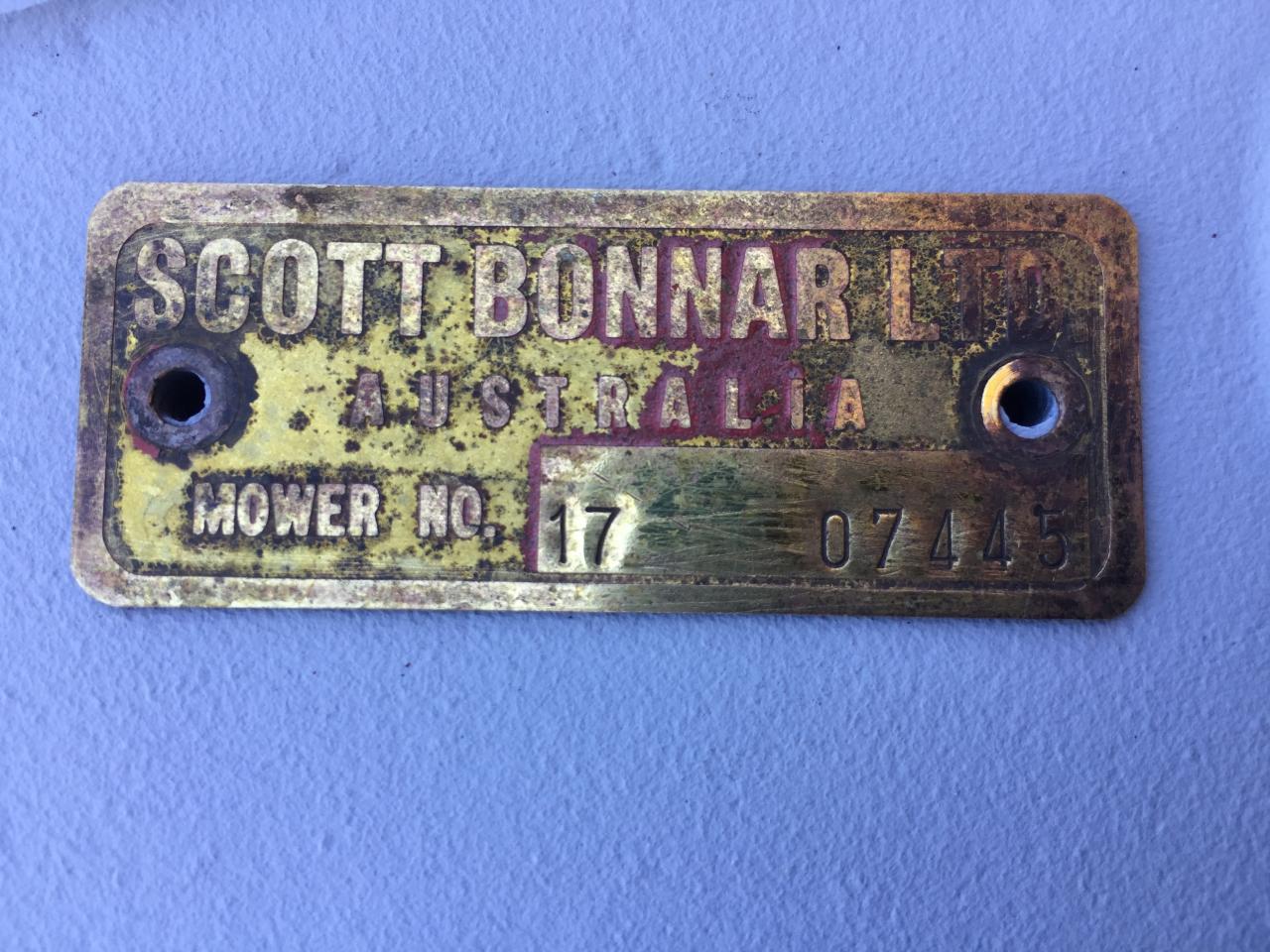

This mower's serial model number is 07445

Missing tooth, broken Chassis side and a lever guide that's been mucked around with as it shouldn't have that "V" cut into it.
The only way you are going to secure parts for your machine is at the death of another machine, yes this is most certainly a sad situation but rest assured there are still quite a large number of "Supercuts" out there rotting away quietly in old sheds just waiting to be found. It's probably even better if you found a harshly neglected machine that's been left out in the weather and is good for nothing more than being an organ donor to your machine. That's what I did for mine. $50 and endless parts for my good one. There are absolutely no new components available what so ever.

Changing the subject to your reel, it's almost finished with no meat left on the blades to machine, also I note that this one has the anti-clockwise engine on it as the norm for petrol powered Model 17's is that they have the Villiers with a chain drive on it and not a single V belt set up on them. Even the electrics used a Dual V Belt drive set up, so this leaves me to believe that someone has changed a few bits and pieces on it, but I may be wrong as Model 17's were one of the most adaptable machines and were made in so many different configurations to comply with the purchasers requirements. As far as we know there were about 32 variants of the Supercut. The mind boggles doesn't it ?

Hello Drew,
Great timing! (For me at least) You may have noticed from recent posts that I have just commenced a restoration of an Electric Supercut.
This weekend is one that I do not have to go to work so was planning to spend time in the top shed pulling the bearings off the reel Is this (or should I say, are these) what you refer to as being LH thread? I have hesitated to commence pulling at them as I don't want to cause unnecessary damage.
Thanks - great work by the way, I can appreciate the time and effort that you have put in thus far.
John
Joined: Sep 2015
Posts: 24
Hi John,
The reel is left hand thread. Sprocket at one end and a nut at the other.
The reel is reversible.

Below is what I call the Reel Drum, which drives the chain, which drives the reel.
I assumed since the reel was left hand thread, the Reel Drum would be the same. It is not. I can't remember my rules about driven and driver frown.

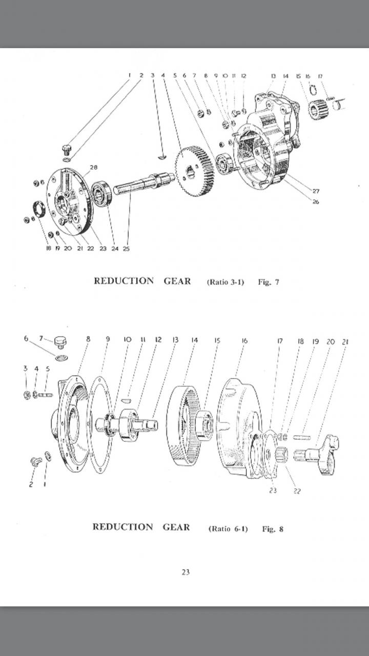

1707445 is not listed in the archives but 1707448 is. Mine is 20" Villiers 412 H/2RG Eng with 10 Blade Cutter. Not sure about the Low Cut Blade?
I was initially baffled by the mounting of the engine 180 degrees different opposed to the 45s. I wanted to replace the engine with something more modern but the anti clockwise direction is a problem. When I was pulling it apart to see why it was not a goer, I noticed the reduction gearbox and hence the reverse direction. There is no idler. Mine is Fig 7. Why Scott Bonnar did this, I can only guess. Maybe shifting the drive closer the the right hand side evened up the load on the two outer bearing?
Would you have a spare reel with more meat?

The Model 17 was basically a commercial grade machine and not designed for domestic use, thus why so many different variants were made for so many different applications.
Both my two machines are both powered by the exact same engine as yours is but without the reduction drive attached thus I have a standard clockwise engine output opposed to your anti-clockwise. Also my 412 Villiers are mounted the opposite way to yours.

Depending on how much needs to be machined off your reel you might be lucky enough for just a light lick that needs to be machined so as to salvage the reel for another round so to speak. Honestly there will be quite a few more Supercuts that will surface for sale in the next 12 months and you won't have to pay any obscene amount of money to secure one, thus this will give you far more options in your rebuild.
