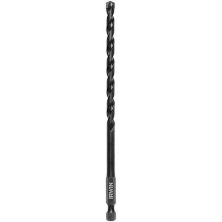

Probably a grade 8 (10.9 metric). Find yourself a carbide tip drill bit. Here we have masonry bits with carbide tips that will work. I have to use them on broken muffler bolts. I had only one to fail due poor bonding.
One comment about HSS bits there are different grades and many home improvement stores sell the el cheapo grade versions. I buy mine from my nut, bolt and screw distributor. Those home improvement ones I brought would not even cut a fraction of an inch and now the ones I am using will an inch or so into grade 5 several times before dulling. Also don't over speed the bits as they will lose their hardness due to over heating.

Masonry drill bits will drill it out easily, but not in their current form, you have to sharpen them like a normal drill bit and you need a diamond grinding wheel to do this

NormK, I would need to differ with on this as I have used them to even drill out broken extractors without modification which are way harder. Unless your bits in Your area are made differently.

AVB, you could be right, but I have found they do a great job if they are sharpened, they can drill through hardened steel like mower blades etc with ease
