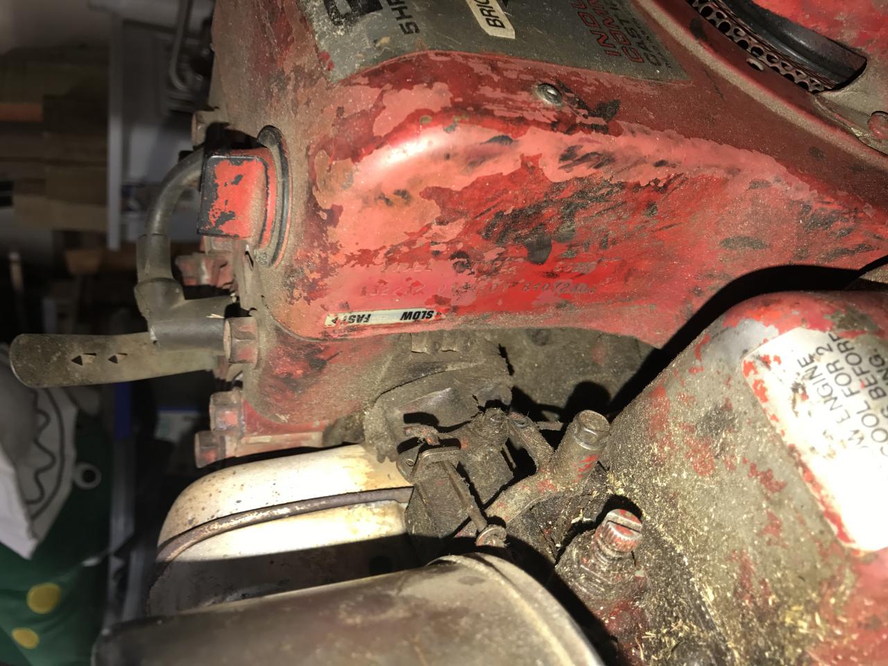

Any help available with the throttle setup team?

Hello Scott
This appears to have a replacement 5hp 13 Series.
The dial control is unusual but of Briggs make. If its not working, you could simply put a throttle cable and control on the handle.
Model, type and code would be needed for parts list and operator manual.
Hope this helps. ------------------------ Jack

Hi CyberJack
The dial you see in the pictures is the on/off switch. Based on the way the cowling is pressed out it is almost certainly a factory fitted item.
A throttle cable is connected and functions ok.
My reasoning for thinking something isn't right is based on: The fast / slow sticker on the side of the cowling with nothing else present. I have seen pictures of Briggs engines with this sticker and there seems to be a speed adjustment knob on a long rod in that area, assume it's for idle adjustment.
The choke linkages that seem to be doing nothing. I have another 3hp Briggs with similar choke linkages and it pulls the choke on automatically at a certain throttle position.
The model number is 132232 0144-01 84072307
Appreciate your help.

G'day Scott
I see... Of course, that's a Briggs on/off switch. [I see that now.]
The answer must be in the Model, type and Code. I'm guessing as you predict.
The original rod, though, probably controlled the full range- idle, fast and choke. Maybe ...
Hopefully, we may get some clarification.
All very interesting. ------------------------------ Jack

Hello all,
The choke linkage goes through the arm on the right of the picture but that's it, there is no physical link between the throttle and the choke. Reading the above instructions it says "move the speed adjusting lever to the choke position" which describes the way the auto choke works on my 3hp Briggs. Convinced something is missing.

Hello ScottI agree, the parts list is not so helpful in identifying what the 0144-01 type actually had. It is clearly not the standard spec because of its specific mention in the parts list. Remember, this is a replacement engine, and one designed for stationary application. I believe it would have had separate choking - and not from the 'Fast-Slow' rod control. For mobile lawnmowers, a remote, manual throttle is desirable. I think you will get auto-choke if you add a cable and control. I see no point in restoring the original stationary screw-knob control. Hope this helps.-------------------------- Jack
