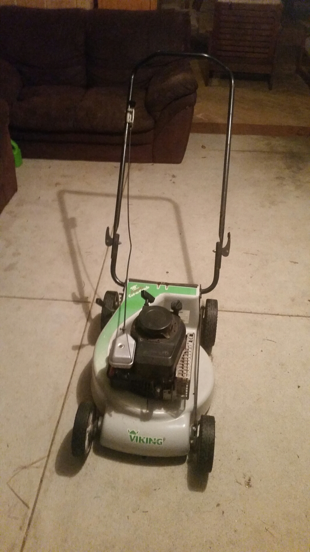

Hi guys
Have a 2nd hand mower been using for a month or two. Starts and runs well but has no real throttle control. Checked the air filter and going to replace that and while it was off checked and the throttle linkage seems a bit off, one of the springs is badly stretched and bent.
Basically it will start fine but has no real throttle control between start and stop, which also works. Just always running at pretty high throttle.
Have no other complaints at this stage, is this worth fixing while getting other parts ?
BTW - Is the engine code under the covers ? Got this on a sticker on the engine tbs158u1g1, seems to be a Classic or Sprint late 90s. I believe air filter for it is 698369 if that helps ?

Any Pics? will help to see it.

Joined: Nov 2016
Posts: 9

True. If it ain't broke and all that. More just need a few little bits and pieces so was doing a small list and considering whether or not to 'fix' this.

Sure.
There she is.
Engine is 10A902-2135 E1-98060455
Posts: 961
Yep, it's a 10 cubic inch 158cc Briggs and Stratton Quattro 40.
Firstly, remove the cowl and clean all the grass etc under there, sometimes it impedes the governor function. After you've done that start her up and adjust the governor setting by bending the tabs, where the springs are anchored to, in or out to increase/decrease engine speed. The large spring controls high speed RPM while the small spring generally controls the idle speed.
Don't worry too much about the mangled larger spring, you can cut those coils off and and bend out a new coil to anchor to the bendable tab.
Let us know how you go.
Cheers, Ted
Posts: 8,215
Good little motor,and as bigted says , bit fidley to get the springs to work properly but it will work
Cheers, Ted
Are you Nostradamus ? smile
Yeah quite a bit of clippings underneath.
Have had a play and can see how it works, without that big spring working there is very little effect of throttle lever movement on the plastic throttle thing whatsit on the carby.
Other than that seems all good. Will get a few bits and pieces and sort this. Bloody new Echo has an issue with the starter cord and so am currently trying to sort that.
Thanks guys. Wouldn't have thought Brigs would've been in China in the 90s ?
