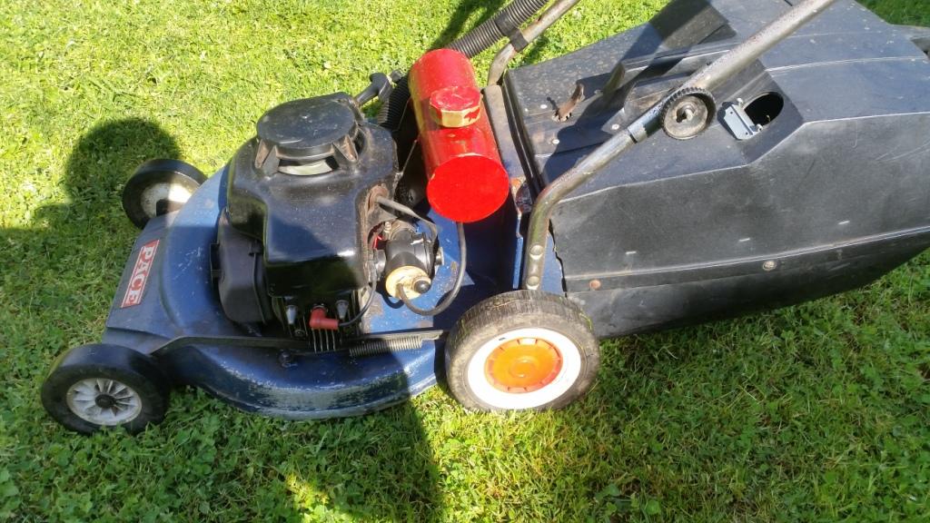

Gidday all,
Happy to report that with invaluable assistance from Norm K, we managed to crack the code on these mongrel Victa plastic fantastic carbies and I now have a sweet running machine that idles beautifully at around 600 -750 rpm and runs evenly out to full speed 3,500 rpm over the full throttle movement and can be set to run at any speed between idle and max.
There is no doubt in my mind that the Obsolescence Engineers at Victa played a big part in making the engine run at max speed 3,500 rpm so that it would unnecessarily wear out. Its is also abundantly clear to me that Victa had problems with this plastic carby from day one otherwise there would not have been four (4) different versions of bodies, cams, lifters, lids, lower spring, upper spring and diaphragms. Each item had the same main part number but there as a small suffix labelled 1,2, 3 or 4 moulded just above the main part number. Further, all the parts are interchangeable but the differences are incredibly subtle. I think that there is a big problem with spare parts as only the latest part is available and that putting the part into a carby that was not specifically designed for it causes the issues that I've encountered. The obvious solution to rectifying a bad carby is therefore to purchase an entire new one but at $160, its a complete and total rip-off.
Just to re-visit my problems:
1. The engine smoked badly on start
2. The engine would either rev its balls out at idle or stall at zero rpm depending upon the parts mix.
3. There was no throttle control - it was full speed or no speed.
4. The throttle lever was sticky and jerky and regularly jammed.
Smoking issue was fixed by changing the needle to stop flooding. Several needles were needed in the trial and error procedure. And yes, I was careful to ensure that the pointy end was positioned against the seat and that there were no issues with the float. It was simply a fact that the manufacturing tolerances were high variable and factory QA none existent and this very important mass produced item.
I finished up purchasing two new springs to ensure that I had a matched pair and it was impossible to know from the assortment that I had which were the correct ones as all colour markings had vanished.
Norm K in a fit of sheer brilliance decided that we should reshape the cam angle, remove all sharp edges that were causing the lifter to bind - See photo. The reshaped cam made all the difference and enabled full smooth throttle control so that the engine could be easily set to run anywhere between 750 rpm and 3,500 rpm.
We found that a poppette height variation at idle of only 0.004 inches would change idle speed by 1,500 rpm. We initially tried to make final idle adjustment using shim washers (7 mm dia) under the cam (as per Victa information sheet) but did not adequately give us the idle we wanted. In desperation, we fitted an old cap - the one that used a knurled knob for idle speed adjustment and it proved to be a godsend (see photo). The spigot contacts the top of the poppette and allows "micrometer" adjustment of the seat appature at idle and gave us the means to set idle at 600 - 750 rpm .... the engine ran smoothly and quietly at this slow idle speed and we at a loss to understand why Victa discontinued the carby lid design that had the facility to adjust idle speed???
Anyway, job done , grass has been mowed and the mower has been successfully started and run from cold a total of 6- times to ensure that our mods worked. Starts first time runs beautifully at any selected speed
..... Thx Norm K - brilliant idea to reshape the cam and great execution!.... Photos attached - I hope that they come out.

PS:
1. That's Norm K in the above photo.
2. I manufactured the red steel fuel drum (gusseted to the steel cowl)because plastic fantastic original fuel tank split at the seams.
3. What a great result on Saturday - Go Doggies! Incidently, same day as I got the mower going properly after 6 -months of stuffing around - I had a premonition that the Dogs were gunna murder those Swanny wooses from Sydney!
