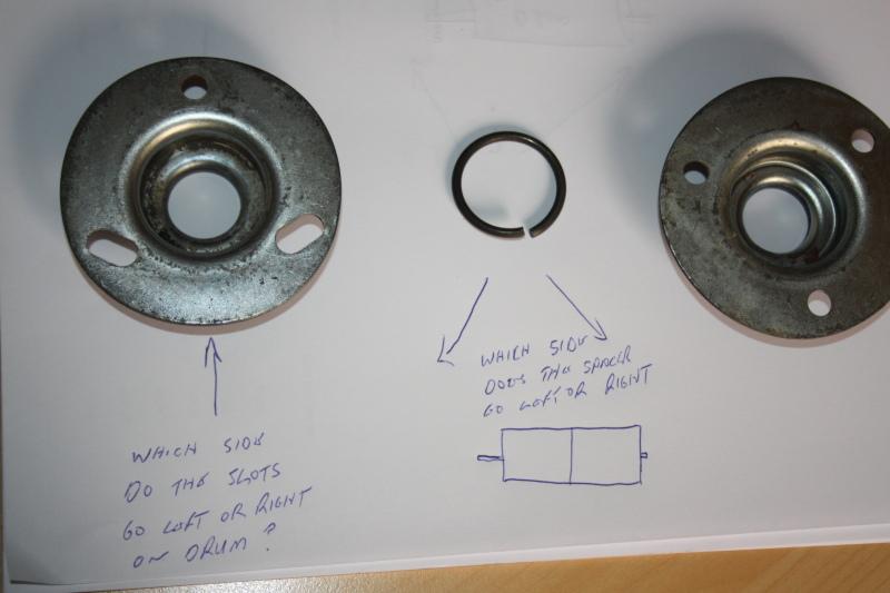

I have attached a picture, can anyone tell me where the slotted bearing carrier goes ? to the sprocket side or not and also the spacer to the sprocket side or not ?
Ken.

The spacer (13) belongs on the LH side in a position described below.
The slotted bearing housing (15)must be positioned on the RH side but in the
correct position. The non-slotted hole faces the front of the mower, the
slotted holes at the rear.
Explanation:
The Model 45, as a residential mower, was still not quite a 'professional' machine.
The LH side bearing housing is not slotted so as to set a datum set-point -
meaning that the rear roller and bottom block (soleplate and bedknife) had a set
'angle of attack' for grass cutting.
The slotted RH bearing housing was designed to move the roller assembly up and
down
, so that there could be perfect alignment between the roller and bottom
block to match the set LH side. I hope that makes sense.
Failure to do this may result in the noticeable cutting of the grass lower
on one side. Some folk have tried to correct this by re-aligning the front
roller. This should not be done before checking the rear roller alignment.
This is not complicated, but a procedure should be followed.
To align the rear roller a simple alignment straight-bar may be needed,
or any method to measure and align the LH and RH relationship between the
bottom block and the rear roller. This is the start point.

Hi Ken W and Mod CJ,
As I'm somewhat incapacitated at this present moment and am finding it near on impossible to sit in one position for any length of time I will delay what I feel what needs to be done and that is write a full procedure for the alignment of the rear drive drum (roller) and then the front roller.
This needs to be done as it is not really covered in the "Outdoorking Disassembly / Assembly videos" which were done quite some time ago now and as such it has been raised a number of times due to the two different bearing cups and the spacer ring that fits onto the roller axle shaft.

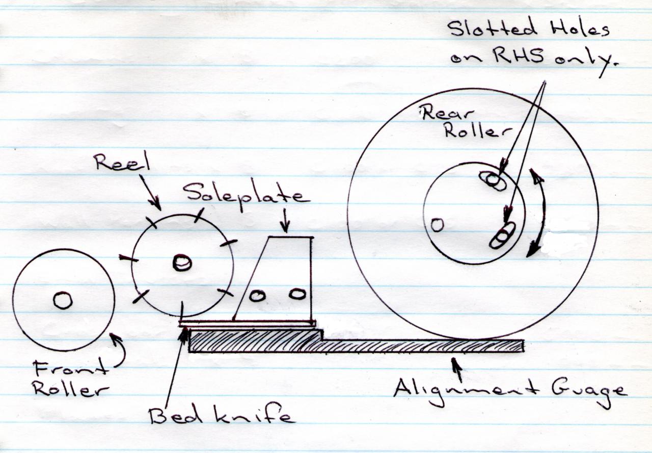

Firstly I've put an image up that I've drawn of the major components of a Model 45.
REAR ROLLER POSITIONING & ALIGNMENT
Now the first thing that has to be done is to install the sole plate complete with a new bed knife attached. Place in situ and install all the 4 bolts in through the sole plate and out through the side plate, thus the nuts are on the outside. Make sure that all the bolts and holes are free of grime etc. so that the sole plate will sit correctly within the chassis without any interference from any foreign matter. Now tighten the 4 nuts and bolts diagonally until all are tight.
Next ensure that you have the NON slotted bearing cap on the left hand side of the rear roller with the spacer ring installed between the cap and bearing. The slotted cap fits onto the right hand side and has no spacer ring. Slotted / elongated holes, same thing.
****PLEASE ENSURE YOU ARE USING NEW ROLLER BEARINGS !
Now install the bolts through the left side bearing cap and out through the side plate, next wind on the nuts and spring washers and tighten them, the LHS cap can be rotated at any part of 360 degrees as the holes are all equi-spaced. Make sure that the RHS of the roller is supported and that you don't just have the weight of the roller stressing the LHS mounting components.
Ensure that the Right Hand bearing cap has the perfectly round hole facing towards the front of the machine and the slotted / elongated holes towards the rear. These slots / elongation provide the adjustment for leveling the rear roller up and down within the chassis and line up with the bed knife. Now tighten up the LEFT SIDE nuts ONLY
If you look at the diagram that I've drawn you'll see that there is an alignment tool showing that must sit flush with the bed knife and also the bottom of the rear roller.
There is a generic alignment tool commercially available, but as you will probably only have to do this job once or twice in your life you can easily make this tool up out of a narrow piece of solid timber. Make it up as per the diagram using the left hand side of the mower and ensure that it sits perfectly flush across the bed knife and then just touches the most lower point of the roller.
BTW this has to be done with the mower lifted up off the ground by using two milk crates etc.underneath each side plate. Ensure you have extra weight on the outer side of the milk crates to counter act the force being placed on the crates on the inner edges by the mower.
Once you have made this tool and are happy with its fitting on the left hand side, all you have to do is slide it across to the Right Hand side of the machine and lift the RH side of the rear roller so that you replicate on your gauge the same flushness as it appears on the left side. Do up the front nut on the RH cap lightly (this bolt is used as the pivot point) so that you can do the lifting and lowering. Once you are happy all you have to do is tighten all three nuts securely and you can consider your rear roller as correctly aligned.

Hi,
Thanks for the information Jack.
I had the spacer on the wrong side and the Slotted bearing holder also on the wrong side, but now have corrected it.
I have four 45s to rebuild, a friend gave me the mowers all in a pile off bits so its sort of fly by the pants stuff. The diagrams sure help, again thanks for all the info
Cheers Ken
