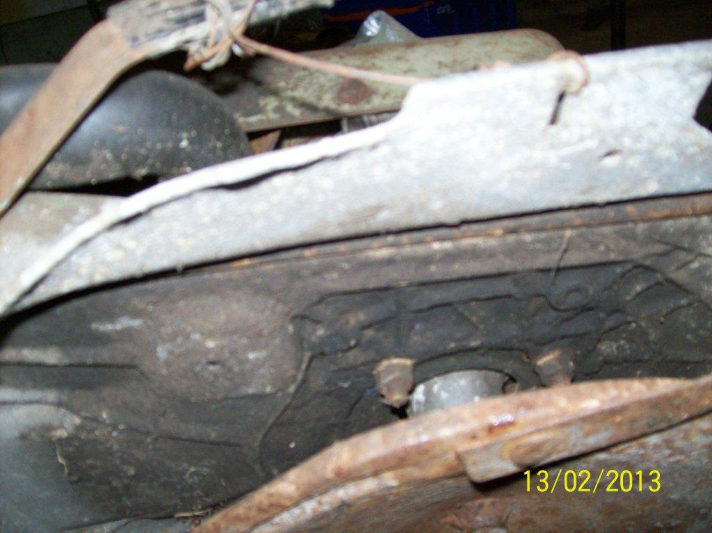

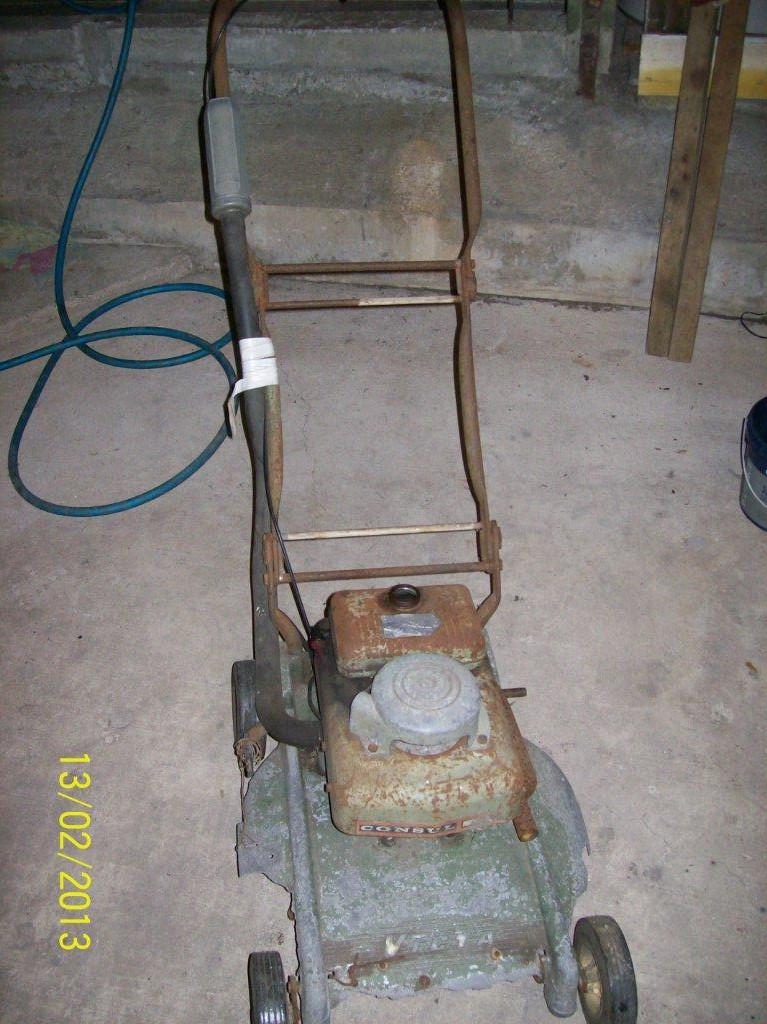

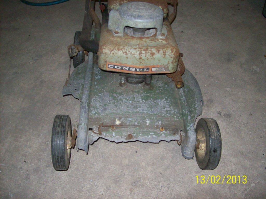

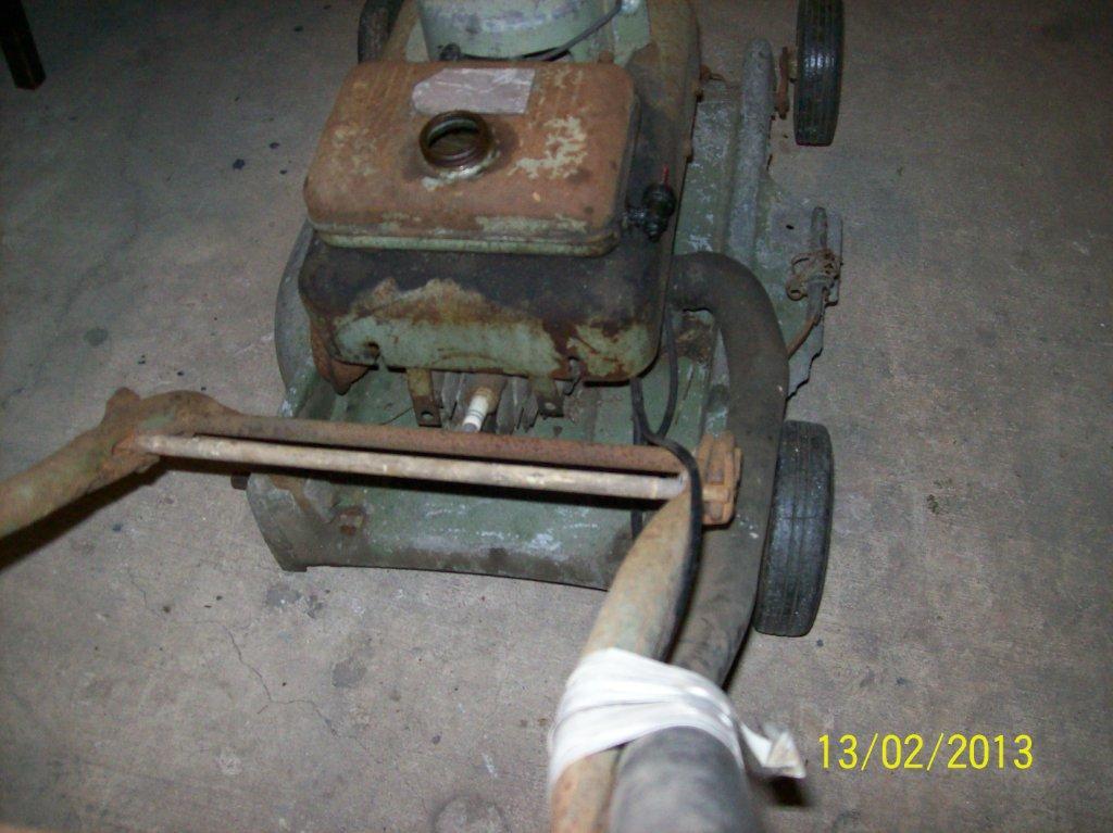

Yes!! Yes!! Yes!! I finally flippen got one!! That's right a 1963-64 Consul 2 Model 511.So far this has proven to be a very hard model to find(yes I know there are harder to find ones. I'm still looking for those)but hard enough non the less.She isn't in great shape but certainly fixable.The base is cactus but I have a better one that will be much easier to fix.Here have a look.
See the base looks like a train wreck for sure.
Looks like an aluminium eating mouse has been chewing on it,and yes I've seen and herd about aluminium eating mice too.
I haven't checked the engine number yet but from what I can see there (pictured) I can see a 63 so at least it could be the right year.
She is rough but at least it has the right handles and there is enough for me to restore this beauty.
Whooo I'm happy about this one.It don't look much now but she will when done.

Are these like a utility base? Cause im getting one that looks very similar. But its in really good condition been in a shed covered for sometime lol. I will have to see if its same as this one.
No not the same as a utility they took the same base as a model 6 Sherrline or cadet. Infact there was only small differences between the 3 models. Things like cowls and handle bars and with the cadet a different air cleaner.

Good Find, You have another base though so Restoration will be easier.... I would have to say though, If I had seen that mower at a tip I would have probably called it a write off, But to the trained eye This mower will be a good one.
Also, I have heard of aluminum eating mice also, But then again.. mice eat weird things, I have seen Mouse chew'd gas lines more times then I care to count.

congrats smile the engine looks a good specimen ! least you should have enough parts to make a gud one .
do you need an air cleaner housing as ive got a few if need be.
im about to have the stickers reproduced for mine , do you want me to get a set for you also?

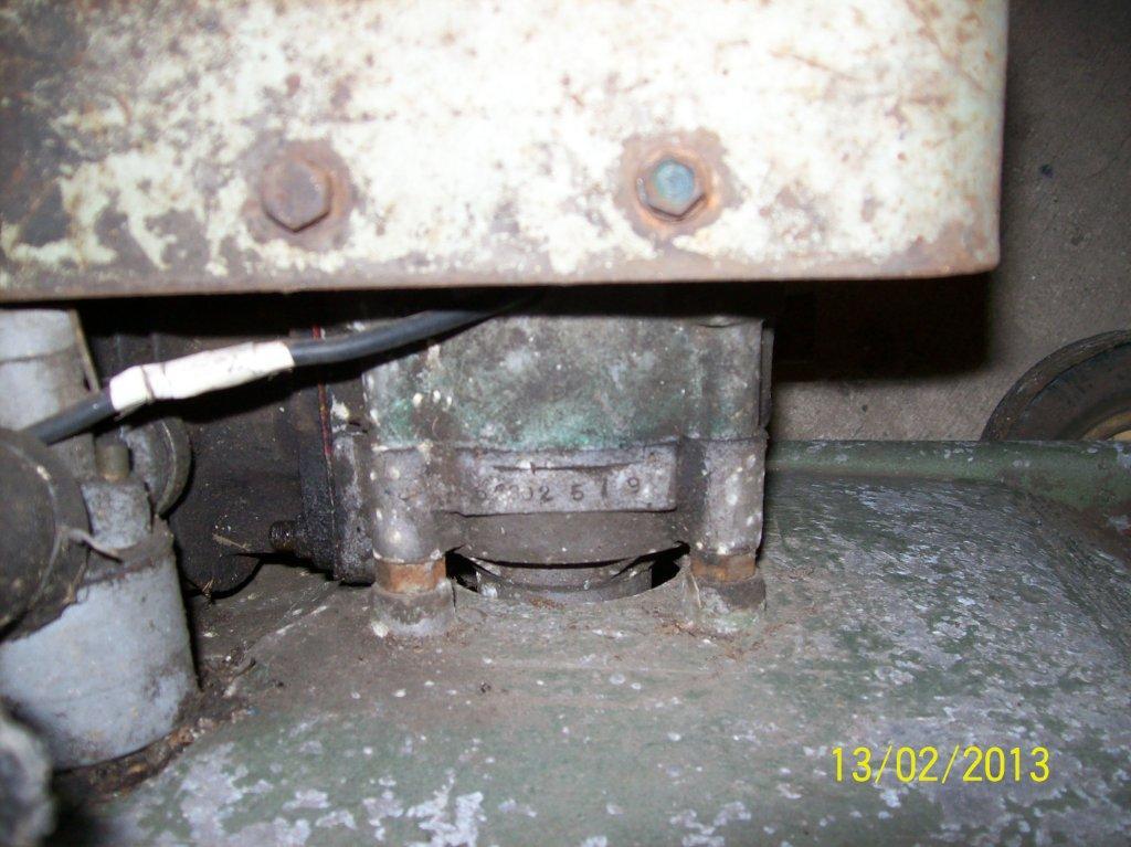

Tomo yes yes and yes.I would,I think I have the front air filter box spare but for memory it was a bit buggered.As I had to replace one that was on my Cortina 2 and I'm fairly sure now (as I keep typing) that I put it on that one.It had rusted in the wrong spots.I think I still have it but I think it really is only good in the scrap pile.I'll have a look on the weekend but I'm not sure if it is any good.I think I only kept it as it was the only spare one I had.I am a little worried about the engine as I can clearly see that somebody has played around with it and the top part of the crank case has been changed.Hence why it doesn't have the filter box on.No screw holes,so why would that have been needed to be changed.I guess I will find out soon enough.

looks like you may need the cylinder head aswell jeffrey as it looks to me like the spark plug is angled which would indicate that the engine its self is an early utility in a consuls dress.
Thanks guys but the shine from this find has now gone.After a close look at the engine number it's all wrong.It's not a consul 2 engine at all.In-fact without checking my records (which I haven't finished recording yet). I'd say it has a utility engine on it.The numbers start with 668.Which means it's a 1968 model.That's about 5 years newer than it should be.Bugger bum poop.Not sure what to do now.The closet spare engine I have is the newer consul 2 engine which also has the wrong year on it.I knew it was to good to be true.These [Censored] things are so hard to find and I only found half of one.Just a bit sad about it now. banghead cry

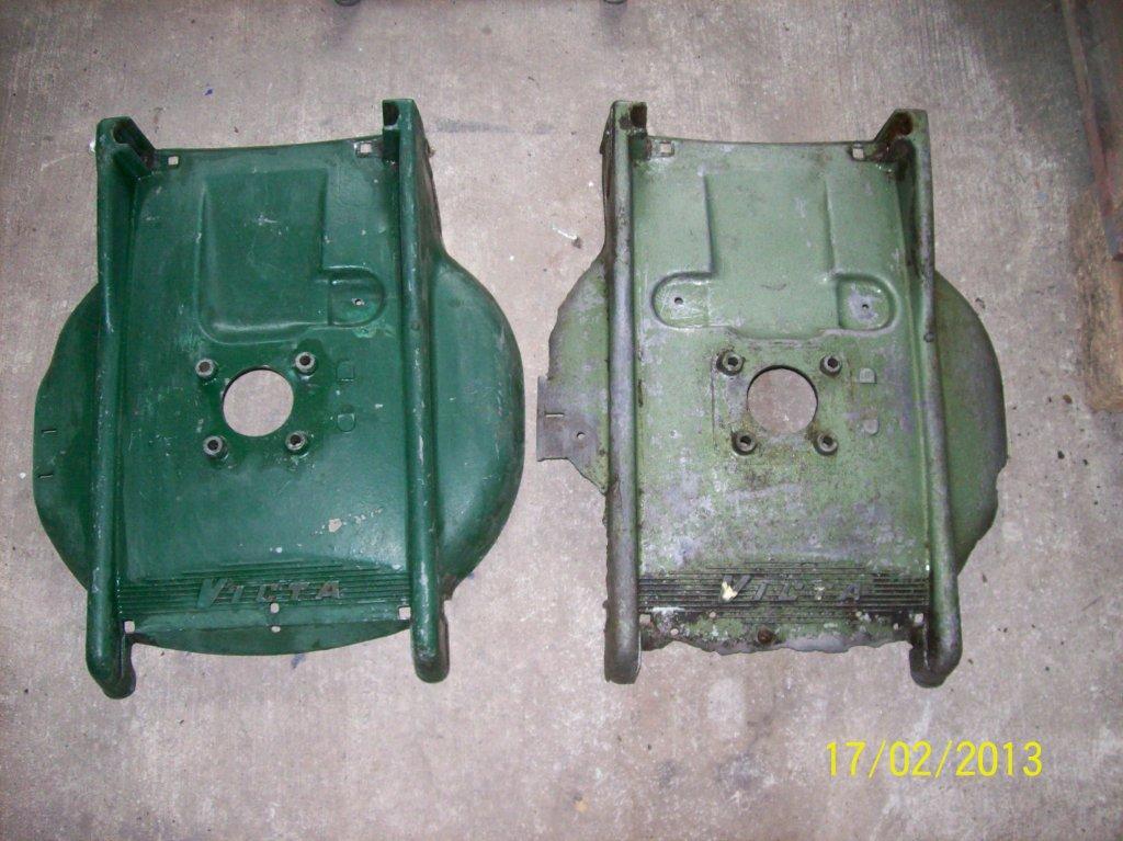

OK this d*m mower is starting to become a major pain in the poop chute.OK about the engine that is all good now.I had a look around in the mower room last night as I couldn't remember if I kept it.Then eureka I found it and yes I did keep it.Here is how I received it.

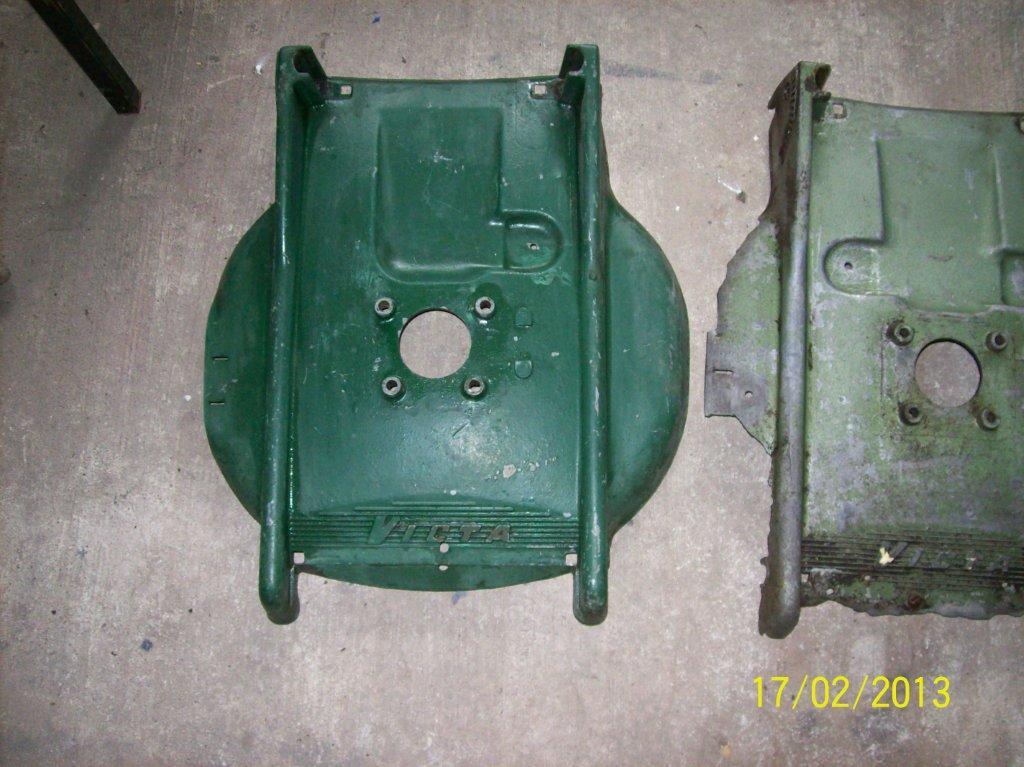

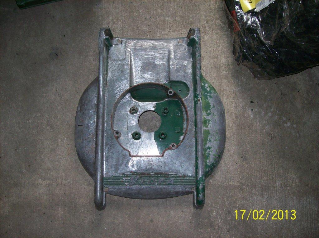

I had forgotten that I kept the engine.I knew I threw the base out as it was toast as well.Although if you start comparing bases this one pictured here is in much better shape.Then the really big problem came up and smacked me in the face,now this one I can't just dig around and find it.As I know I don't have one.The base I was going to use as the replacement base,a model 6 Sheerline,a model 9 Sheerline or (and most likely not to use)a model 7A four stroke.All in very usable and fixable condition.Only problem is they are all completely different bases from the Consul 2.Bugger bum poop.You see the Consul 2 unlike the others that use similar bases,has the carby on the opposite site.So therefore there has to be a dip in the base to allow this.You don't understand what I'm saying here I'll show you then.
So you can clearly see that where are two dips to allow for the carby to either side of the engine.I know I know I could put the carby on the other side,but that then is one very important feature of the Consul 2 gone.
This is the model 9 Sheerline base.Similar but with one dip.
The two together clearly showing the different's between the two.
This is the model 7A four stroke.
Now it would seem that these bases are totally unique to the Consul 2 range as the slightly newer Consul 2 Model 521 I have here,has this same base as well.Again to accommodate the carby on the opposite side.So now I need a Consul 2 base to keep this dream of restoring alive.Yeah right I know as much as the next guy even the 521 is a little more common but even that doesn't show up very often either. Oh well let the search being I guess.There really isn't a way of saving its original base.Would cost way to much if it could anyway.
